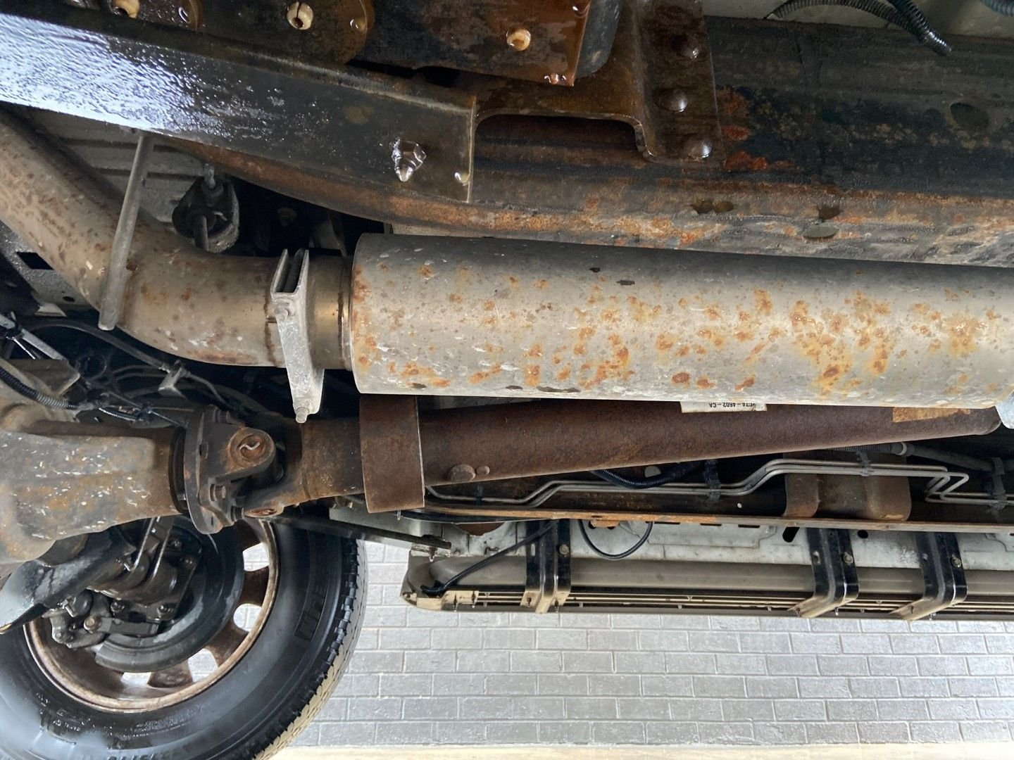

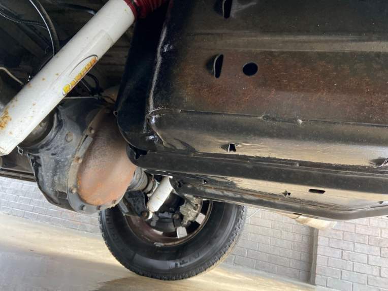

Hello, I have found a 7.3 with the color I want and year. The only thing bothering me is the rust on the undercarriage. Also, it has a tuner and I have no clue if that's alright for a 7.3. I've read having a chip/tuner for the 6.0 was not a good idea. Please if you guys can give any insight on the rust and let me know if I should pass on it. Thank you

That is nothing!

Really? I do not know much about rust, so I was worried when I saw the pictures.

That is minimal rust...looks like it went to the beach a couple times and didn't get rinsed.

So If I plan on owning the truck for a very long time, I don't have to worry about the structure of it?

Hard to say if that's a good price or not without knowing more about it. It looks like it needs new tires. Where I'm from that's a lot of rust but obviously nothing for those people that have to deal with that kind of thing. Make sure you check the rockers thoroughly and not just the frame.

Where is this rust of which you speak?

That is nothing!

That is just surface rust. All the bolts are good and that surface rust can simply be wire brushed, treated with anti oxidizer (acid) and painted. Seems to be in really good shape. On this one I would focus on mechanicals and perhaps the interior. A programmer on the 7.3 is generally not a problem and more likely just desirable.

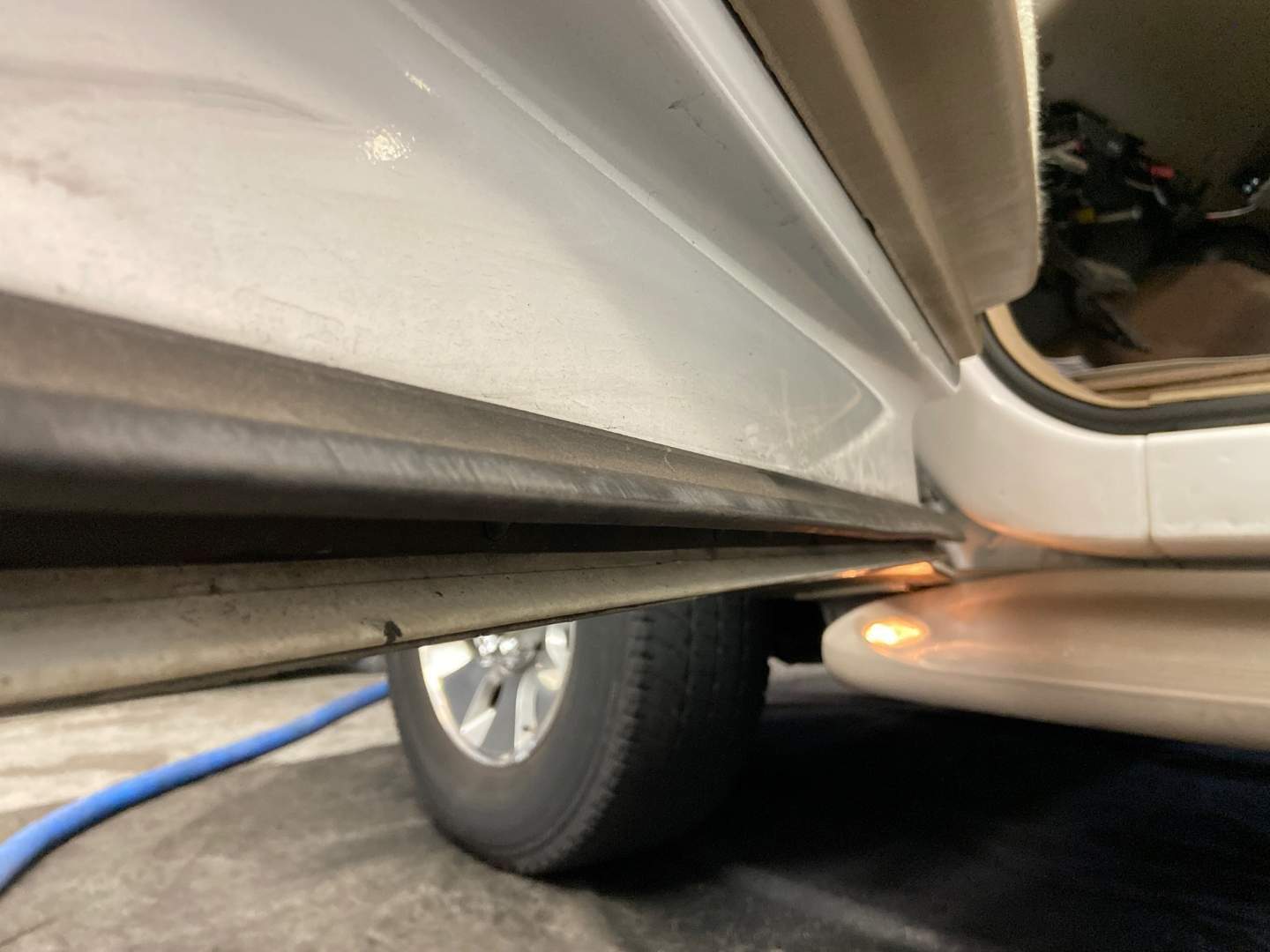

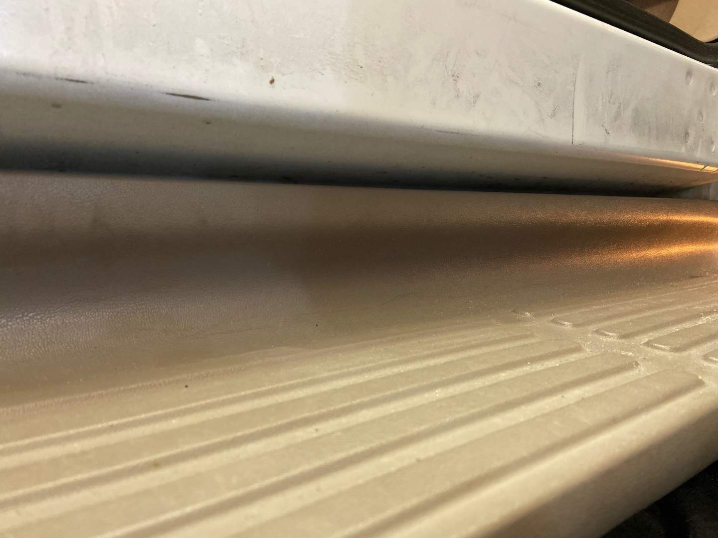

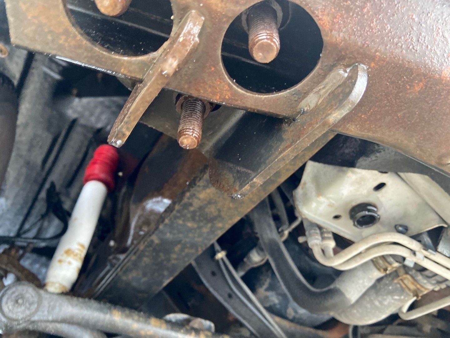

some more pictures I just received

That's considered "Rust Free" no matter where it's from.....!!!!!
