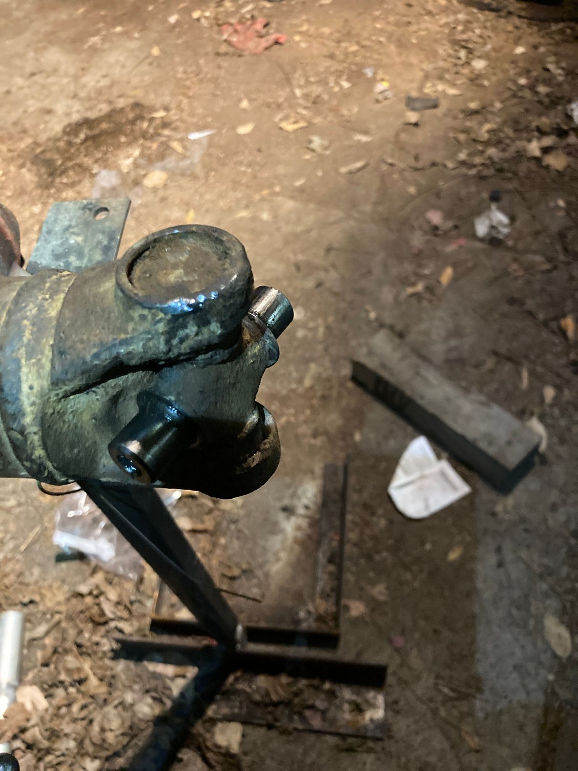

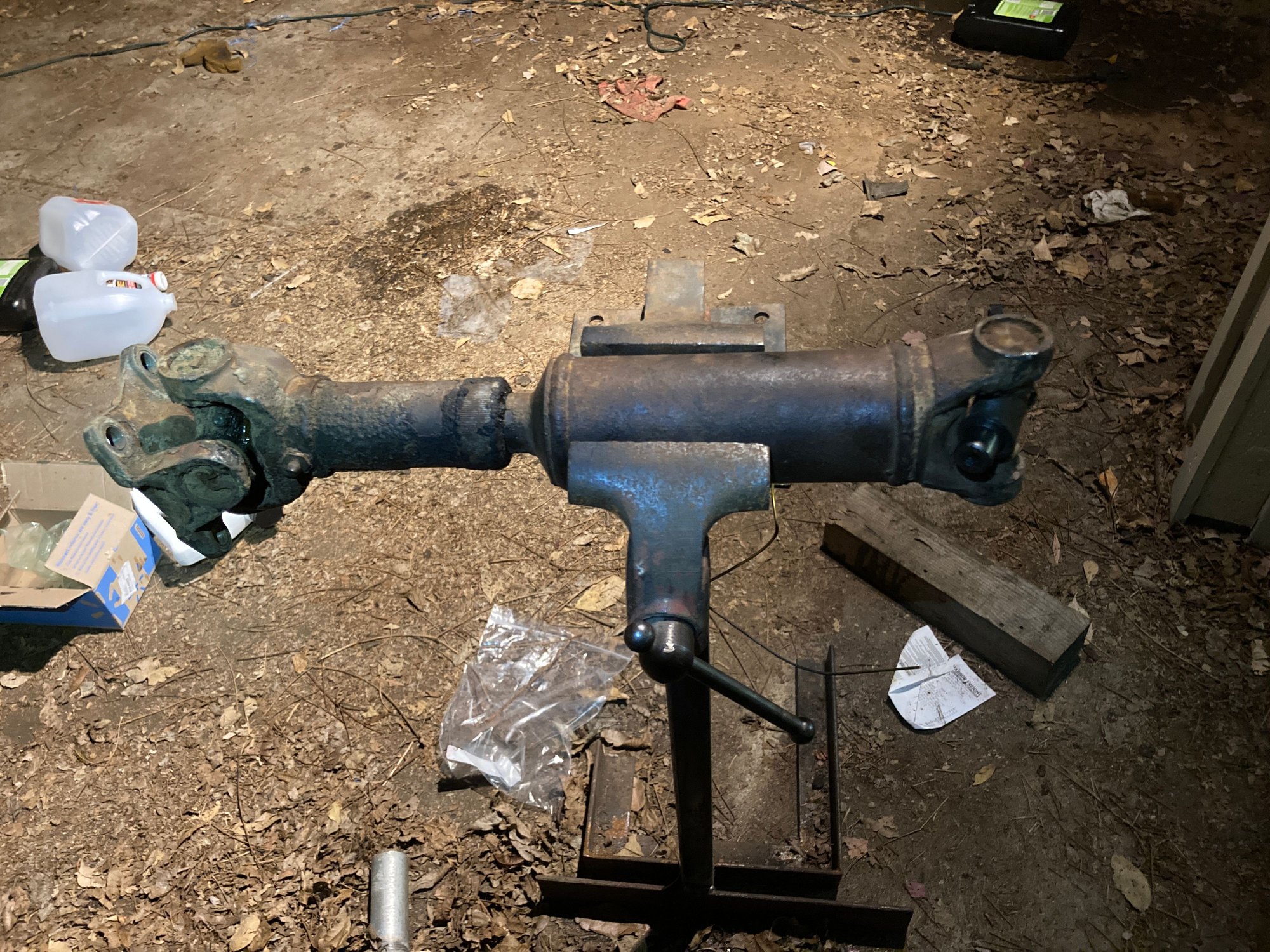

I finally got this truck started and drove it around the block. As i pulled into the driveway the driveshaft came out. I dont think i tightened it all the way. Is this the intermediate shaft when I order u joints? I have done u joints 20 years ago but do not remember how the come out of the yoke. Any ideas?

There s/b a snap ring on the top or the bottom of the caps that have to be removed. I can't quite tell from the pictures if it's on the bottom but I don't see it on the top like the other shaft end U joint is. Once the snap rings are off, you'll need to press it out in one direction to remove a cap, then press it in back in, and out the other side to remove the other cap. Assemble in reverse order.
Use should be able to use your vise and some sockets to press in the new one. Best not to hammer them in as it can damage them. After installed it should swivel freely, if it doesn't, tap it one way or the other and check it again. Good luck.

i found a shop to do it. They charged $50 which I thought was high, but it is done
