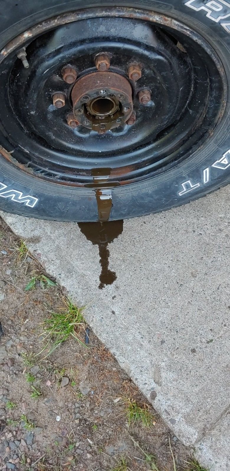

This is a 70s but I do believe the late late 80s, maybe early 90s only got disc if it was 1 ton... possibly.. maybe crews... memory isnt so certain. by early 2000s they all were I believeI believe finned covers came on them(the ones that may have rear calipers) they may do drum in hat but I am unsure the parking brake.
here was my fun modification
