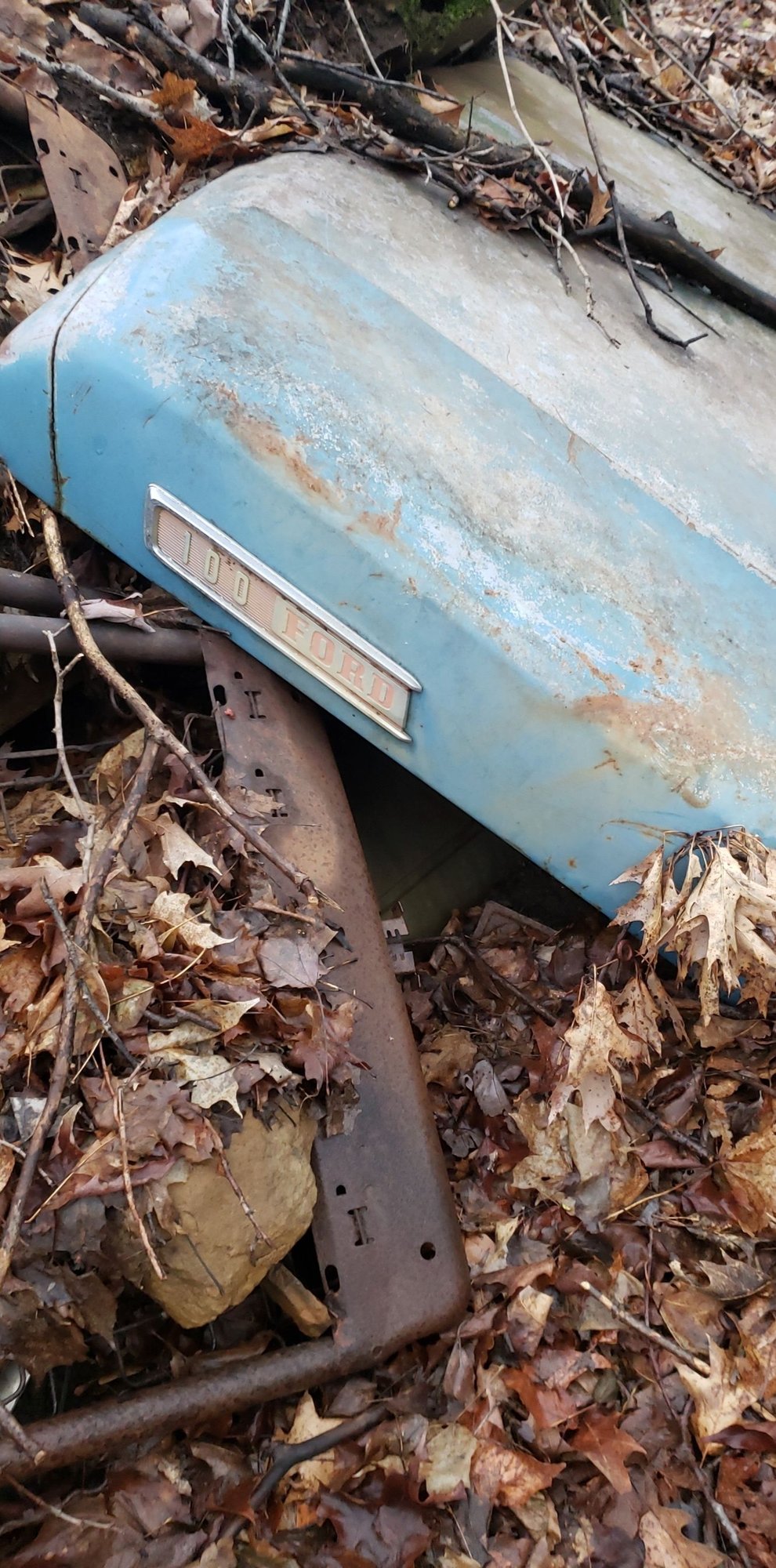

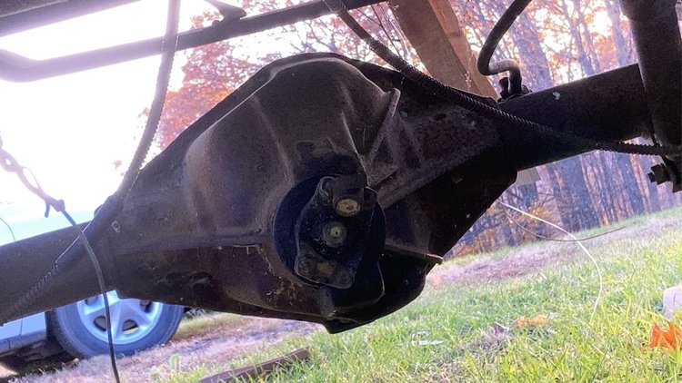

60s. I believe its a 68 or 69 I cant recall what the thread over on the 67-72 forum said it likely was
Not sure if this means much
Small brakes and hub, its semi float 5x5.5
Got nice spring set. its a trailer atm. Lol
other view

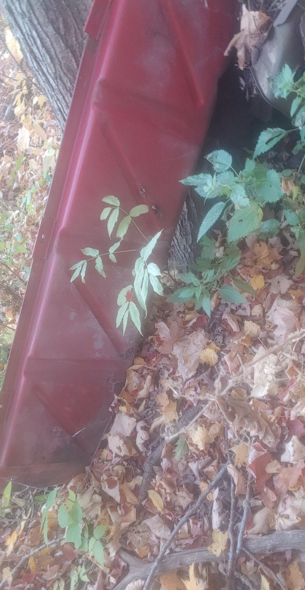

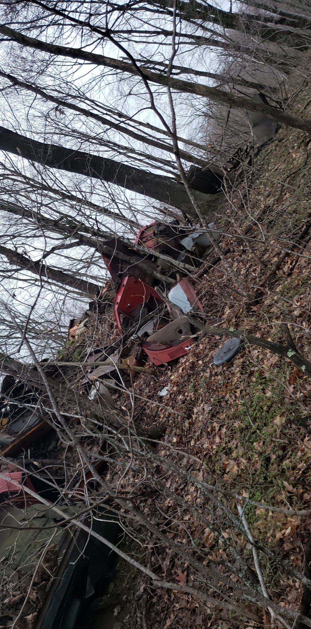

all I know is i have a hood or two that say F100 and I thought it said f150 but maybe both say f100
There is the remains of it in 3 spots if you want to ID it from a distance
The other same generation truck that was in our family was an F100 which had a lot of cool things like my GMCs west coast mirrors(camper special?), auxillary fuel tank(I have the bed as a trailer like the one you saw before lol)
70% chance this is a "F100" gas tank to match. 30% chance its a 72 and back GM truck of the same vintage that happened to be red.
