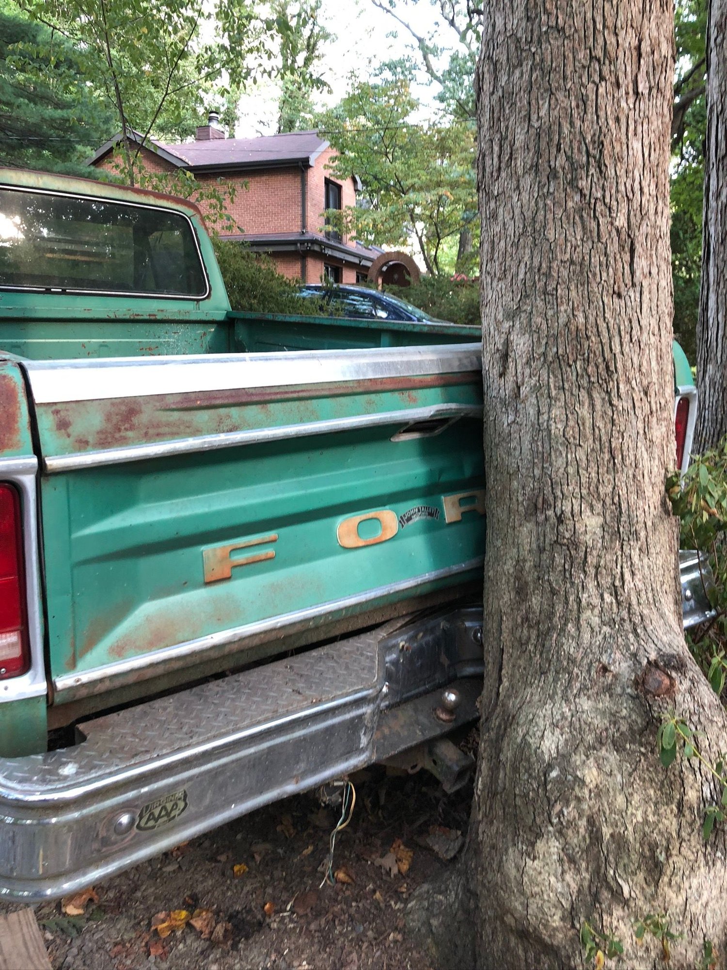

Oh damn that poor truck, You cant be seen driving around with that bad tailgate. ill take it off your hands,hell id come get it!
donations accepted
donations accepted
Haha that particular truck is long gone. Just unfortunate because it was all so preventable and I ruined a perfect OEM tailgate and bumper because I didn’t fix the brakes.
After overhauling the rear drums on the 95 F250 it stops great and the parking brake lever snaps back with great authority.
the ease of maintenance is great until you forget Eldorado you’re buying pads for.
