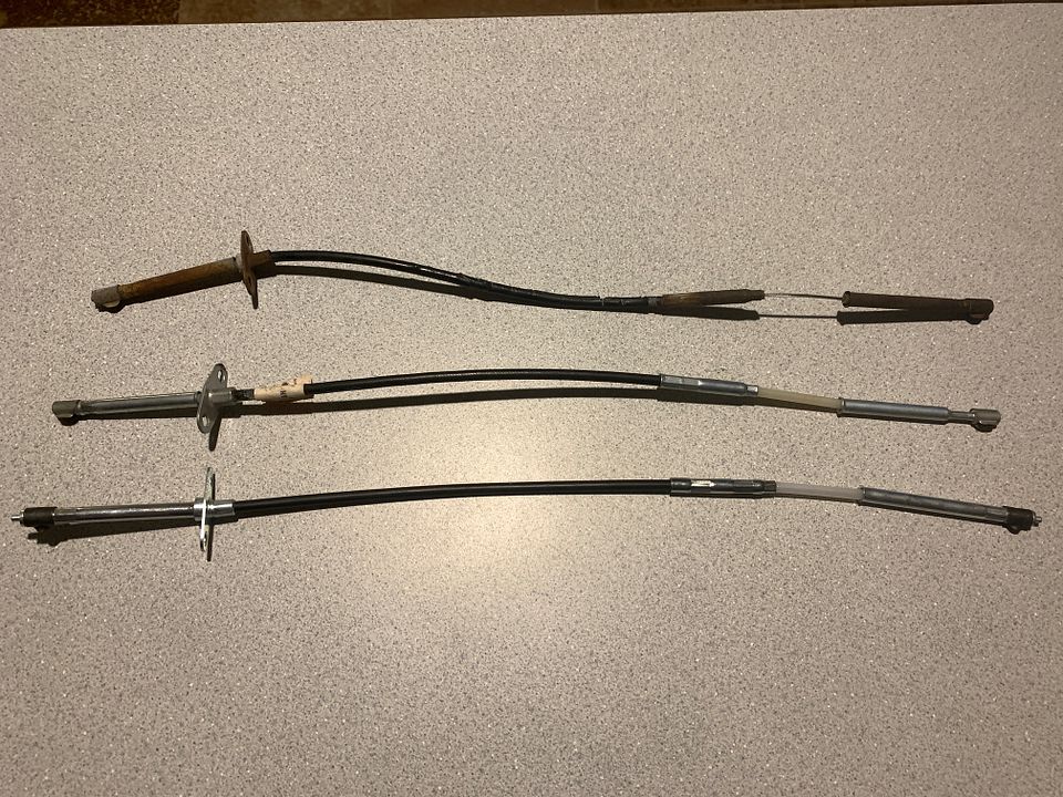

Give me a few and I'll take a picture of the NOS next to the Carpenter reproduction. They are nearly identical.

Top is my original, middle is NOS and bottom is Carpenter reproduction. I haven't measured the length since they are all the same or close enough to not be an issue. I can if you'd like me to.
They sure look close enough for me. I thank you for the time and help.
