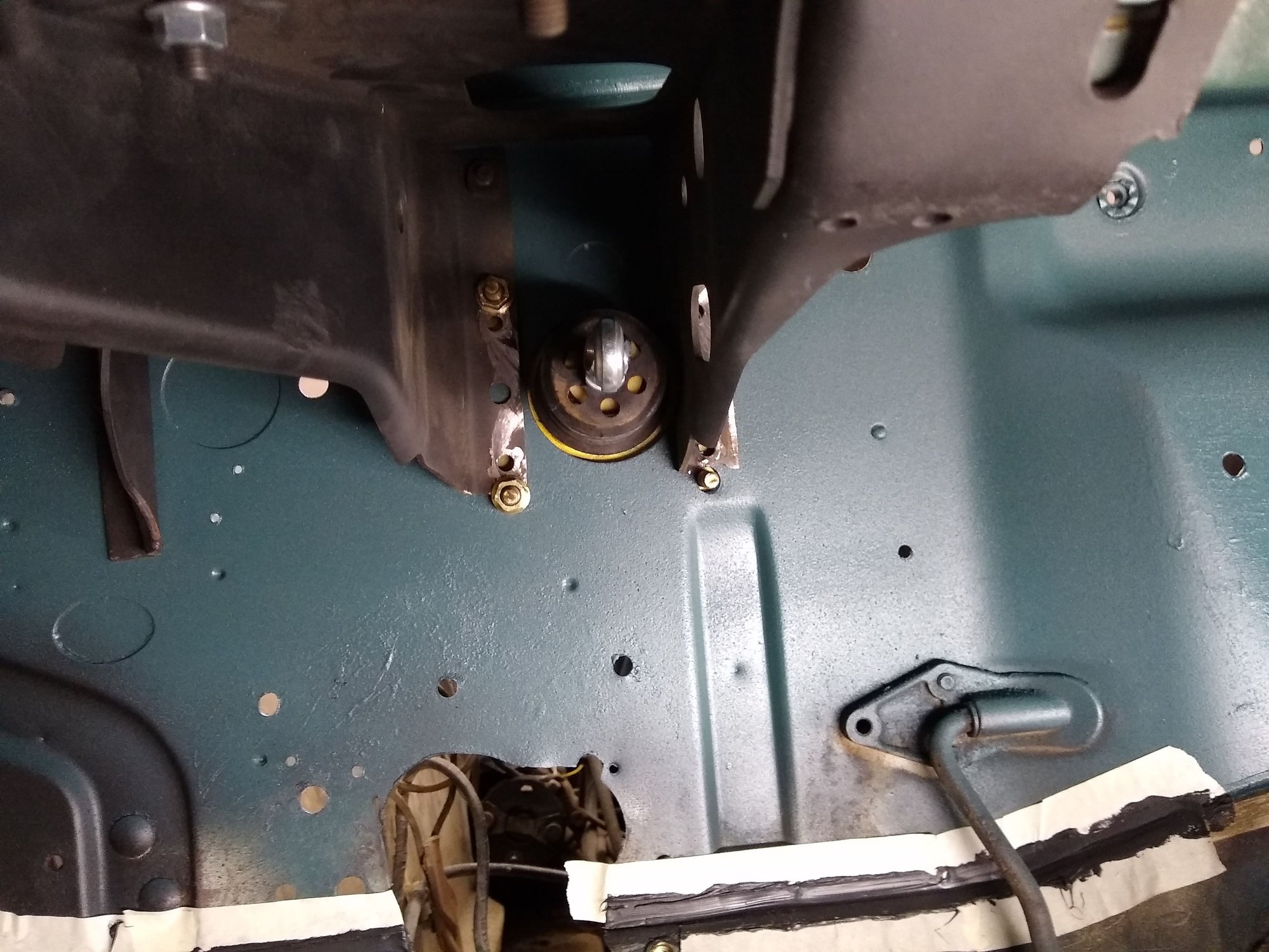

Hey Mikey, my truck has mechanical linkage, pedal to carb. 1961 F100
I purchased cable's for the kick down and throttle. The kick down lever was missing and the room for a lever is almost non existent, so a cable will be the ticket. I figured maybe going cable with the throttle would be better too not so sure about that now. I may go hybrid with the throttle. Parts will be here on Monday. Then I will decide yes or no with that.

I ordered these today.
