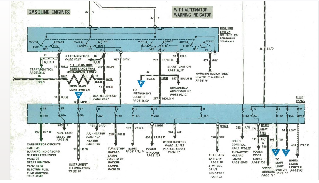

Yes you could. Finding the wires is the only headache. I was looking at the 1984 diagram, they originally used a grey with yellow stripe wire leaving the ignition switch and going to the fuse box. This wire feeds fuse 9, 30 amp for the A/C/heater and it also fed fuse 5, 15 amp for the turn/stop/hazards.
If you want to keep the power distribution somewhat original, you could find the grey/yellow wire, keep it intact to feed fuse 5, but skin the insulation back and twist the wire from a inline fuse onto the grey/yellow wire. Soldering this connection would be best. If you want to use a crimp, you could actually cut the wire, strip both ends, and take the fuse wire and install it with the grey/yellow on one end and put the remianing grey yellow on the other end of the crimp. These wires need to be fairly large, so I would use a large yellow crimp. On the other end of the fuse I would connect the brown/orange wire that is leaving fuse 9 feeding the blower motor. Finding all these wires is going to be the hard part.
I will attach the diagram below.

Got the wires figured out and the in-line fuse put in and the blower motor works! Thanks so much for the help.
