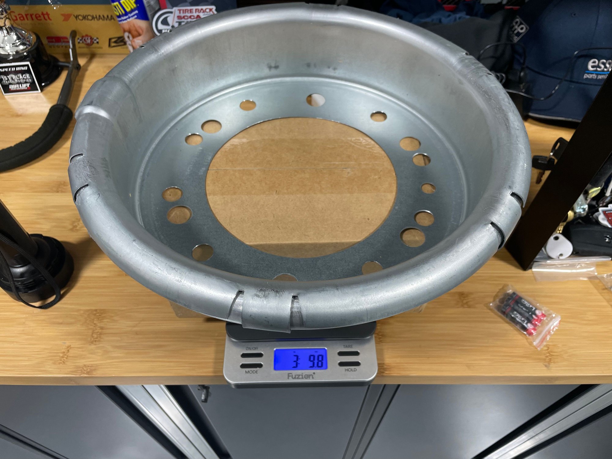

Now for the Centramatics.
That is 3 pounds 9.8 ounces, a notable increase in mass

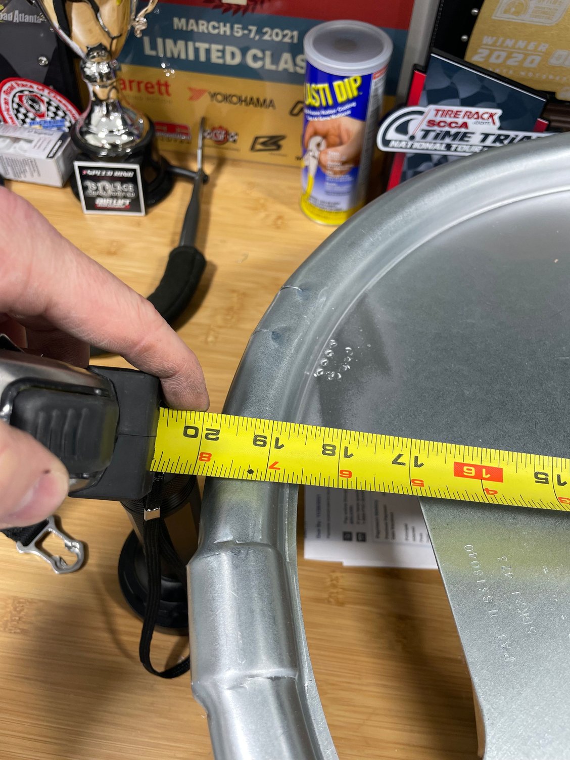

Rear Balance Master
4 pounds, 8 ounces (4.5 pounds)
Roughly 19.75.

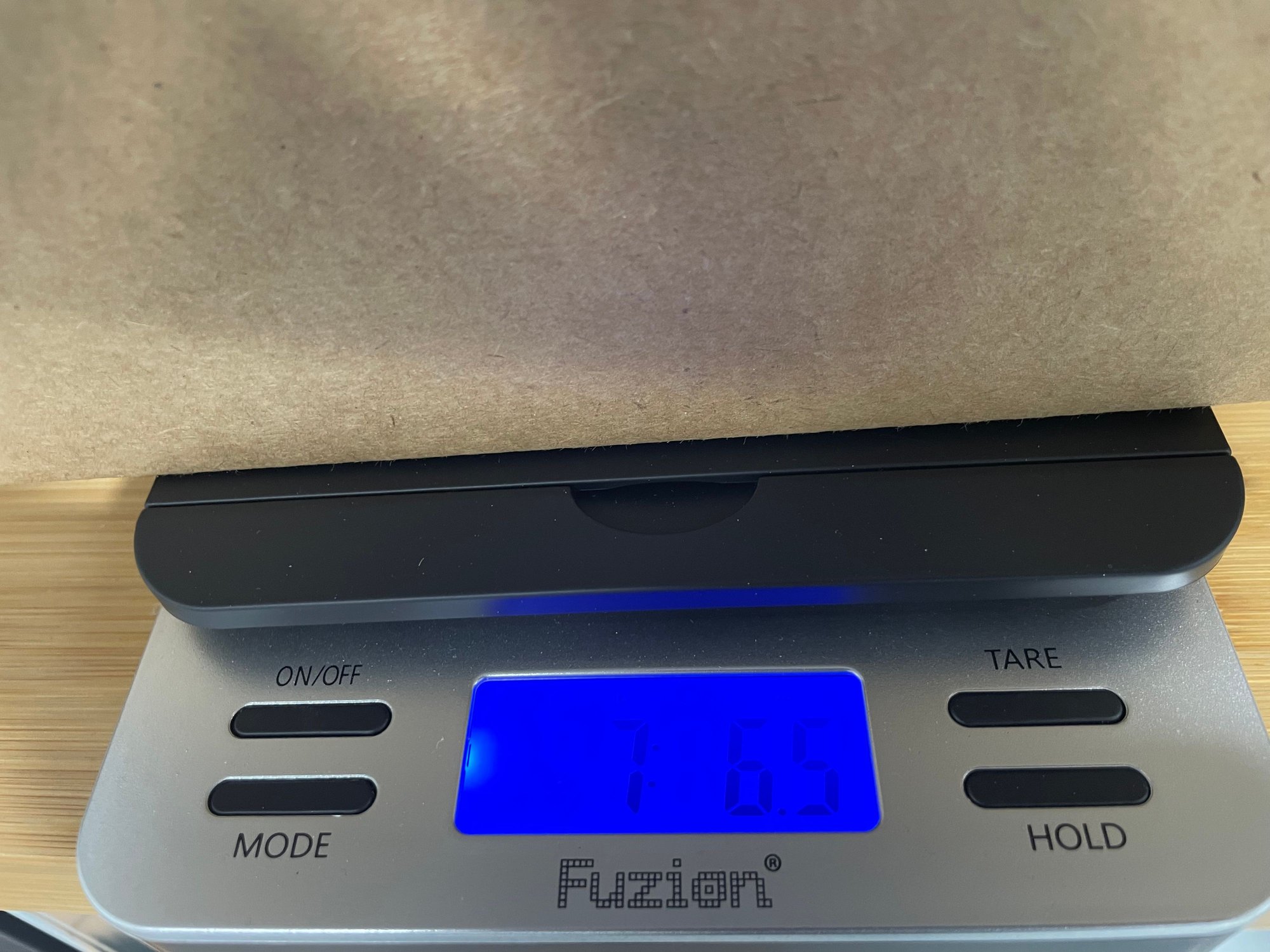

Rear centramatic
7 pounds, 6.5 ounces (that is roughly 3 pounds more mass).
