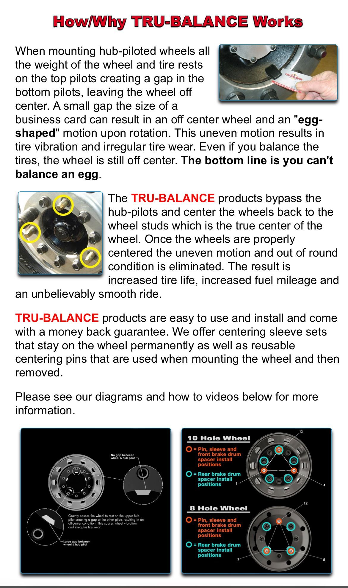

Originally Posted by WK15
Sir,
I see that you stated you added Tru-Balance sleeves to your F450. Can you please provide the Tru-Balance sleeve numbers you selected for your truck. I would like to add them to my truck also.
Thank You.
Walter
C-1910-FA
C-1911-FAS

Why all the discussion about centering sleeves if the wheels are hub centric? These topics seem to go opposite ways. Why would you need centering sleeves if the wheels are hub centric. Trying to be ready if any issues arise.
I’m not suggesting they are necessary, or essential.

Just to make sure that there is no misunderstanding, my earlier post of Ford's TSB suggesting the Haweka Flange Adapter Plate Kit is intended for use on SPIN BALANCING machines, not wheel hubs.
Spin balancing truck tires in typical automotive tire shops can be an exercise of going through the motions without actually balancing the tire and wheel assembly of Ford's 19.5" wheel, which has a much larger pilot hole than an automotive wheel, is much heavier than an automotive tire/wheel, and has a center of gravity that is much further away from the mounting face of the wheel disc, due to being a DRW.
In the late 90's, I set about to verify that tire shops were not really "balancing" tires and wheels by taking Ford motorhome dually tire and wheels to several tire shops, both corporate owned as well as independently operated, and paying them whatever they wanted to charge to "balance" the tire and wheel. I specifically sought out shops that had the very best equipment at the time, by contacting the equipment manufacturers, and asking them which shops had their balancing equipment. (ie Hunter, Coats, etc).
After the tire shop balance the tire and wheel assembly to 0.00/0.00, dead perfect, as I was standing right there next to the tire tech, I waited until the tire tech removed the tire and wheel assembly from the machine, and had it on the floor... then I popped the question.
Me: "I'll pay you extra if you can please rebalance that tire and wheel that you just took off."
Them: "Why? I just balanced it perfect. You saw it yourself. It's already balanced."
Me: (sheepishly) "I know, I know, you did great job too. Call me a weirdo or superstitious, but I wonder if it will still be balanced if you check it again, please? I'll be more than happy to pay twice."
Them: "You don't need to pay. It's balanced. I'll prove it to you. Watch this..."
And with that, the exact same tire and wheel that was just balanced a few moments before was remounted back on to the machine, and much to the astonishment of the tire tech, it was out of balance.
Same tire, same wheel, same technician, same machine, same shop, same day, same hour, same minute, same humidity, same temperature... but out of balance.
What the tire tech had balanced before was a rotating assembly that included the variance of how the centering cone of the tire machine was tightened to the wheel.
Therefore, Ford's TSB, and Haweka's flange adapter kit, was intended to reduce the variance of how larger truck tire and wheel assemblies are chucked up to balancing machines.
As for using stud holes to "center" a hub piloted wheel to a hub, you are not wrong to question the wisdom of that effort, especially with aftermarket wheels made overseas that are sold on based on the appearance of their design, not the control of their quality.
Since the wheels are hub piloted, rather than stud piloted, there is a specification for the hub hole, but what is the specification for the stud hole?
Furthermore, many aftermarket wheels come from China with no stud holes drilled, and aftermarket importers with American sounding names drill holes in these blanks to order. What are their tolerances for the stud holes?

Consistency and concentricity of the stud holes is an obvious requirement if using stud holes to "pilot" a wheel designed to by piloted by the hub. Otherwise, the entire point of the industry moving away from lug centric and adopting hub centric wheel mounting methods to minimize installed radial runout... would be lost.
