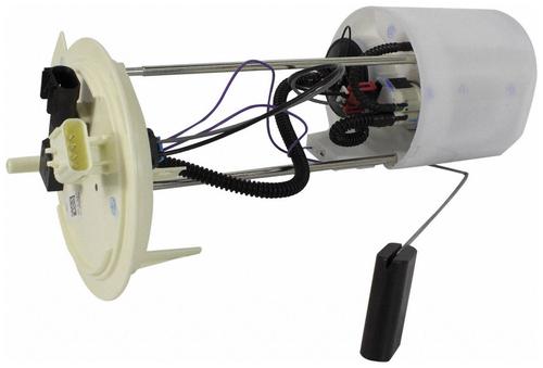

I know theres a thread on this, but Damn Im getting tired of putting fuel pumps in this truck.
2 now, and a year from now what?? another, then its off warranty.
Typical crank forever, after driving for awhile and sitting for hour hot outside...
Im in Yuma AZ for winter, and whether Im in cold in Canada or Heat in Yuma It would do it. Although it was in summer for failures.
Are we all having this issue and when will Ford fix it, last pump was the Upgraded pump.

Pump check valve is failing every time. Pump still runs fine. Pump pressure went from 60psi running to 0 psi in 1 minute after engine shut off. Whoever is building this pump needs to reengineer the check valve.
I may cut the discharge line and install a swagelock check valve after its off warranty if this continues. as long as it will flow enough.

Installed 3rd pump last Friday.
I had Ford change out the pump at 44k miles. The same long crank symptoms started again now at 100K. I called the dealership - he said it would be close to $1,200 to have it replaced. The parts alone (pump and gasket) was $496. So I went online to O’Reilly’s and ordered the same Motorcraft pump and gasket for $351 out the door. It wasn’t a terrible job, once you get the plastic clips figured out… a second set of hands is a plus. I too will wait and see if this latest revision can make it more than 50K or I too will be installing an inline Swagelock check valve.

Fuel Pump, Hard Start
I'm looking at replacement pumps for my 2018 F250 XLT. There is a PFS 1355 ($100), PFS 1381 ($300), and PFS 1382 ($350).
All of which appear to work as a replacement for the faulty pump. (PFS 12xx I think)
For folks running into this issue, what part # did you replace with?
I've seen posts where PFS 1381 fixes the issue (for a while at least), but has anyone used the cheaper PFS 1355 with good results or are they all POS?

Railroader, my '11 6.2 F350CCLB pump worked faithfully, not a single hiccup during the 180k+ miles I drove it. Unfortunately, I have not had the same luck on my '18 6.2L F350CCLB fuel pump. It was replaced under warranty at 20-30k miles when it started the classic problem of progressively delayed start after a several hour soak. The updated part number Ford pump worked great again, instant starts for another 20-30k miles when it too started the delayed start issue. Let my truck sit more than 7-8 hours, perfect start.... but sit for an hour, 2sec of cranking; sit for 4 hours, 4-7sec of cranking. Now, at 77k miles, it is getting close to 10-12 sec of cranking before it starts after a 5 hour wait after driving.... but wait for 7-8 hours, starts right up. I have tried the cycling the key several times to prime the pump to no avail. I am going to drop the fuel tank myself this spring (after the snow melts) and replace with the latest available OEM Fuel pump from my local dealer. But boy, this sure is a ridiculous problem...
