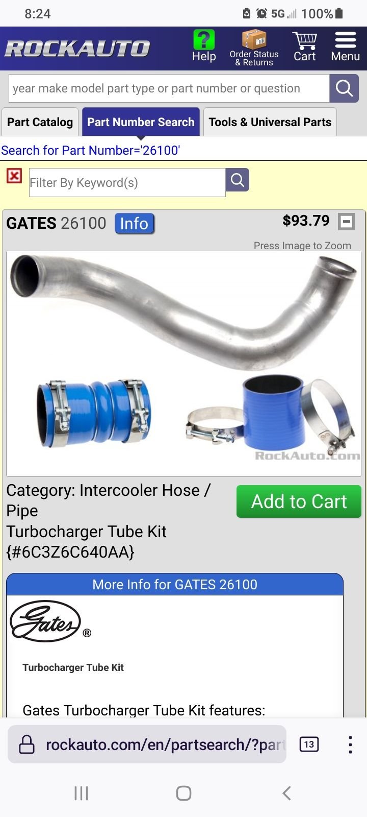

Old Nov 23, 2021 | 08:29 AM
six_eaux's Avatar
six_eaux
Joined: Aug 2021
Posts: 96
Likes: 55
There are plenty of options out there that cost more, but this is what I went with. Comes with the boots.
Old Nov 25, 2021 | 06:49 AM
IHateCommieCars's Avatar
IHateCommieCars
Joined: Jul 2014
Posts: 4,673
Likes: 532
From: Houston, Texas
Metal CAC tubes were standard on later models and are easy to find at dismantlers and pickupart yards. Just as good as new ones and may have good boots too. I think one or more of the 7.3 boots interchange too.
