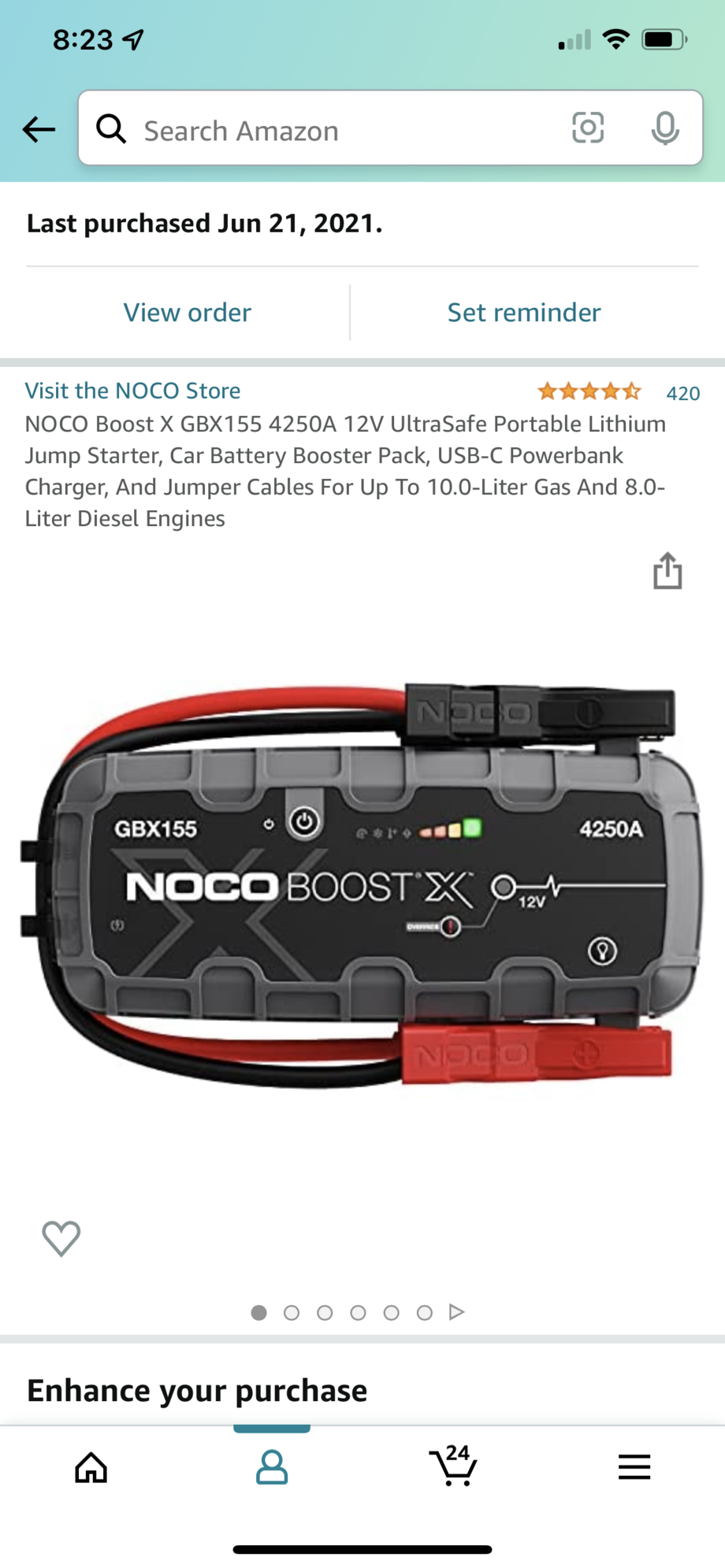

I’ve read too many stories about electrical systems getting fried while jumping or getting jumped.
I ended up buying this NOCO. I think I paid $230 for it during a special sale Amazon was having.
I used to freely jump people until I fried my second alternator. Now I'm a lot more reluctant to do that. I'm not sure why the alternators are damaged are so easily and is it because I put the ground on the alternator case? Either way, I want to have jumper cables though.
Don't jump start the other vehicle with your running vehicle. If your jumper cables are of proper size and you have a good connection they should be able to easily start their vehicle without your vehicle running.
+1 To this. Oftentimes it's hard to find someone for a jump even if you have the cables. This has been a much better solution for me.
