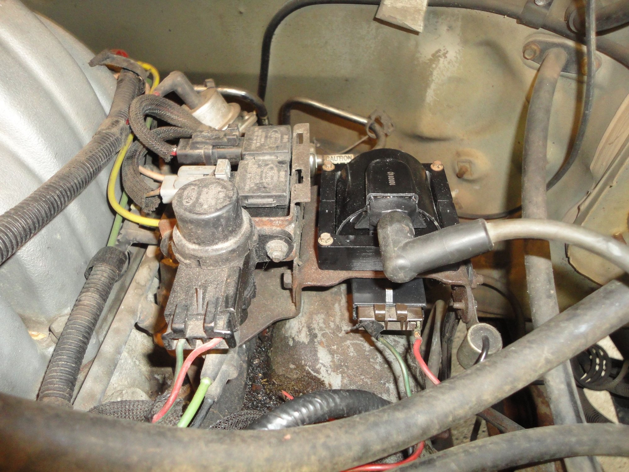

I dont remember what this is or where it connects. Can anyone identify?

That is the ignition coil mounted to a bracket. The small cylinder with the single wire is the radio capacitor. It is designed to prevent noise from the ignition when listening to AM.

Thank you for identification. Can you tell me where it hooks up to?

Borrowed from Google images:
