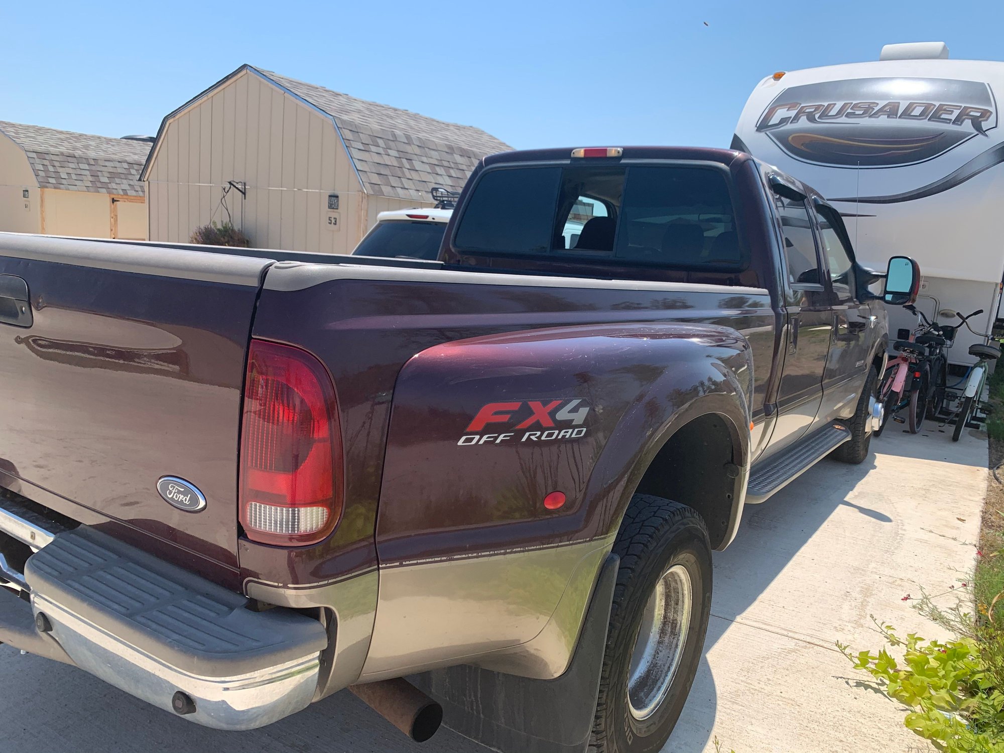

Yes, the rear window was open in this shot. Thanks kids. 🤦‍♀️
