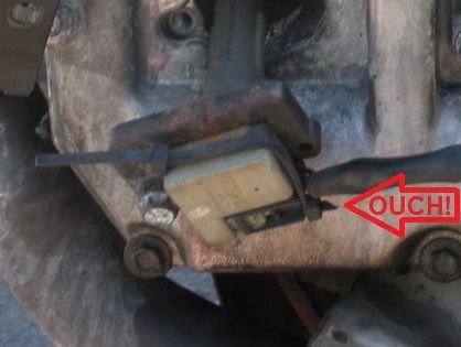

FWIW, here's a picture of the zip tie holding the connector on a coil pack. That zip tie has been there since about 2008. That connector now has 299.700 miles on it. Picture was taken May 2012.
I'm surprised there's no blood dripping from that nice little knife edge:
If you'd be so kind as to leave the hood open, I'll swing by and trim that tyrap nice and square.
FWIW, here's a nice neatly-trimmed tyrap securing the TPS connector on my car. It's been like that for about 8 years or so, with zero issues:

It's a 2005 Subaru Legacy GT. there is very little space between that coil and the frame rail. It's not a normal place anyone can fit their hand. Plugs have been replaced a couple of times since the photo. No problems with getting cut.
In fact, I leave the connectors on the coils when I change the plugs.
