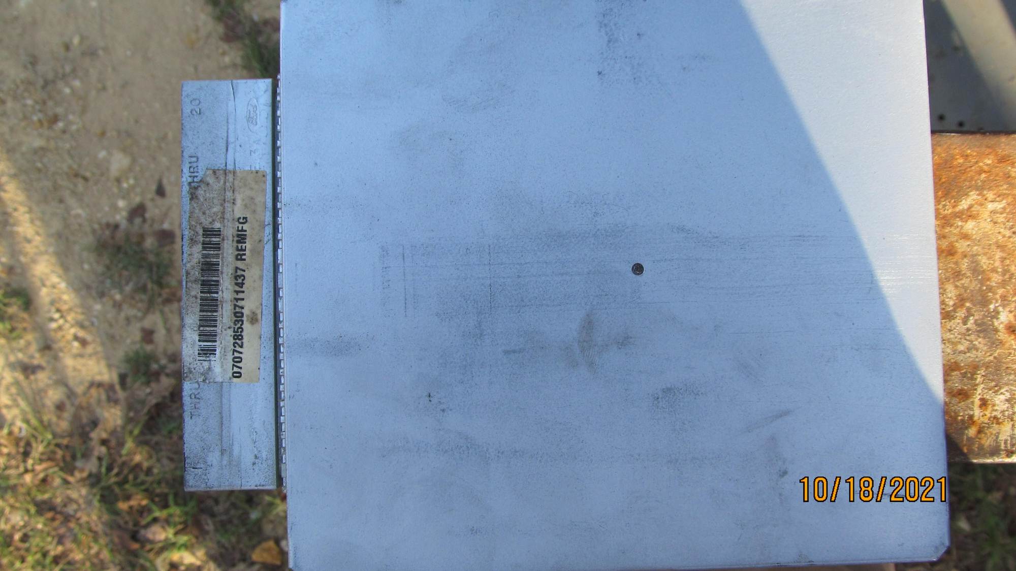

I had to replace the 351w in my newly bought used E350. I bought a long block and paid the core charge to keep the original engine. I am rounding up part to make the old motor run on a stand. In reading about the EEC ( that is the proper term for the computer?) I saw some on ebay for a 96 351w that were normal aspirated. Did not think that would be some thing FORD would do. So wanting to get one that would match my Van I pulled it to check for numbers. I think it has been replaced. ''070728530711437 REMFG'' on it sticker.
Can someone tell me what the proper ECM for my 1993 ford E350 window van with a 351W EFI motor would be?

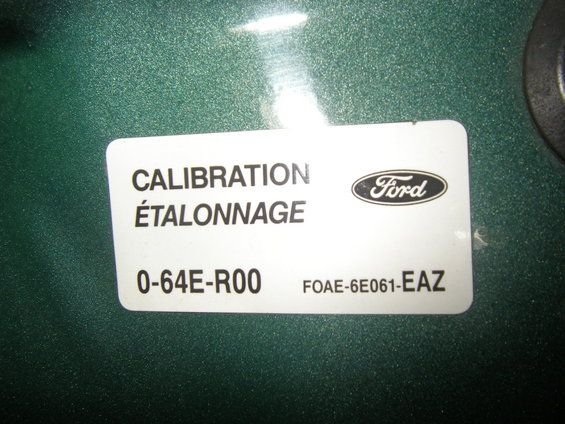

Originally Posted by BSF350
First when you say calibration decal is that the sticker with the vin on it?
Not quite, there should be another one like this...

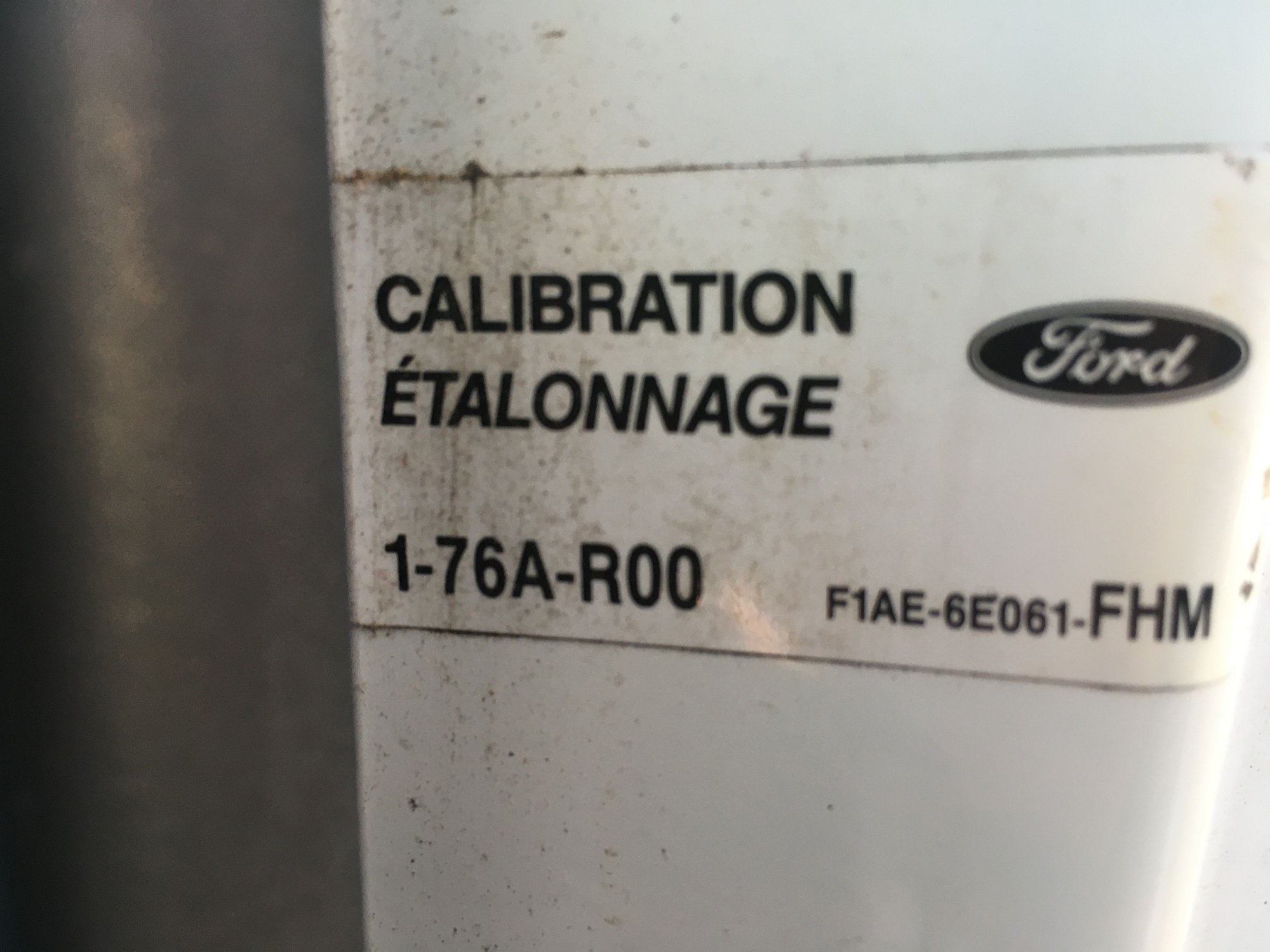

Here is my calibration sticker. What does it tell you?
Flagship1 verified the ECM I am look at should work on my stand. As a 88 E-Series
Old Oct 23, 2021 | 02:25 PM
Conanski's Avatar
Conanski
Joined: Jun 2006
Posts: 31,930
Likes: 1,499
From: Ottawa, Ontario
That code doesn't tell me anything unfortunately, but another member(subford) has a lookup table for them I believe so if you can send him a PM.
