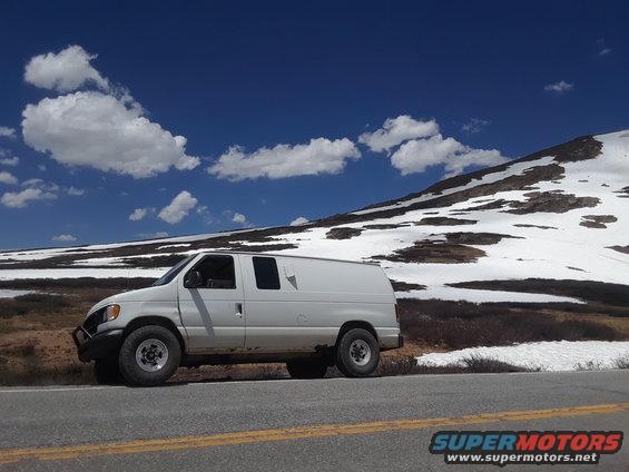

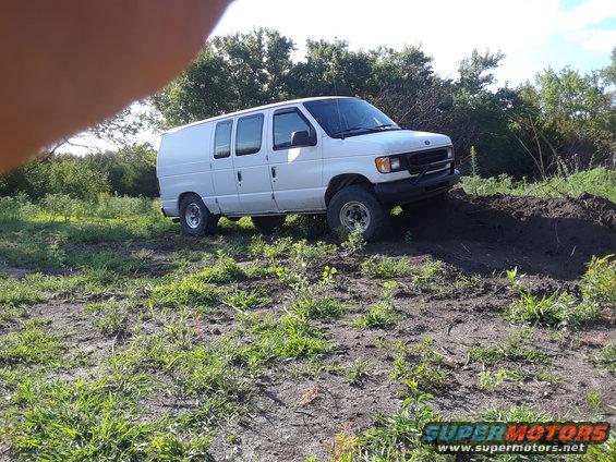

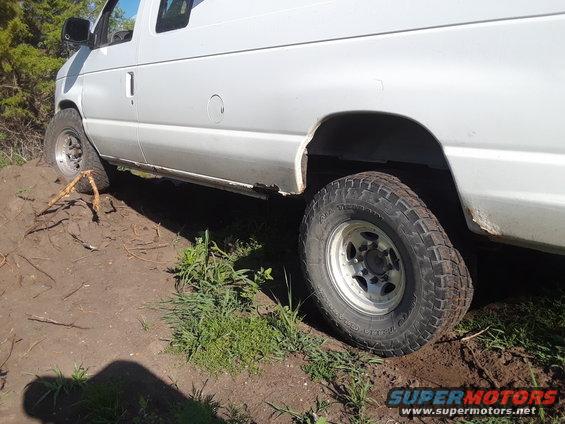

I successfully fit 305/70r16 (actually measure 32x10x16) on my 99 e250. I did have to trim the front fenders a bit. When flexing the suspension offroad I do get a bit of rub still.
I've taken mine through some hairy stuff for a van. Even had it on top of a mountain. I hold the self proclaimed title of making it up Rollins Pass West in a van the fastest at 47 minutes. In a midnight thunderstorm for a buddy with altitude sickness.
These vans do flex pretty well, for a 3/4 ton work van.

Tire choice is big in a 2wd van. I'd constantly get stuck with the 28" highway tires but these bigger all-terrain tires did quite a bit better. A locking differential will be a big help too.
