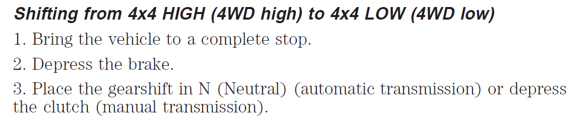

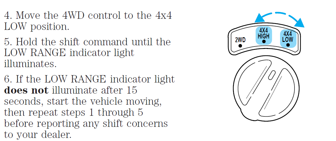

Just for keeping things legal, I took the snips below from the owners manual.

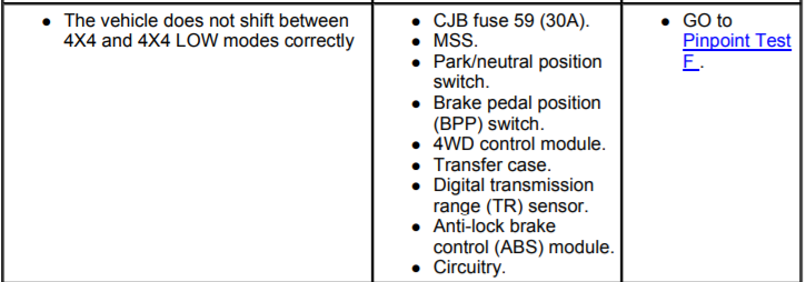

Ok, so my current problem is when I switch from 4x4 high into 4x4 low. When switching, I hear a noise from the engine compt somewhere. Then I lose 4 wheel drive altogether and no lights. In order to get back into 4x4 high, I have to turn the truck completely off and restart it. Once I do that, I can switch into 4x4 high again. All visual inspections look good, I switched the relays too.
Swapping relays and observing "no lights" is good, but you need to run through the pinpoint test linked in post #2 above.
For example, one symptom description on page 15 in the document is as follows.
