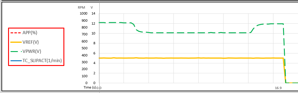

VREF is steady at 5V. VPWR seems ok, 12.1 with glow plugs on, dipping to 10.2 during crank. FUELPW is commanding over 1ms so CPS should be good, and fuel should be delivered if fuel pressure is good.

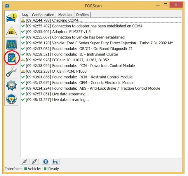

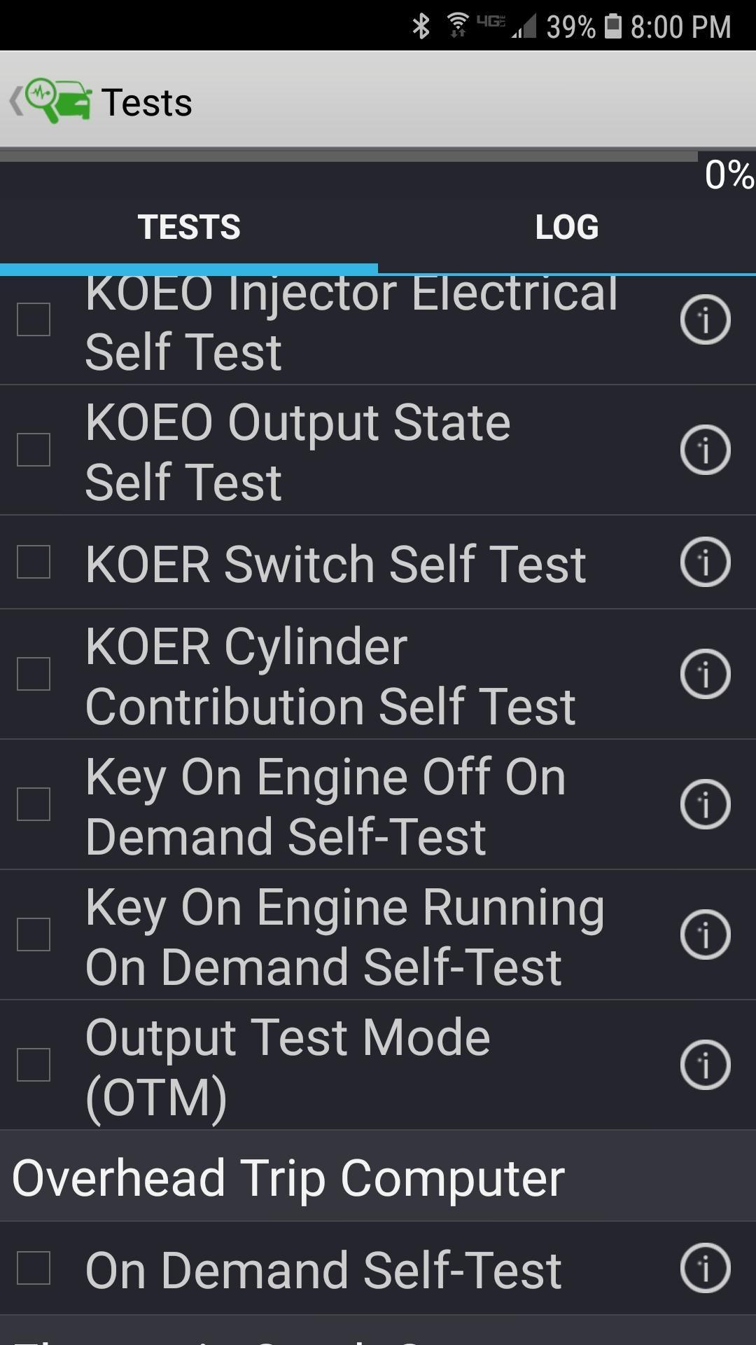

Old Dec 28, 2021 | 09:58 AM
BWST's Avatar
BWST
Got Data?
Joined: Dec 2012
Posts: 4,250
Likes: 1,382
From: Lake Stevens, WA

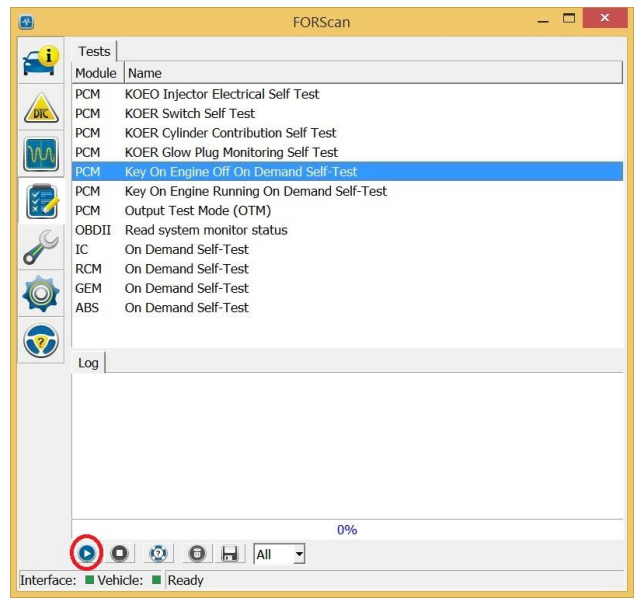

From PSD Diagnosis on the Cheap!, here is a screenshot of where to find the tests in the windows version:

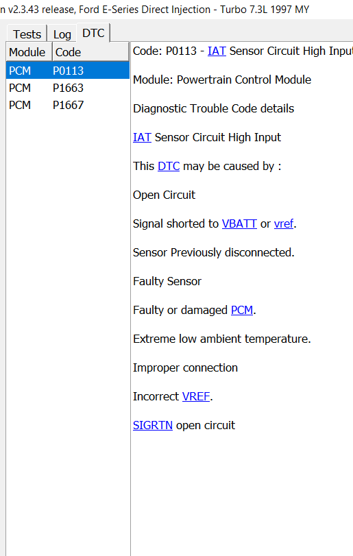

Old Dec 28, 2021 | 01:08 PM

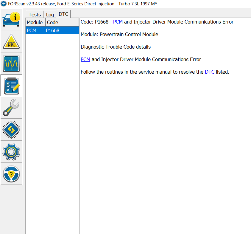

Loamranger's Avatar

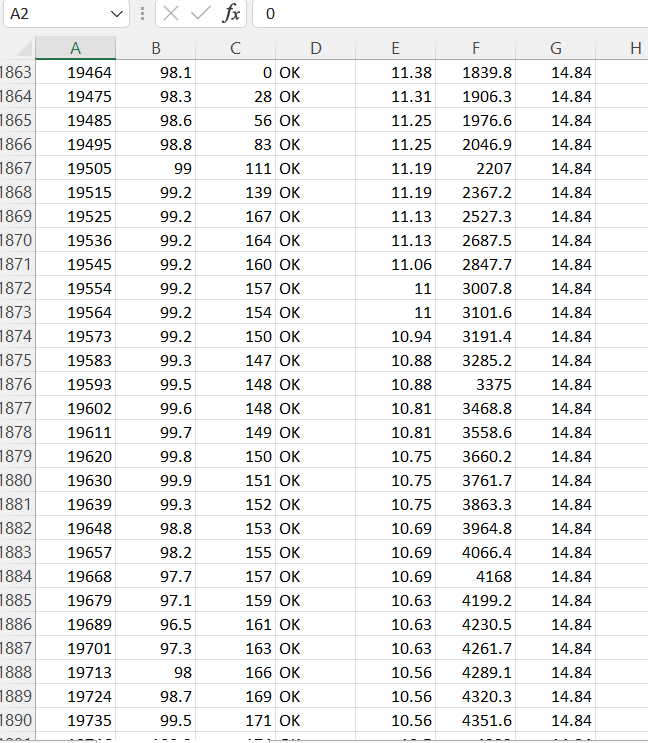

Old Dec 28, 2021 | 01:14 PM
Loamranger's Avatar
Loamranger
Joined: Nov 2020
Posts: 108
Likes: 45
I soldered on new battery cable ends and it increased the voltage while cranking. I think there might be some type of parasitic draw on the batteries. They seems to drop off quickly. It is an ambulance so there is a ton of wiring. I disconnected the main ambulance panel that controls the lights but I need to do more digging. Here is the rpm and voltage from the last crank attempt.

Old Dec 28, 2021 | 01:35 PM
BWST's Avatar
BWST
Got Data?
Joined: Dec 2012
Posts: 4,250
Likes: 1,382
Nice improvement in cranking voltage.
What tests did you run? I can't tell what codes go with what test from the screen shots above. How did the KOEO Injector Electrical Self Test (buzz test) sound?
I think we can ignore the P0113 for now. I don't see the typical P1316 IDM communication code, but the other IDM codes P1663, P1667, P1668 may be pointing to a bad IDM. Recommend checking the wiring for continuity, short to ground, short to power from the IDM connector to the PCM connector and to the UVCH's, and getting eyes on the IDM itself - see if it has water/corrosion in it.
If that checks out good, either send in your IDM for check/repair, or replace it. Diesel Technology of Chattanooga is a good source for IDM testing/repair.
