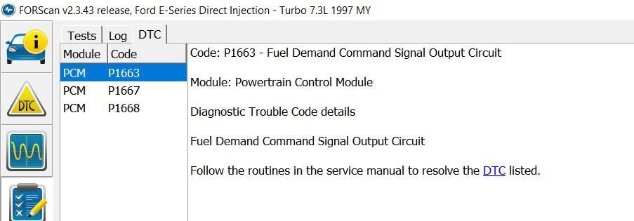

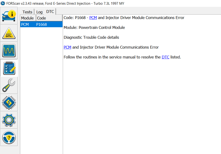

Jeff - Thanks for the reply and info. I appreciate your help! I will start looking into the IDM and electrical connections. I will start reading up on the P1316 code and report back. The first screenshot was titled electrical self test and the second one was the key on engine off test. I'm not sure if it was the buzz test or not. I will have to run it again to verify.

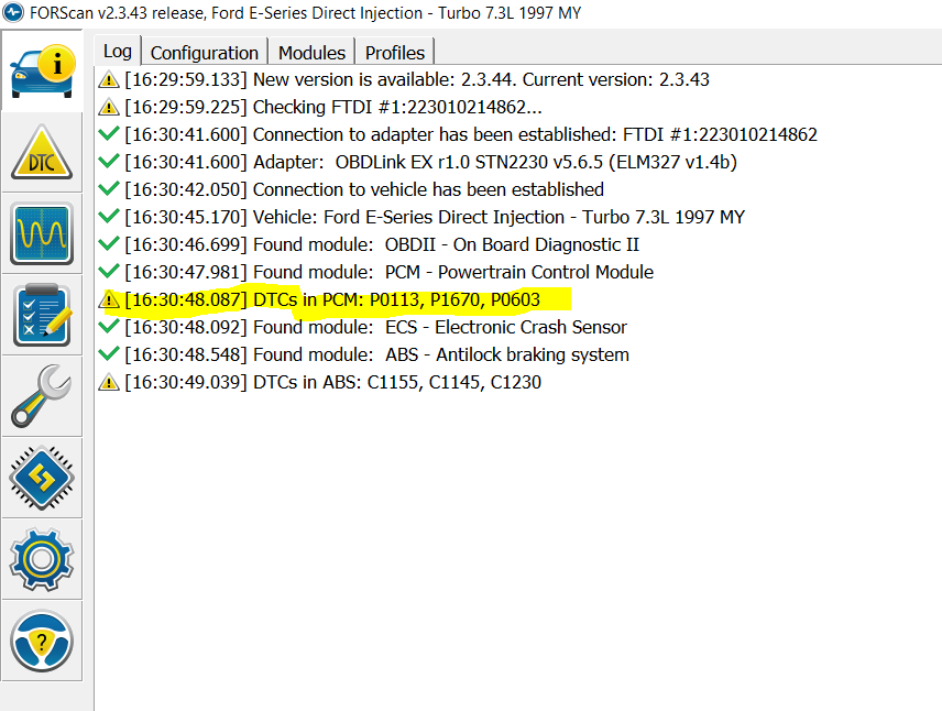

The first picture is from the failed buzz test. The second picture is the initial scan when forscan is opened. The third picture is the key on engine off test.

@Loamranger , you have a clear direction now - need to get those injectors buzzing. Great that you had another IDM to try.
Before the PCM needs a look, check that IDM relay (is there one on a 97 E350?), and some wiring checks.
Attached is the P1670 pinpoint tests for a 2001 - hoping it will be applicable to your '97. Here is the 1st part that seems to line up with your codes:
Interesting that under "Was DTC P1668 present? - No", it says to go to FJ6 if you have all three of those codes, which you do:

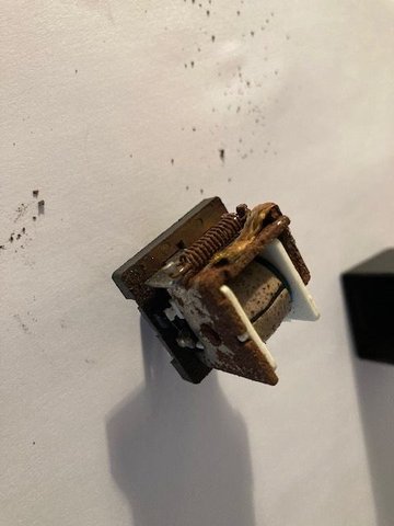

Solved - It runs!
I checked power pin 14 on the IDM connector as BWST suggested. There was power to the IDM relay block base. There was no power to IDM connector pin 14. I messed around with it some more and got a reading of 5 volts at pin 14. I swapped one of the relays and got 12.5 volts on pin 14. The IDM relay was corroded inside. The van fired up instantly after screwing around with it and not running for 3 months.
The problem was a $10 relay. I now have two new batteries, new battery cable ends, new starter, new cps and a much deeper understanding of the workings on a 7.3 and forscan. I didn't really want to learn this much but I appreciate everyone's help. BWST - do you drink beer? Send me your address and what you like and I will mail you some for your help.
