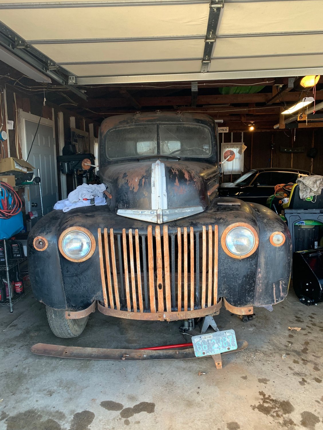

Finally warm hear in Iowa, back out in the garage…nothing too crazy. Did the brakes on my dana 60, painted the new drums, and pulled some more dents on my front end. Got it straightened out to where I’m happy with it and doesn’t look too hideous.
Engine update: all the work is complete except the valve seats so I’m impatiently waiting for a call from my machinist. Front brakes are a little different path so bare with me guys, I am using the front assemblies off of a 68’ F250 4x4 dana 44…yup you heard me. I’m insane but I had parts on the shelf (drums, wheel cylinders, shoes, and spring kit). I’m having my F3 hubs turned down to accommodate the F250 drums, should see those shortly. Also redrilling backing plates for my 47 axle. I wanted disc brakes but these f250 drum brakes will make it easier to source parts and should provide some stopping power.
once summer hits it’s time for patch panel galore, as in I’ll be doing cab corners, grill, and rear fenders. Then cleaning up the underbody to preserve from more rot (cause I hate rust), all front suspension/steering components, and lastly figuring out how to match some rust oleum to my current paint job cause I don’t have plans to paint this tonner.

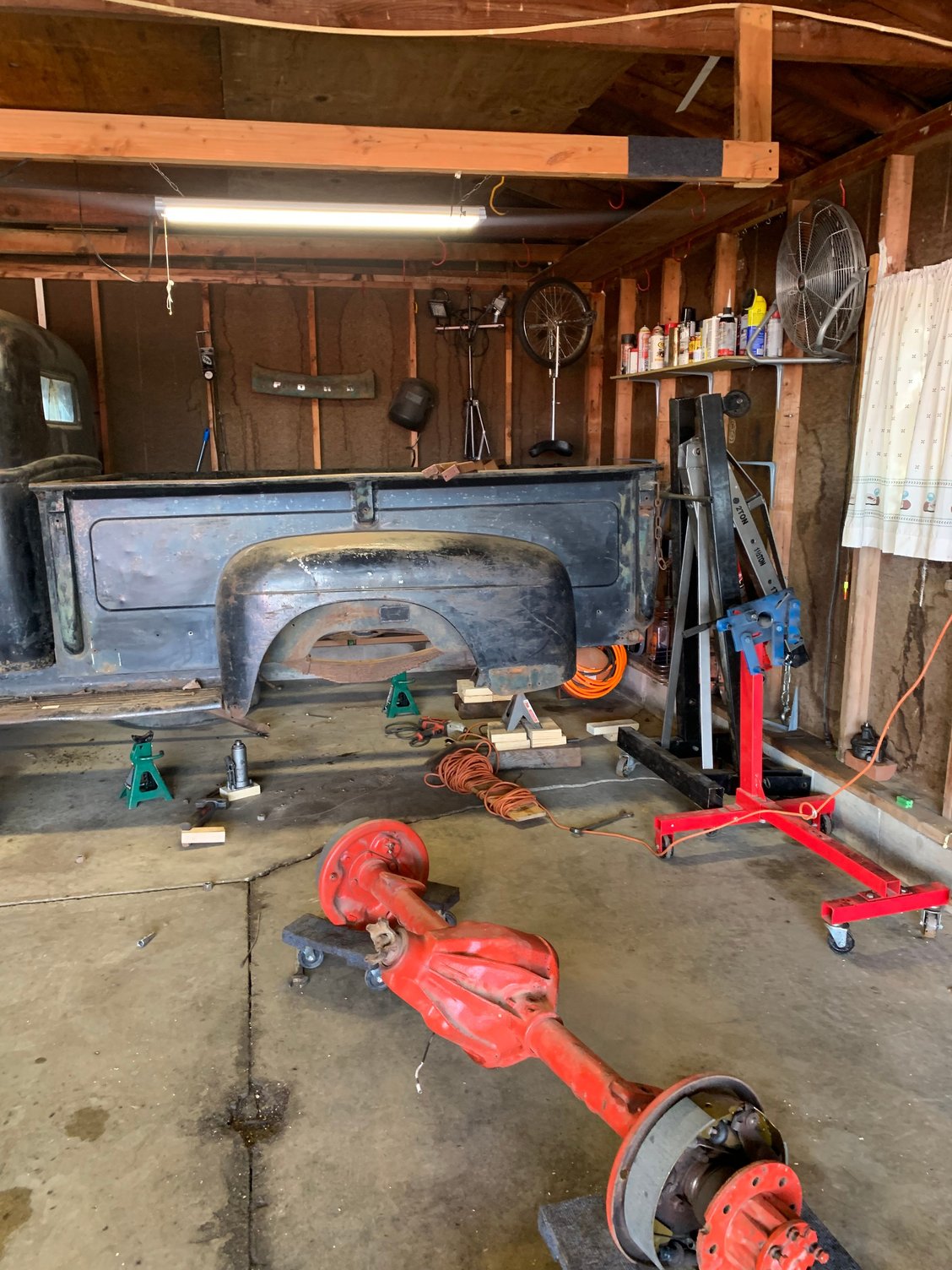

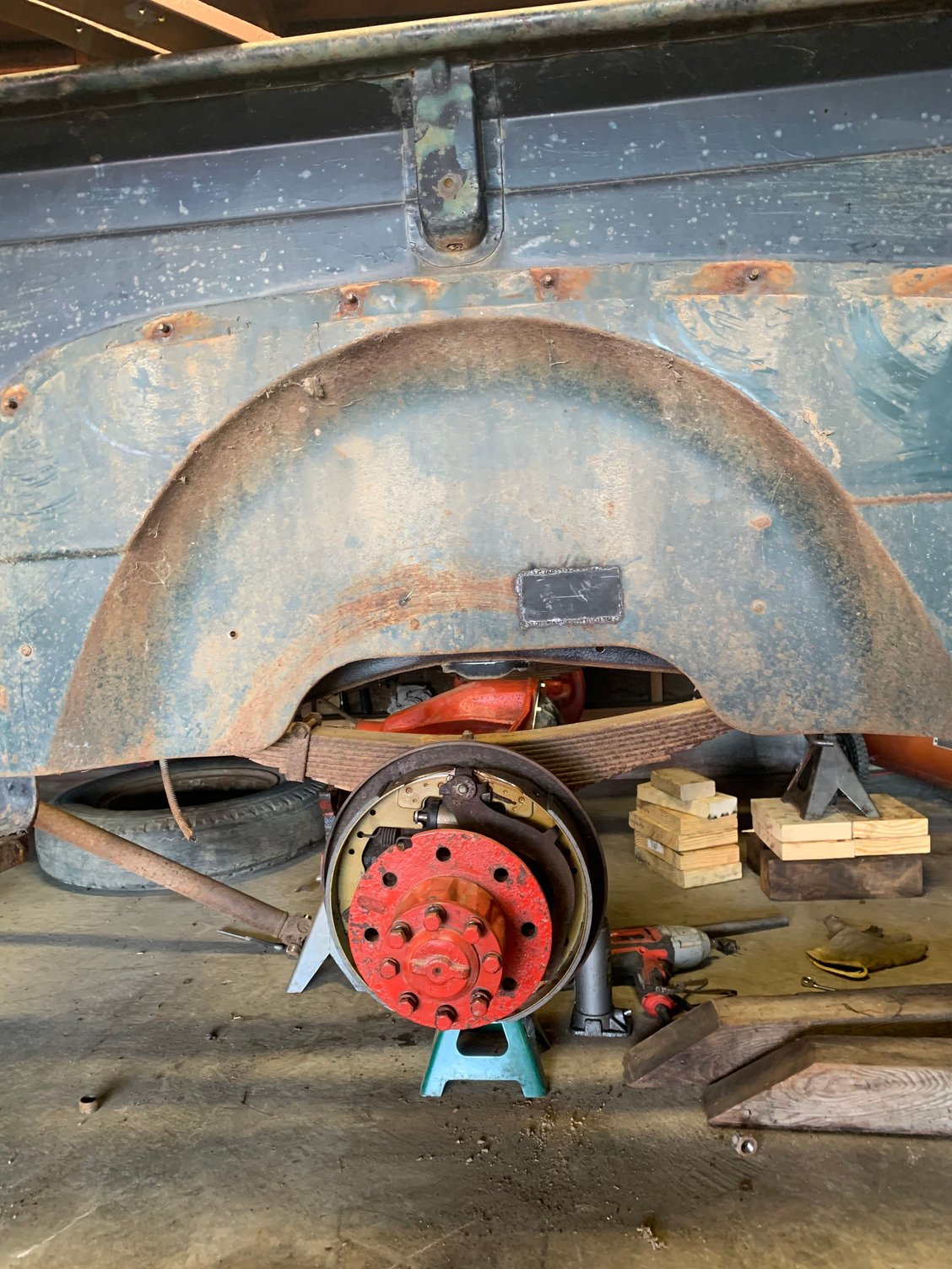

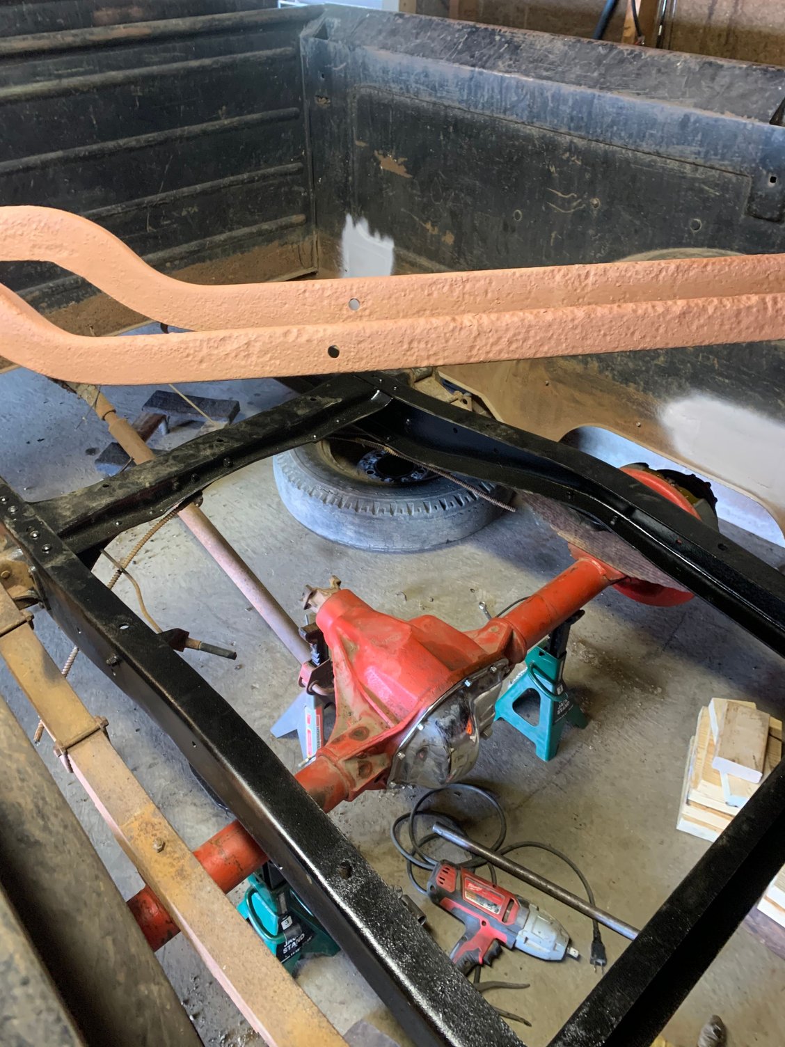

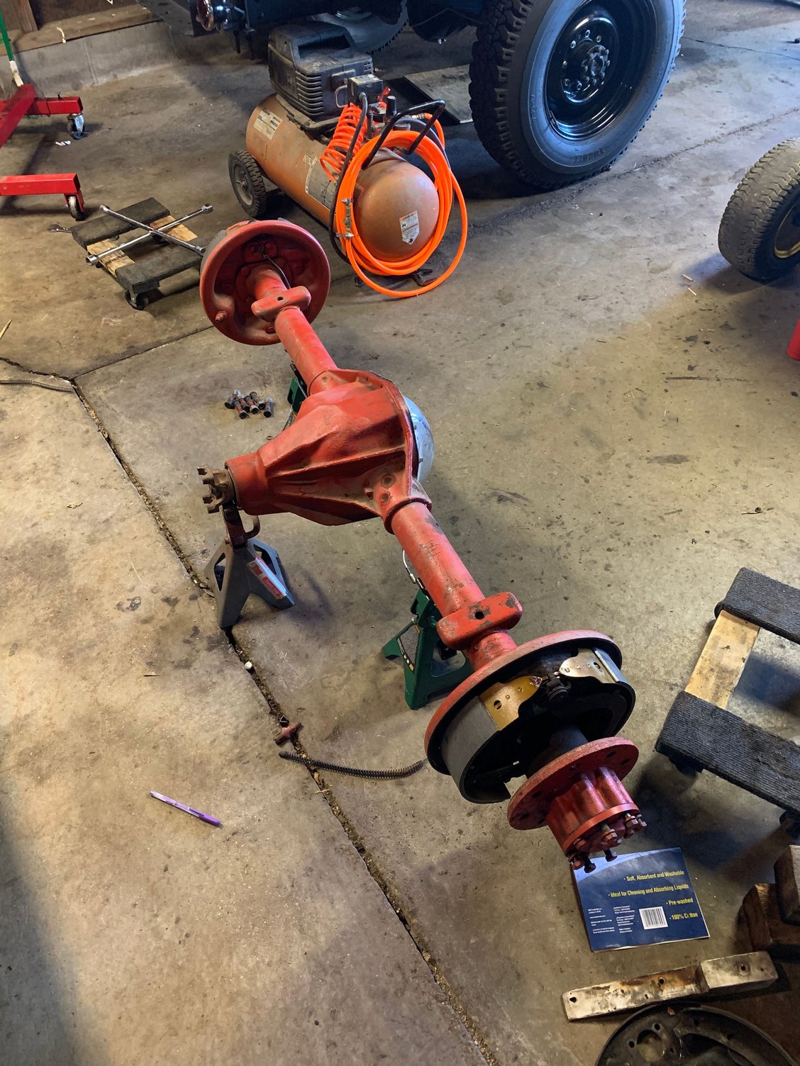

Got my Dana 60 installed over the weekend, heres a 1 ton 47 sitting on 8 lugs for anyone that is interested. Wheels will be painted don't worry. Axle will be too. I am satisfied with the stance thankfully, makes my life easier. Also got my 50’ F3 out finally after winter, i think im going to enjoy this 47’ more

Dangit Sammy... Yer killin' me with that s#!+ !!! The stance those, gol-dang eight and a quarters.! And who'da thunk the 8 lug fronts were a bolt on. Yer killin' me here kid!

Thanks GB, still gotta sort out a few things to make this 8 lug swap a reality but yes she sits on all 4 8 lug rims but the brakes are another story.

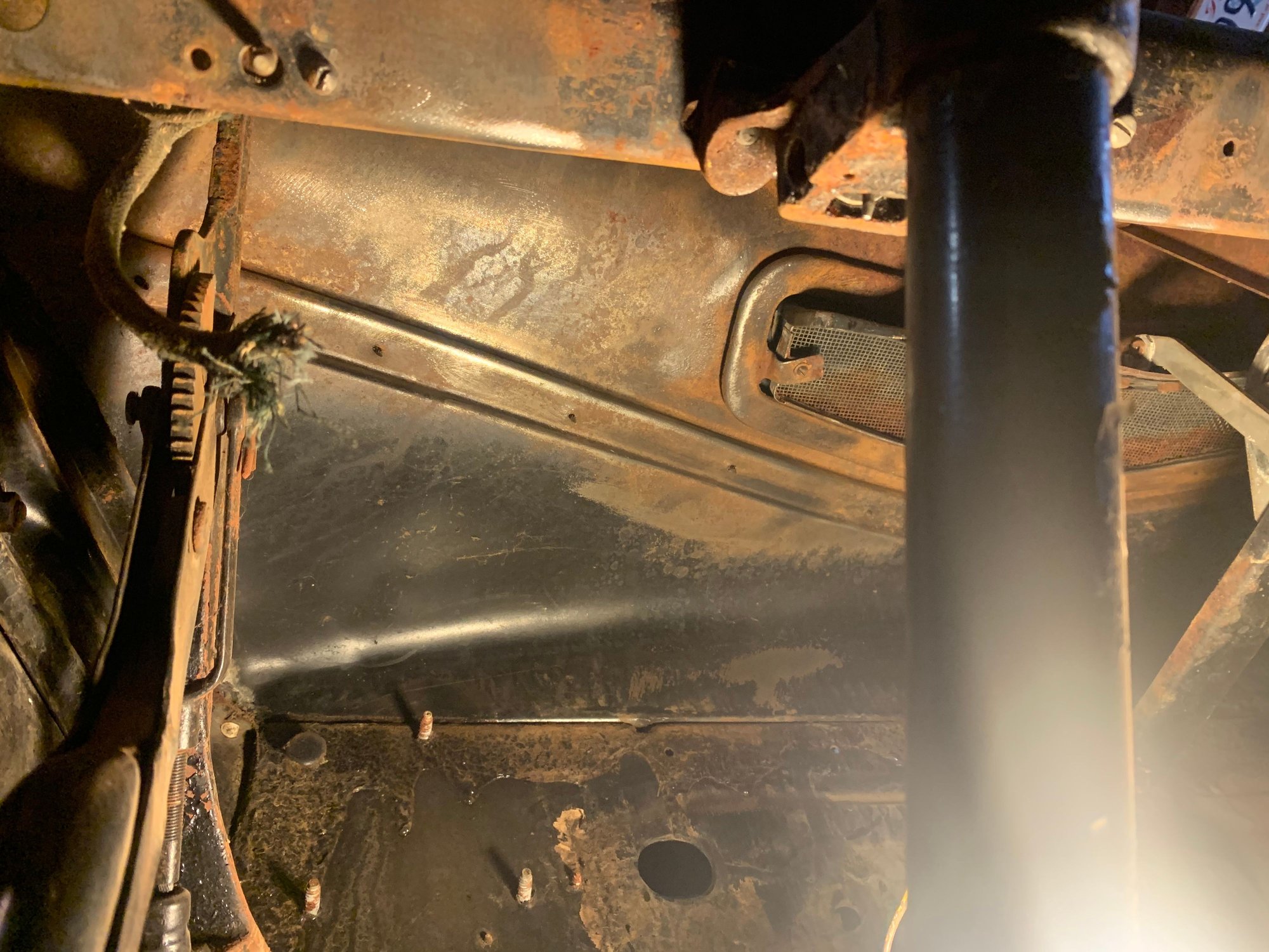

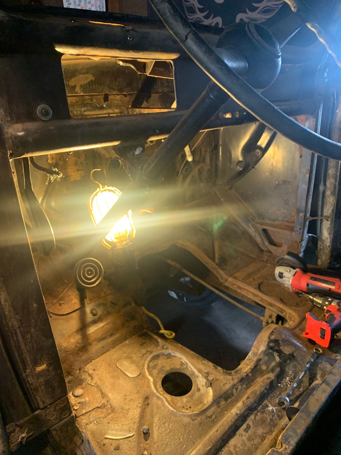

back to the tonner, since then Ive finished gutting the cab and found some more rust, seems under the dash was pretty ugly. So I cleaned it up and shot it with some rustoleum primer. Let me say, this is the nastiest cab Ive ever worked on as far as mice…Will paint later when I paint dash doors etc. I have some patch paneling ahead of me, then I can strip all the way. My F3 is going away for a few months so ill room to pull this thing out and patch up everything. Oh and hey my windshield seam is SOLID I was scared about this…

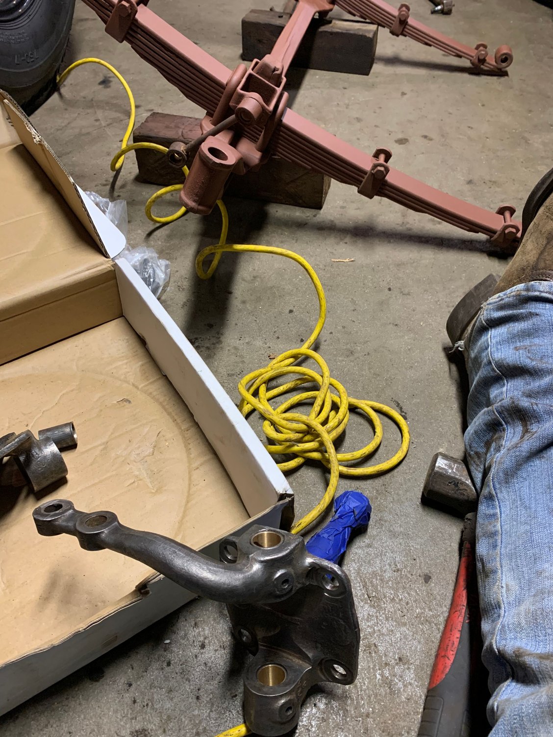

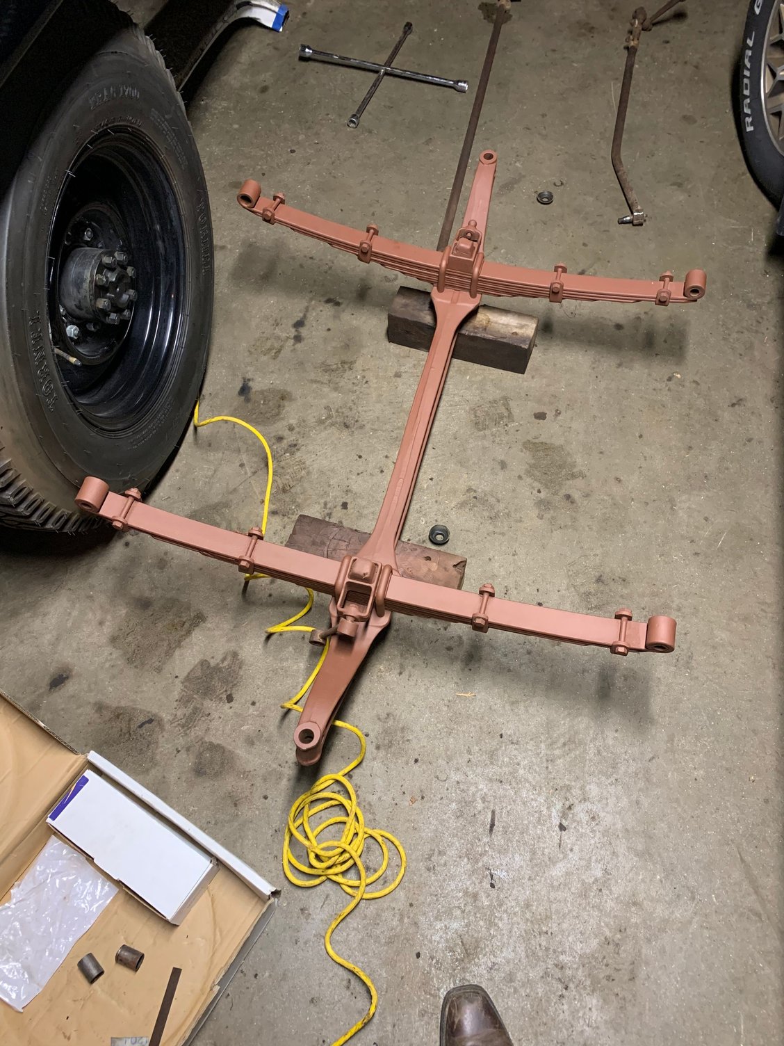

in the spirit of starting other projects I pulled the front axle and cleaned, painted. My spindles are at my friends shop getting reamed/honed for the new king pins.

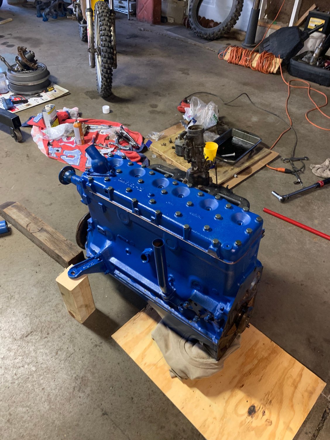

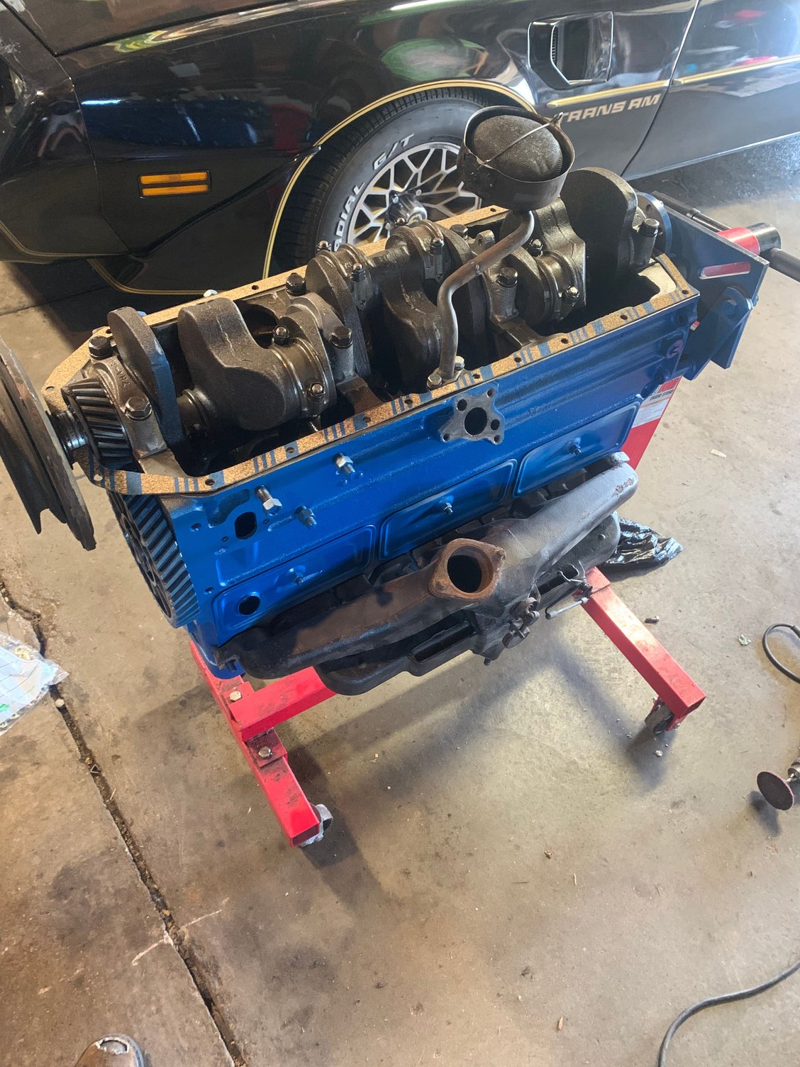

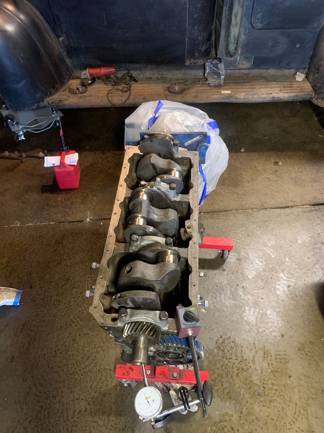

Lastly I got my engine back, got the rotating assembly in except for assembly #6 cause I broke a oil ring. Cam is in along with tappets.. I spent many nights measuring bearings, the main bores, cylinder bores, crank mains, and throws before assembly. 10/10 crank, .030 over, and had the head shaved to bump up compression. Should be a nice mill. If anyone is curious to see what I have in rebuilding this engine I have a spreadsheet…now to the pictures.
Checking endplay
Of course Im happy putting it all back together

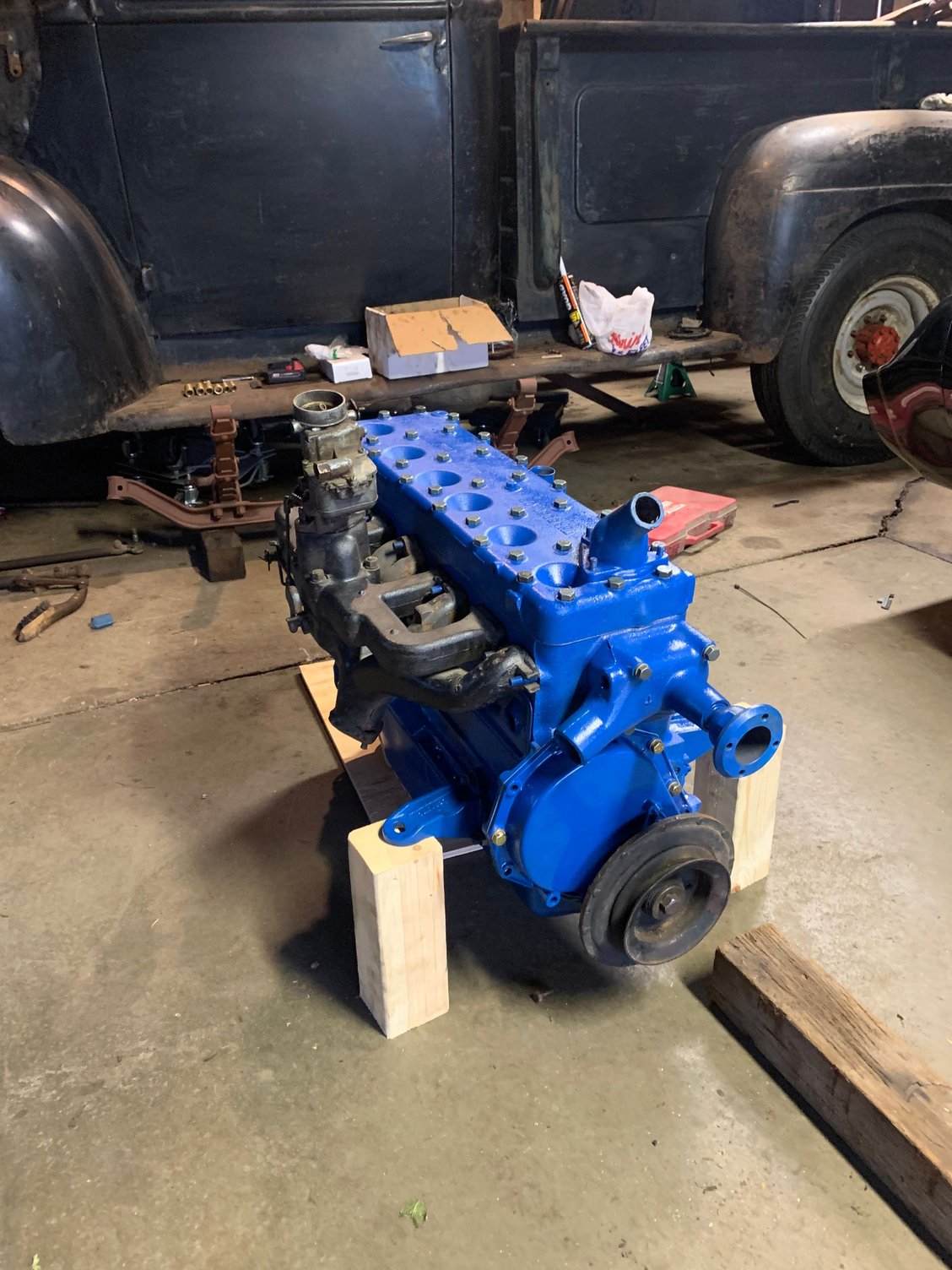

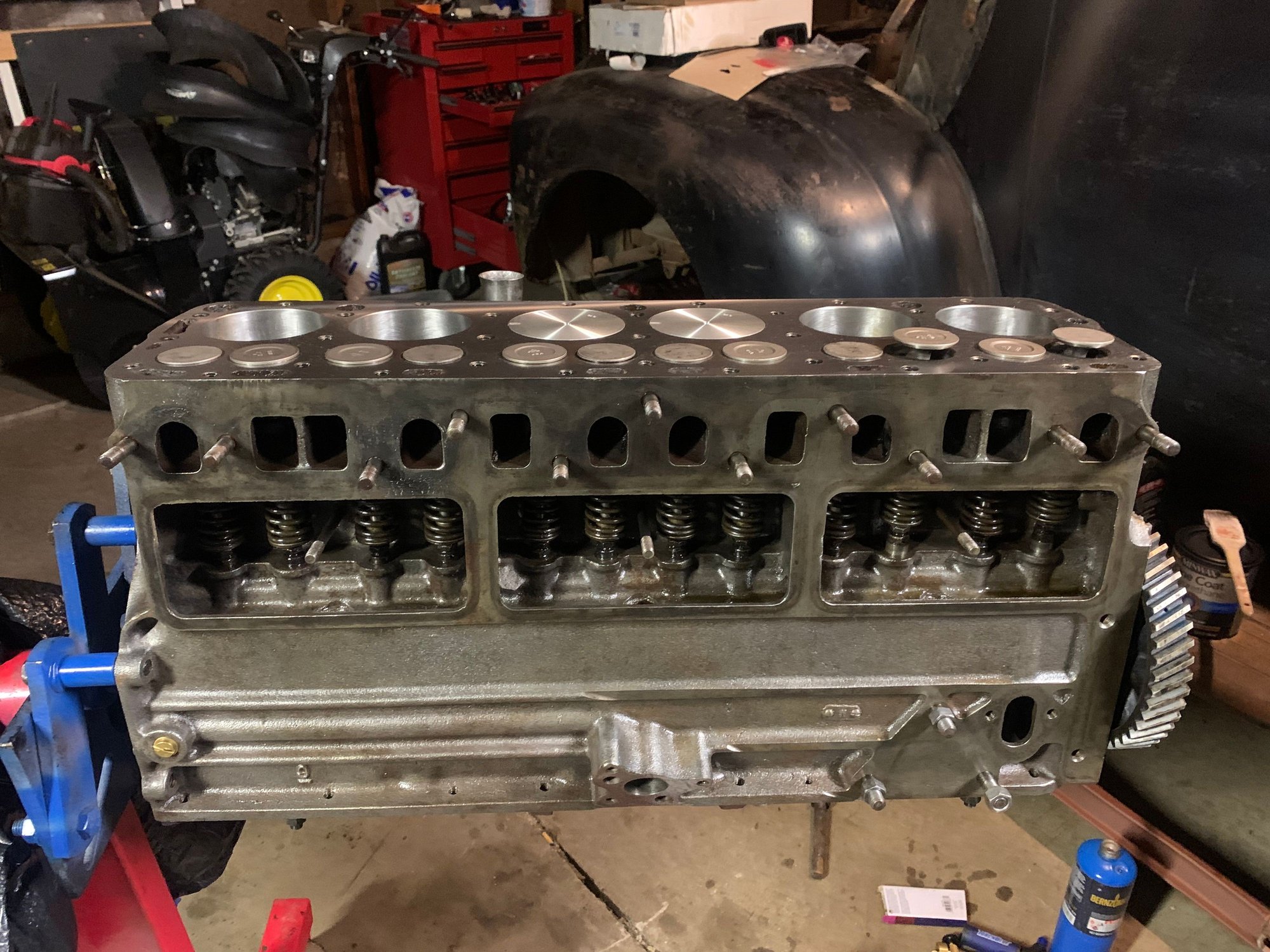

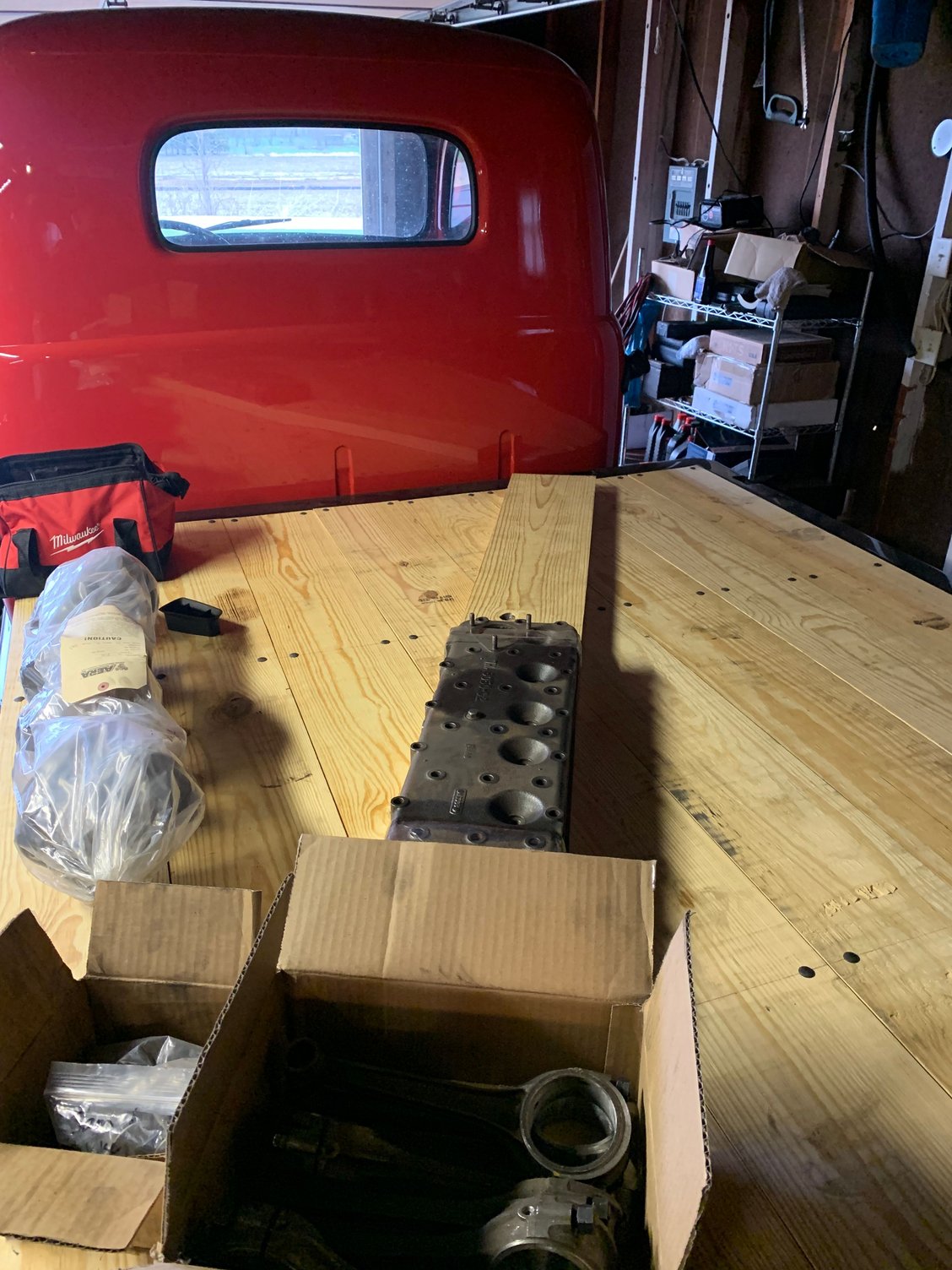

Engine is complete!
I finally got the engine put back together. It went together fairly easily until I found a crack in a lifter bore, which almost derailed the 226 build. After talking to a few straight six guys they assured me to continue with my build as it wont likely affect its performance. Even my machinist told me that, so I said screw it and continued on with assembly. All thats left to do is oil pump, rebuild starter, and find a cheap alternative to the 12v alternator kit thats overpriced with chinsey brackets. im pleased with how the little mill turned out! Just need to paint tranny and button it all back together. Reassembling front axle next, got my bushings, pins, tie rod ends etc…
