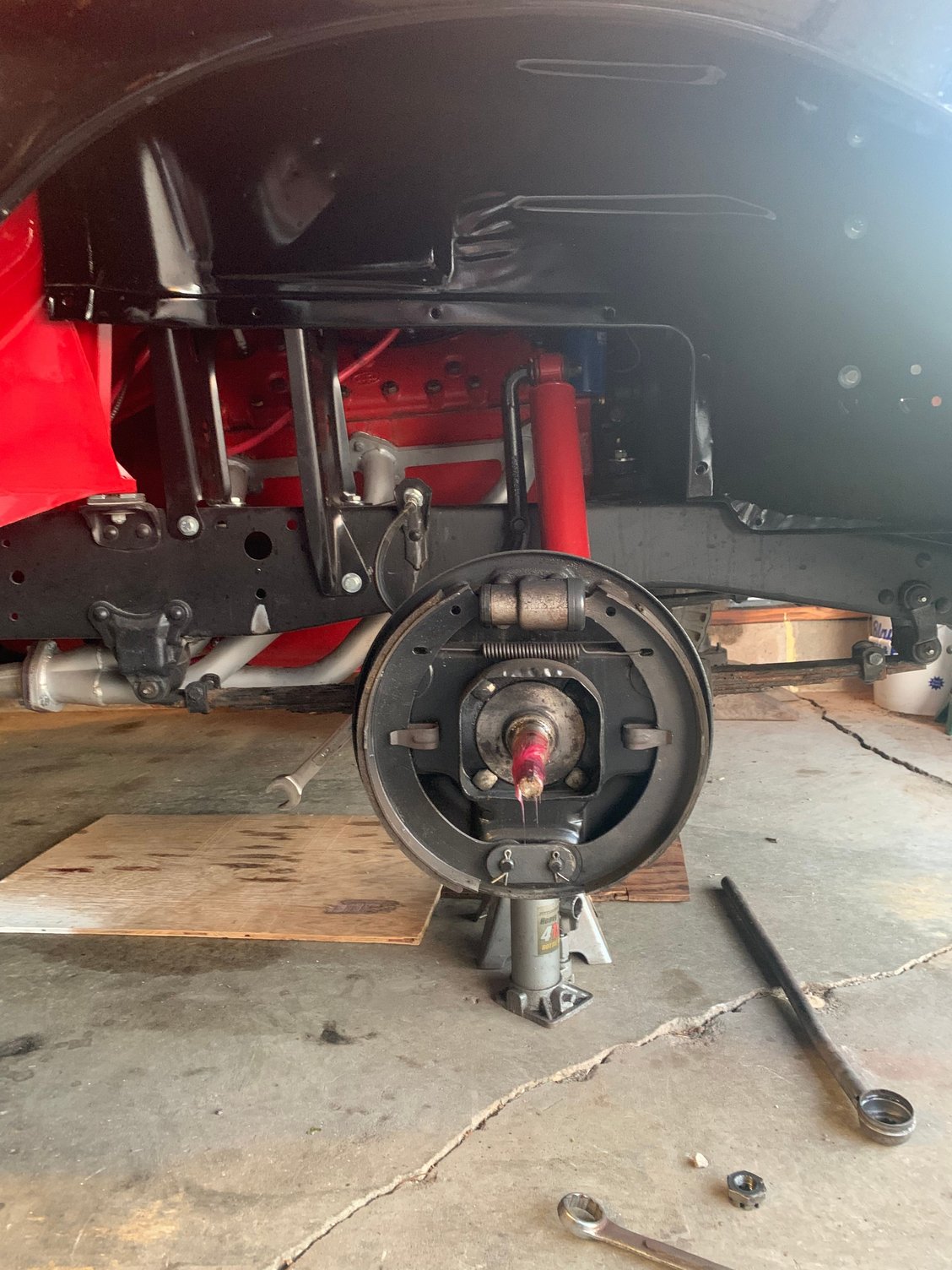

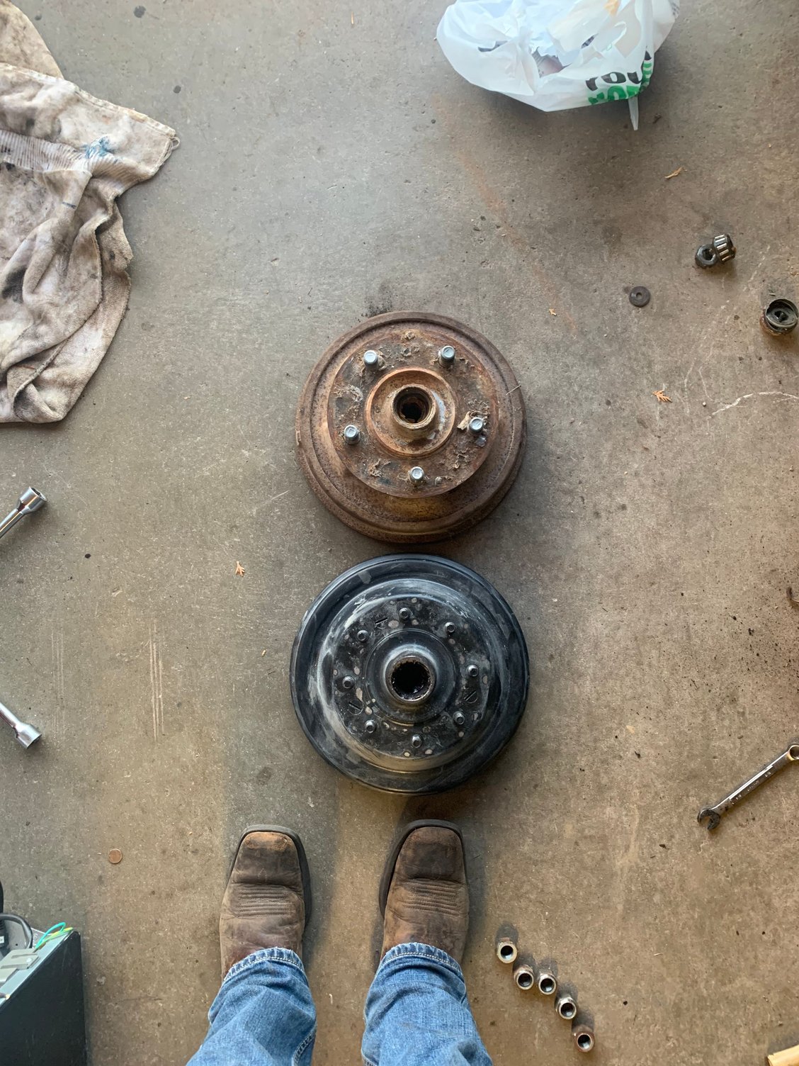

Yup! for the sake of simplicity in the rear I’ll be using my dana 60 in stock form, utilizing 16” 8x6.5 wheels. Don’t plan on using the 5 lug wheels and equipment. I’m going to pull the front drum/hub off my F3 and see how it fits on the 47’ spindle. Then I will go from there. Love a challenge

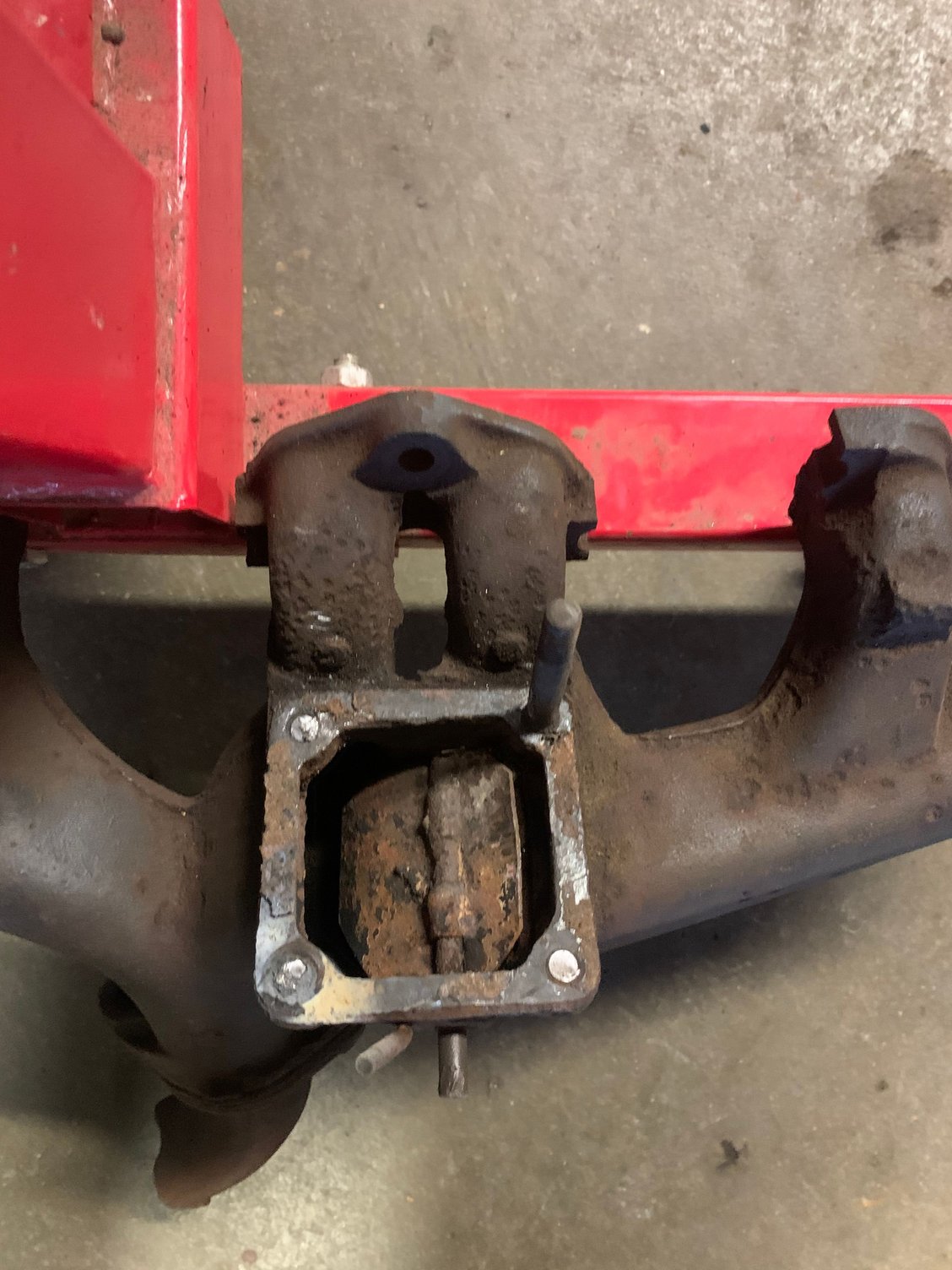

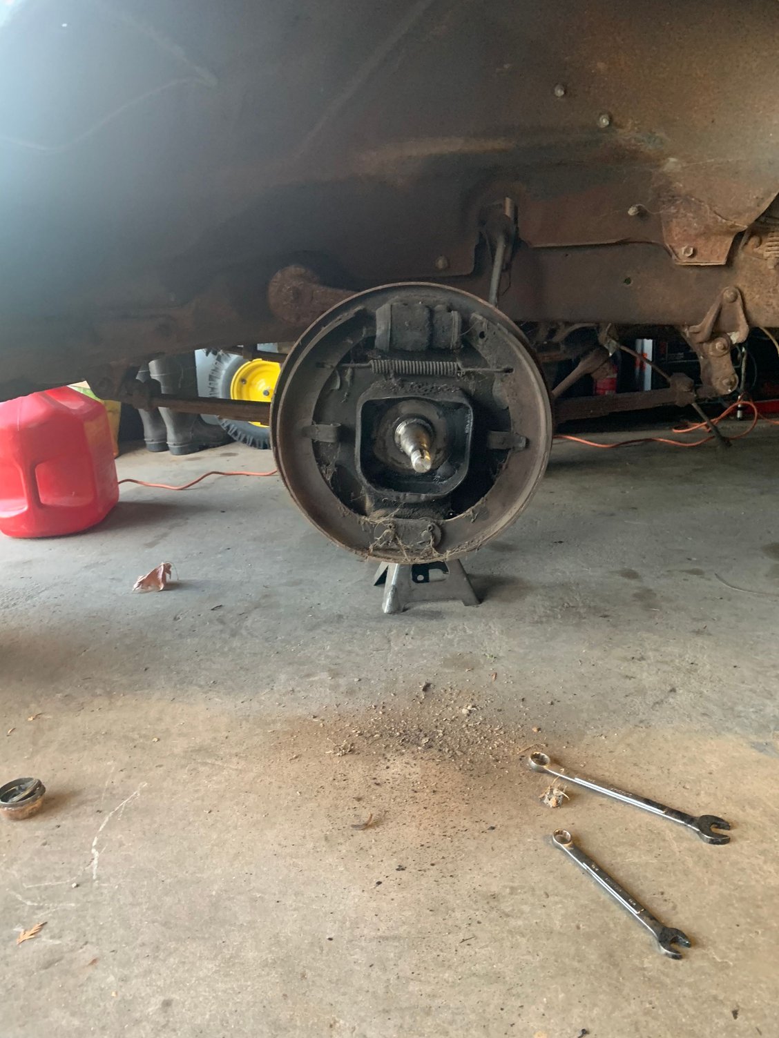

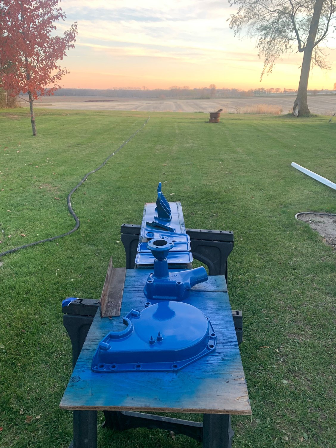

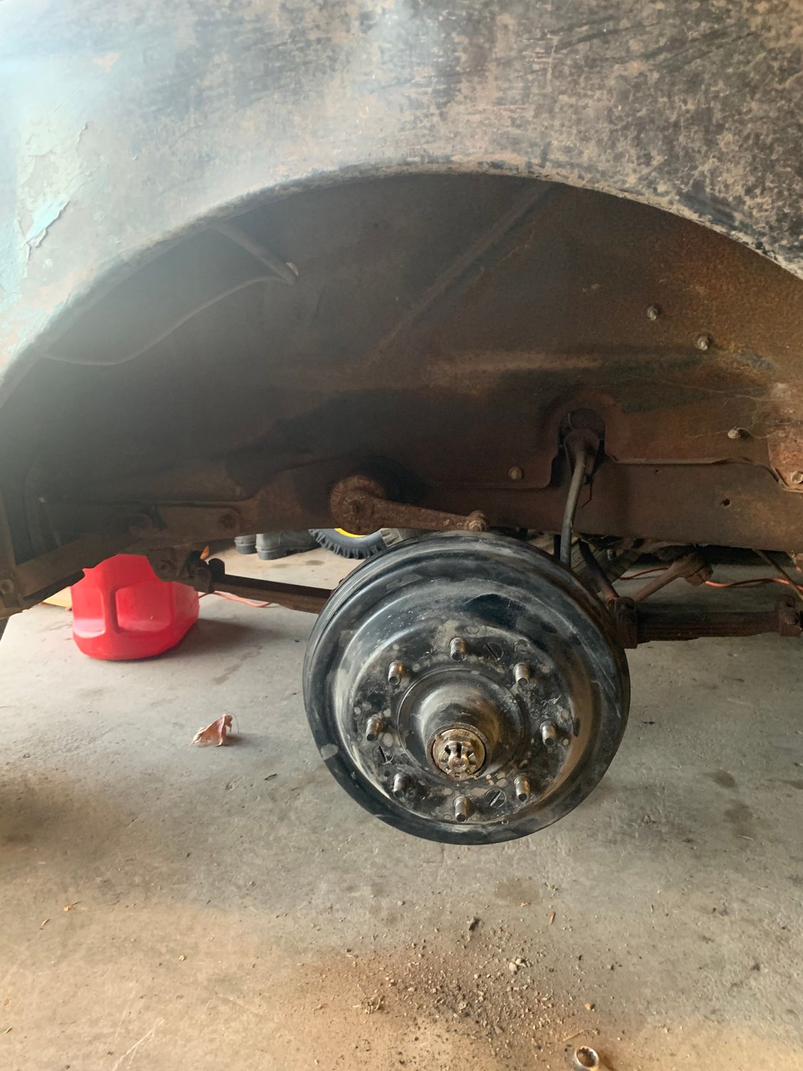

I finally got a day off - which meant the whole day was devoted to working on the tonner (nothing else I’d rather do). We were lucky to have a warm day here in Iowa so I was able to get some more painting done on engine parts. Sadly I didn’t accomplish a whole lot and I’m still waiting on gaskets for the 226…I also managed to break off the studs in the exhaust manifold so I have some more work cut out for me! I ended the day test fitting a hub from my 50 F3’ onto the 47’…well it looks like we have a match! The F2 F3 hubs do in fact bolt onto 47’ spindles. Even got brake engagement! And I couldn’t resist…I had to bolt on an F3 wheel with 7.50x17s. I think wheels and tires can make or break these old trucks…time to track down some f3 hubs and drums

GB - it’s a difficult decision to stray from the original 17” wheels. I love the look and I’m a little sad to see them go but for what I want to do with the truck I gotta make the switch to get the 3.73 final drive ratio as I hope to spend a lot of time out on the highway. I also wanted to retain the original 4 speed as that’s another part of these old trucks I love - double clutching is fun I’ll admit it. My F3 has the stock axle and she winds up pretty good in town.
Since I am making the switch to 16s tall skinny bias plys are a must to keep the original feel and ride of the truck alive. But yes the 8 lug drums fit the tonners shoes from what I can tell…now I’m curious if 53’-56’ drums/hubs are the same?? I was able to adjust the cams and get brake engagement and both sets of shoes measured 1.75” wide. I will most likely try to have shoes arc ground to whatever drums I source If they are in decent enough shape.

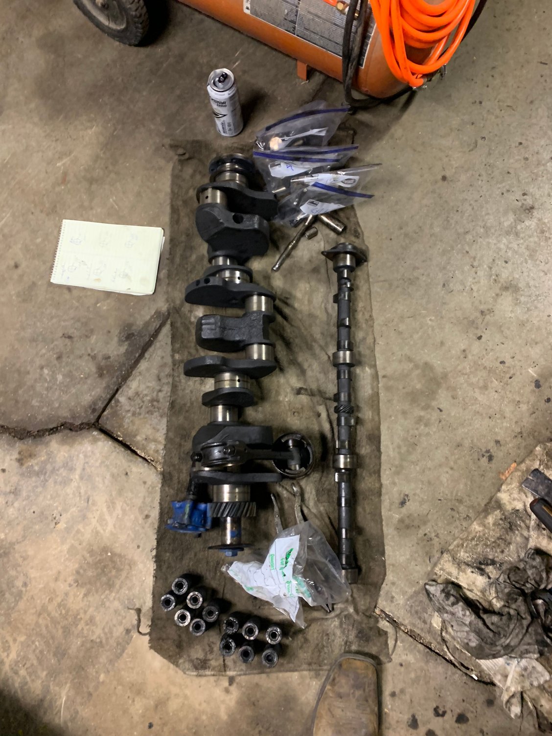

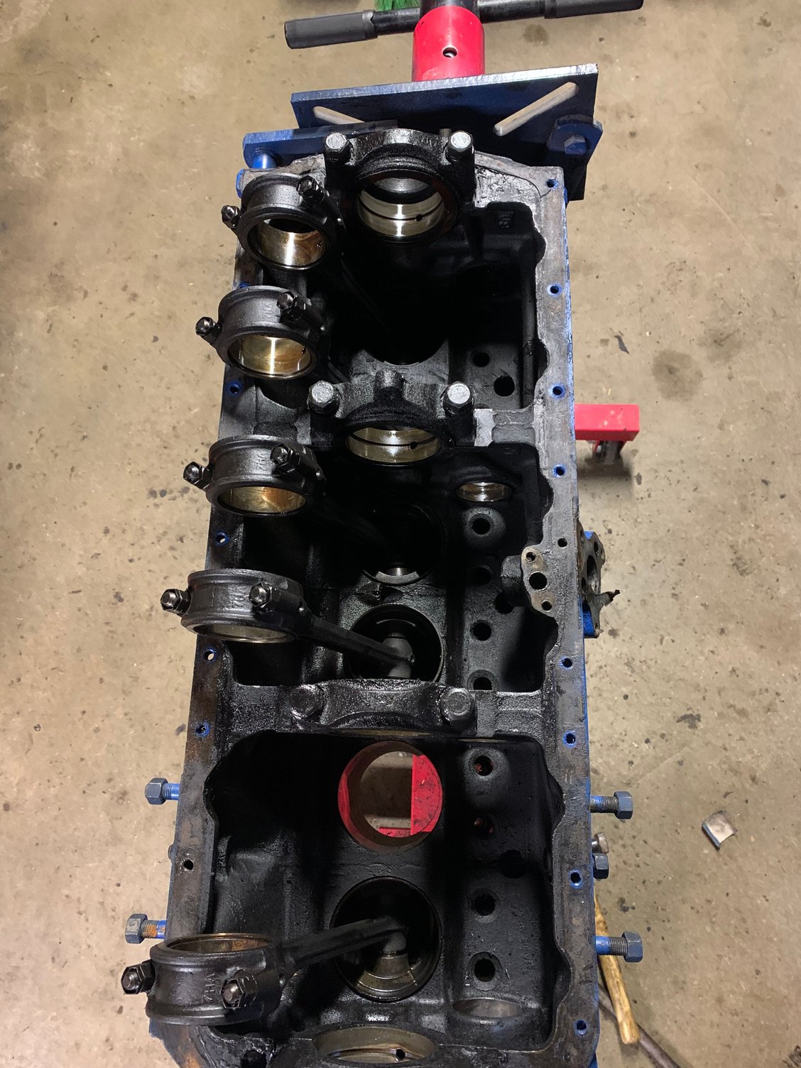

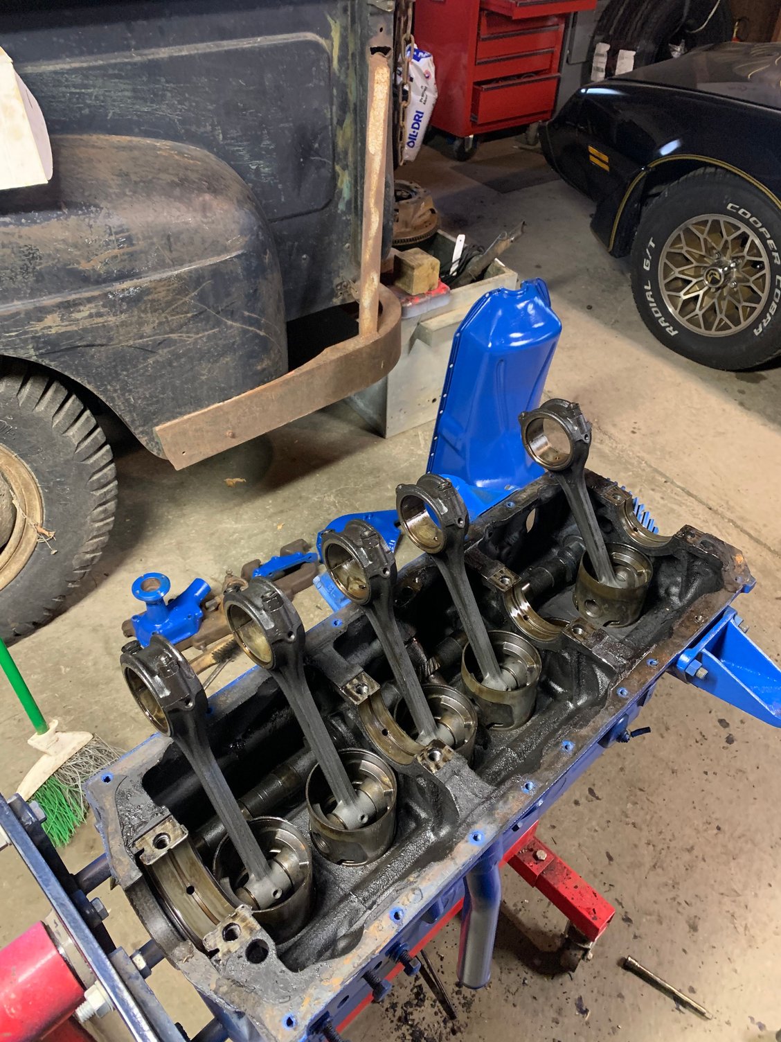

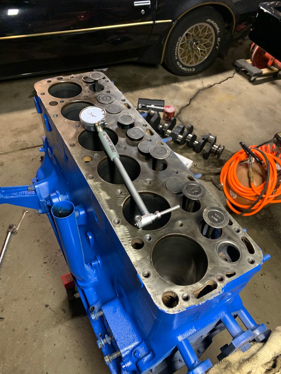

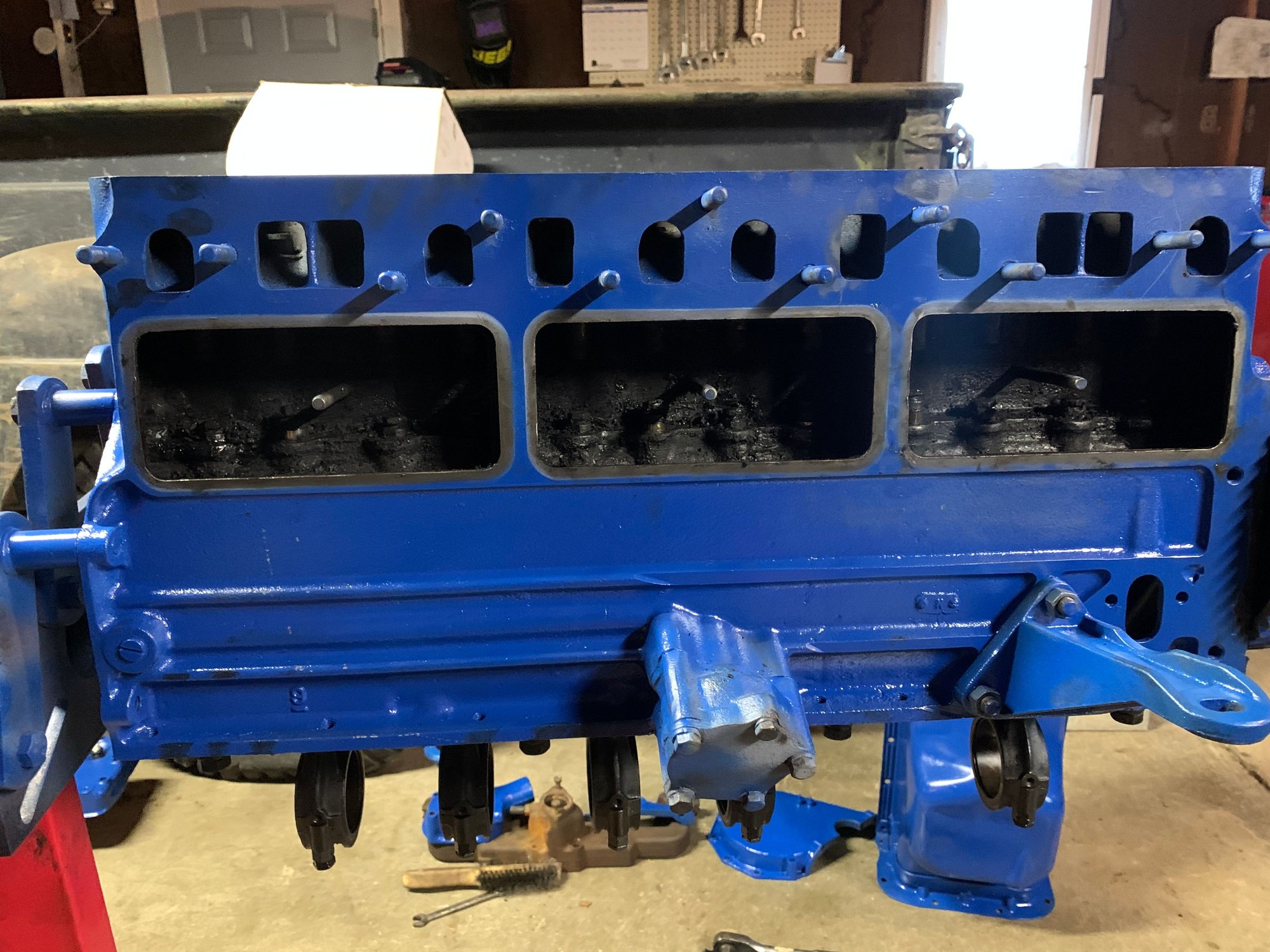

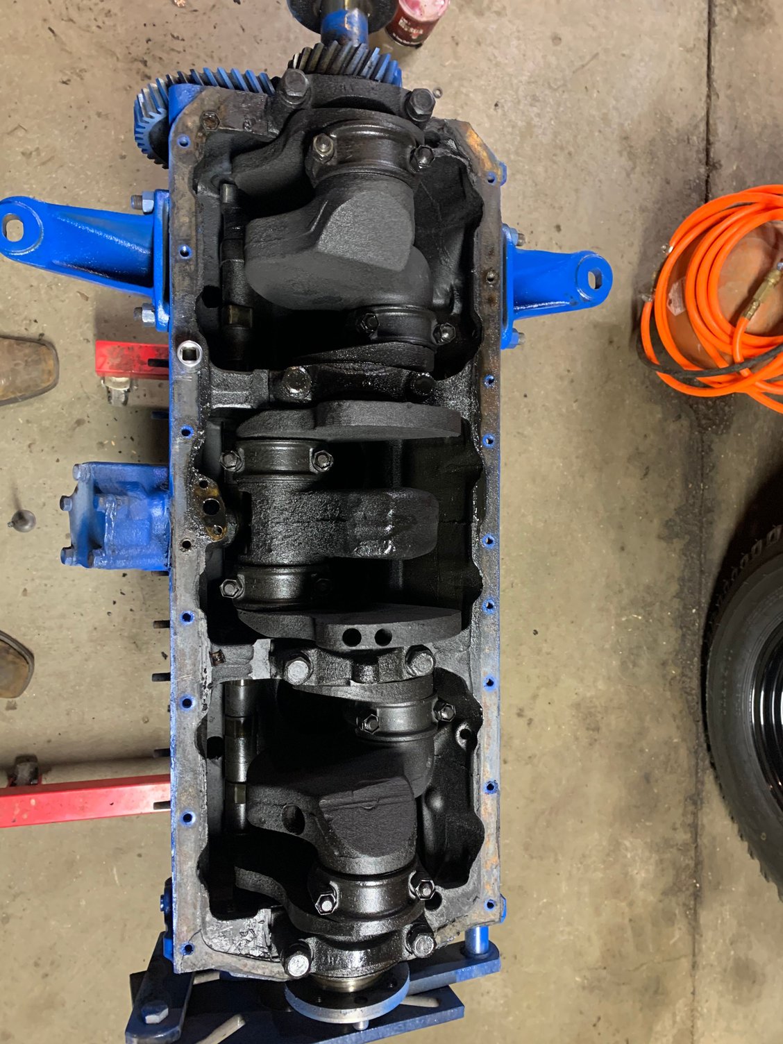

Well I did a bad thing this weekend. I actually brought out the dial bore gauge and a micrometer and measured my bores again. I decided to take the plunge and tear the engine down. The 48-52 shop manual states that any bore taper .015 can be cleaned up with a hone. Most of mine checked out from .008-.011. Which probably would be fine with a hone. I’d probably been fine running the engine like that. However given the fact the engine is out of the truck and I haven’t invested any serious coin into it other than spray paint and my time I decided I want to do it right. I’ll be taking the engine to the machine shop hopefully this week to have it hot tanked and bored. Possibly have the crank ground and new cam bearings. Ultimately I want to daily drive this truck and I’d rather do it right the first time than do this all again in 2 years when this thing seriously starts smoking. And I’ll have one healthy 47’ pickup that I’ll have confidence in on some future road trips. The cool thing is this engine is stock. 3.30 bore - doesn’t appear this things ever been rebuilt.

Good move. Not only are you investing in the engine… but peace of mind knowing it’s right.

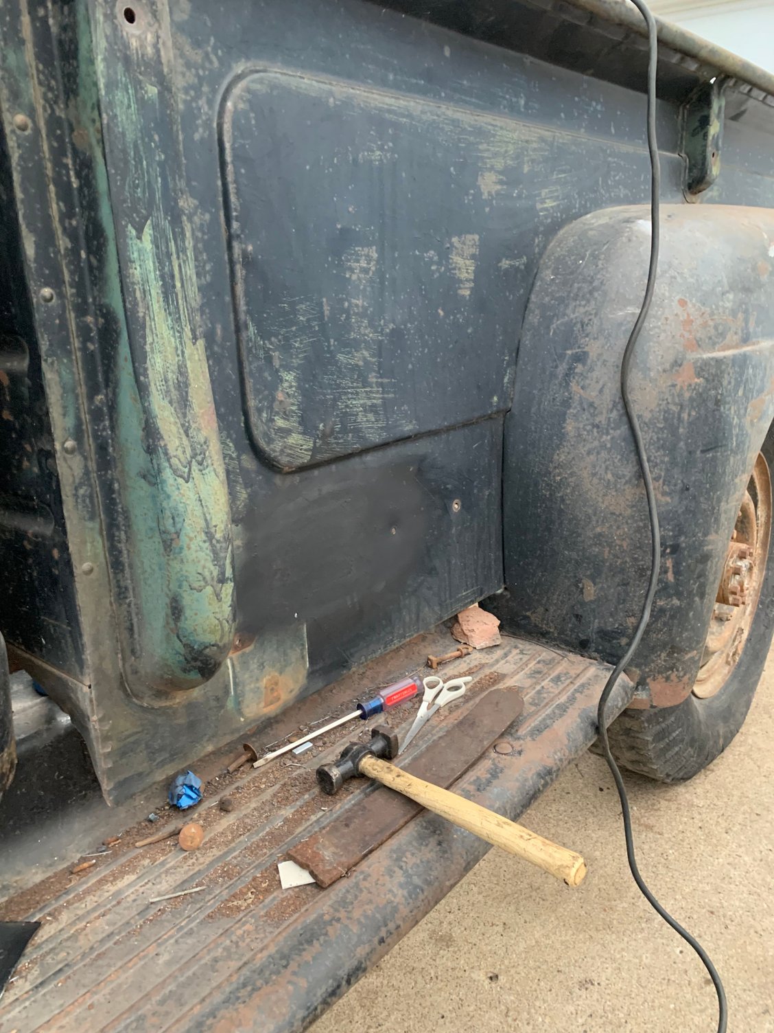

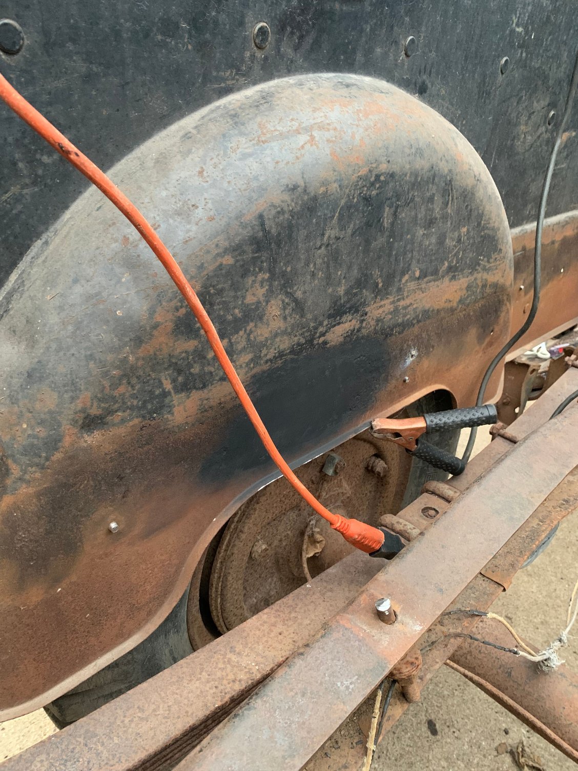

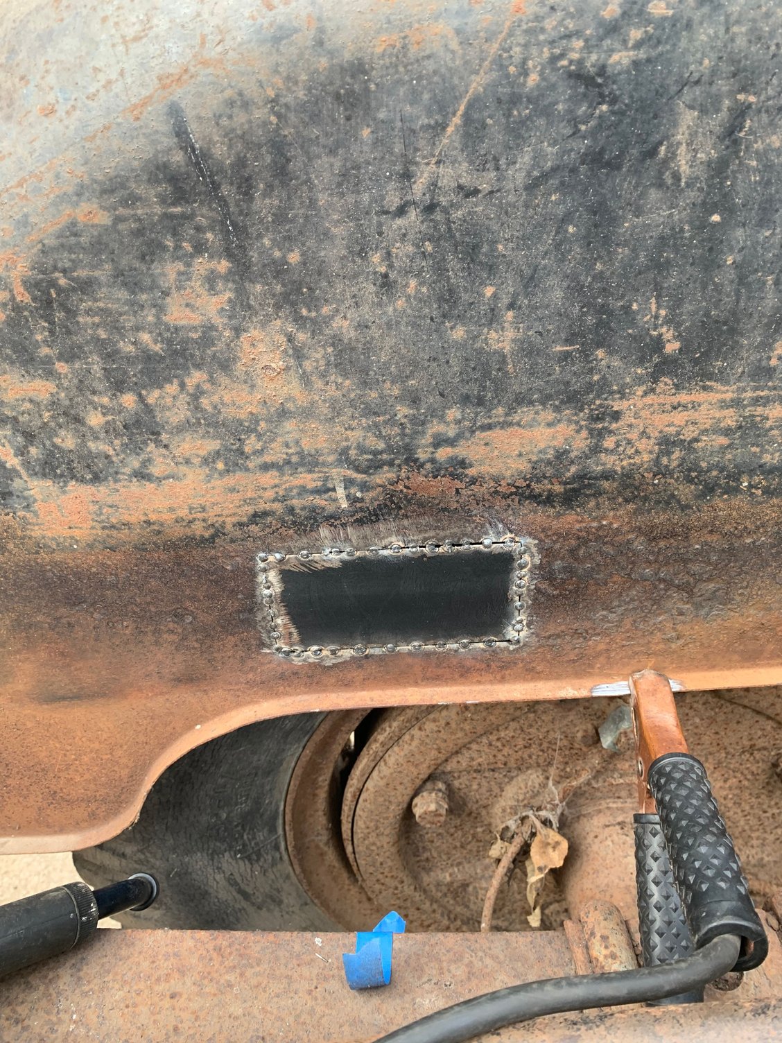

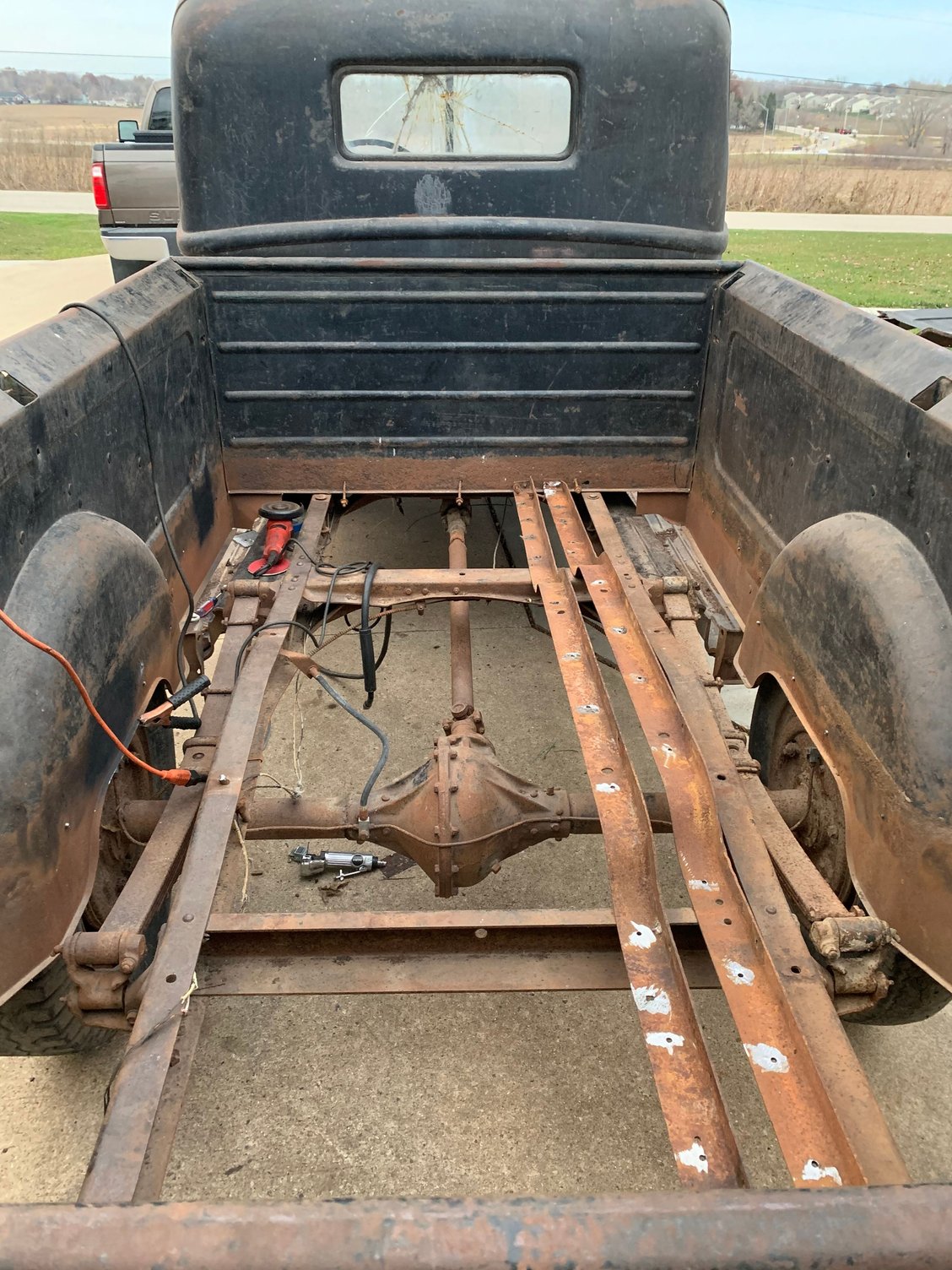

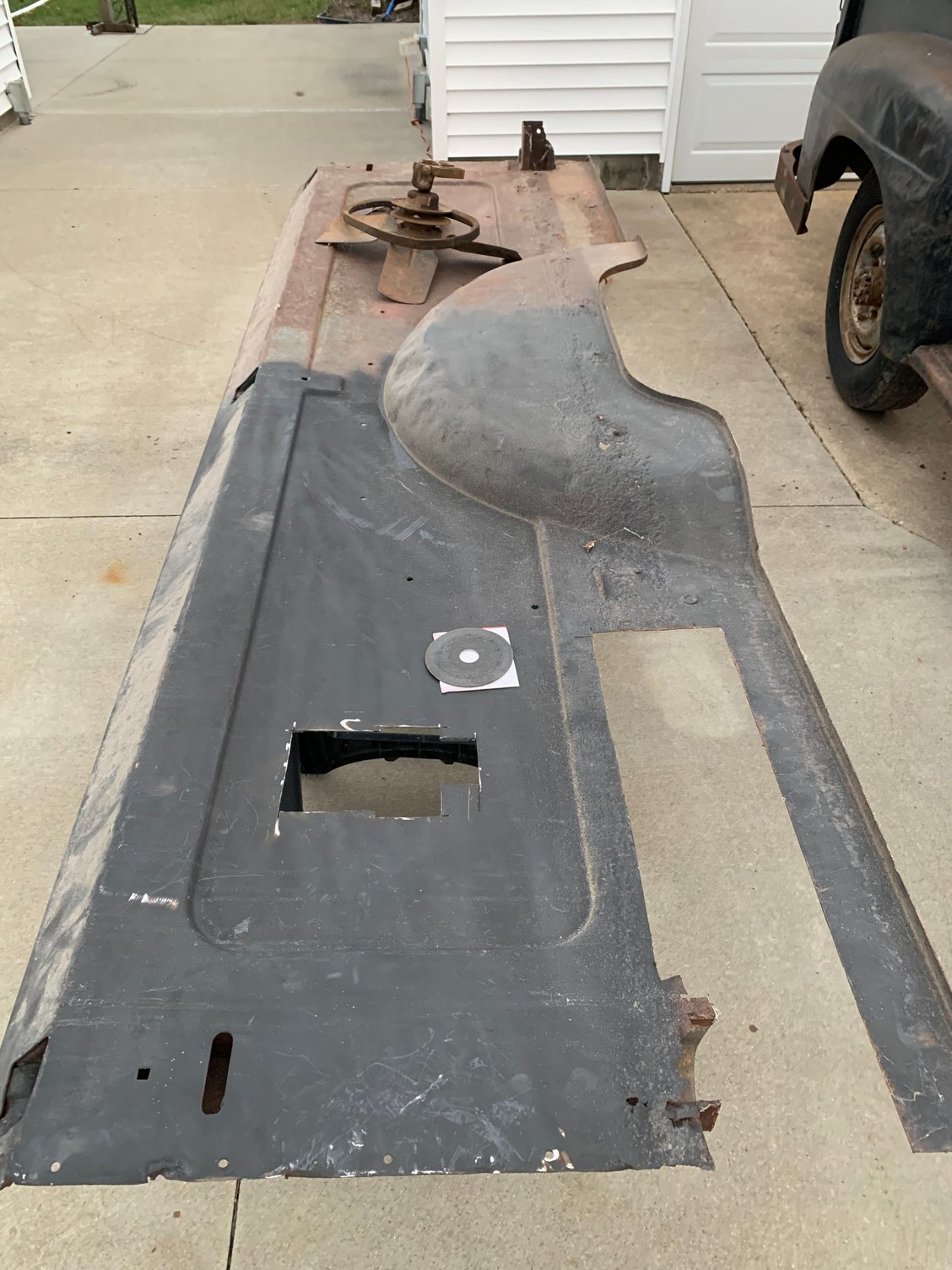

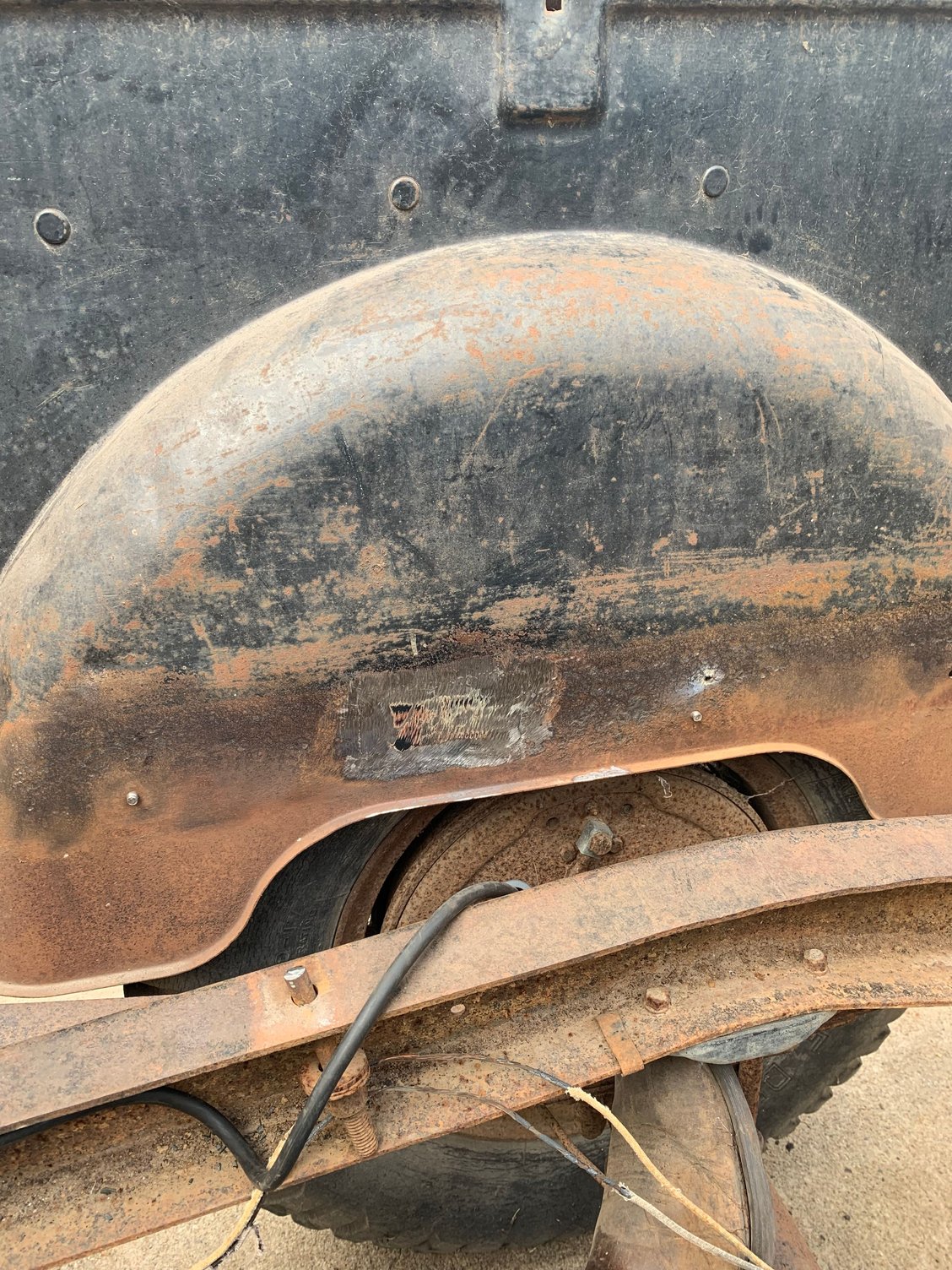

I took this week off to get some stuff done around my house, ended up working on the truck all week. Seems about right. Anywho I dropped the engine off at the machine shop on Monday afternoon, sounding like I won’t see it till after Christmas. That’s okay, plenty to do. Tuesday morning I drug the heep out of the garage and started in on the bed. I took off the angle on each side of the bed so I can clean up some rust in there. I ended up getting two panels patched, still have 3 more to do. Once I’m finished I’ll paint the angle iron, bed sides and reinstall. Remember guys, I’m building this to be a workhorse not a pebble beach truck so my patches aren’t the prettiest but I can guarantee this thing will outlive me (I’m 25 so that’s saying something)… have a happy thanksgiving everyone!
sam
I found a panel in my stash for patches

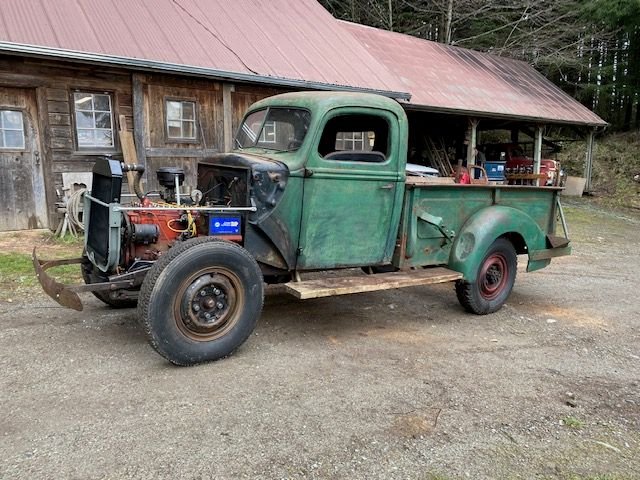

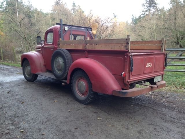

I'm into a couple of kitchens too.... That's my work, so after work I gotta get greasy. This is my 46 tonner that was a parts truck, but I had a sweet running H six and some winter nights so I've been building it back up. It isn't as nice as yours, but the red one is clean like yours. That has a small cyl cummins6 cyl turbocharged generator engine in front of a GM sm 465 I did 2 winters ago.
