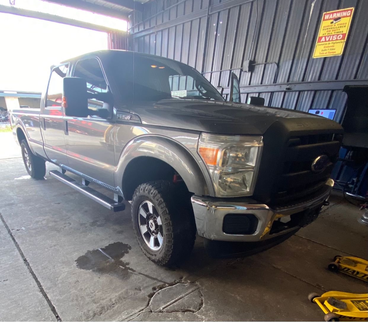

You want a 2013+ 6.2 gas.
If Ford will ever pick up my CCLB 7.3/4.30 F350 order I am selling this 2013 F250 with 87k miles on it in the low-mid 20s. Even has a decent set of goodyear duratracs on it. Everything works and only issue is the driver’s seat has a rip in it. I feel that you may need to look outside of your area and work a deal out.
