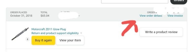

Were they sold by Amazon LLC or a third party vendor on Amazon?
I too bought GP's from Amazon, but it was 3 years ago and they were sold by Amazon LLC. They were in fact genuine Motorcraft/Beru GP's.

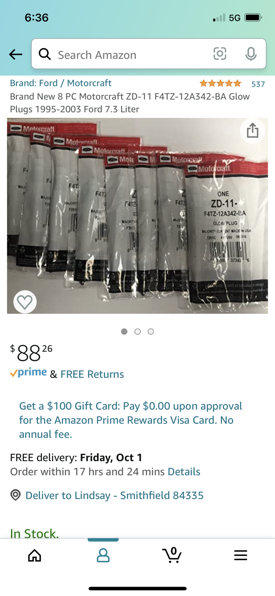

Thanks! I found it. Here’s the link to the ones I ordered:
Brand New 8 PC Motorcraft ZD-11 F4TZ-12A342-BA Glow Plugs 1995-2003 Ford 7.3 Liter
Amazon Amazon

The link you posted indicates they are sold by "Auto Parts Wholesale", that means nothing though as the link could have changed over the past year.
Go to your orders and search for glow as you probably did before, then click on "view order details" in the top right if that section.
Once you select that, another screen will come up and it will state who the seller was where Amazon LLC is seen below.
Although this is a good sign, it is NOT definitive and the GP's should be inspected and evaluated in order to be sure. This is an easy task if you are going to do the cups anyway.

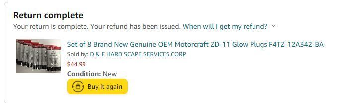

I made the mistake of buying glow plugs from Amazon....turned out all 8 were DOA. I got my money back, but I had installed all 8 before realizing they were crap. They had a silvery looking paint on the glow portion of the plug, other than that....they looked like legit plugs. Amazon refunded my $ and closed the sellers account, but I'll never use Amazon again for that kind of stuff.
Here I thought saving a few bucks was a good thing......nope, cost me more time than it was worth. I buy from RiffRaff now.
