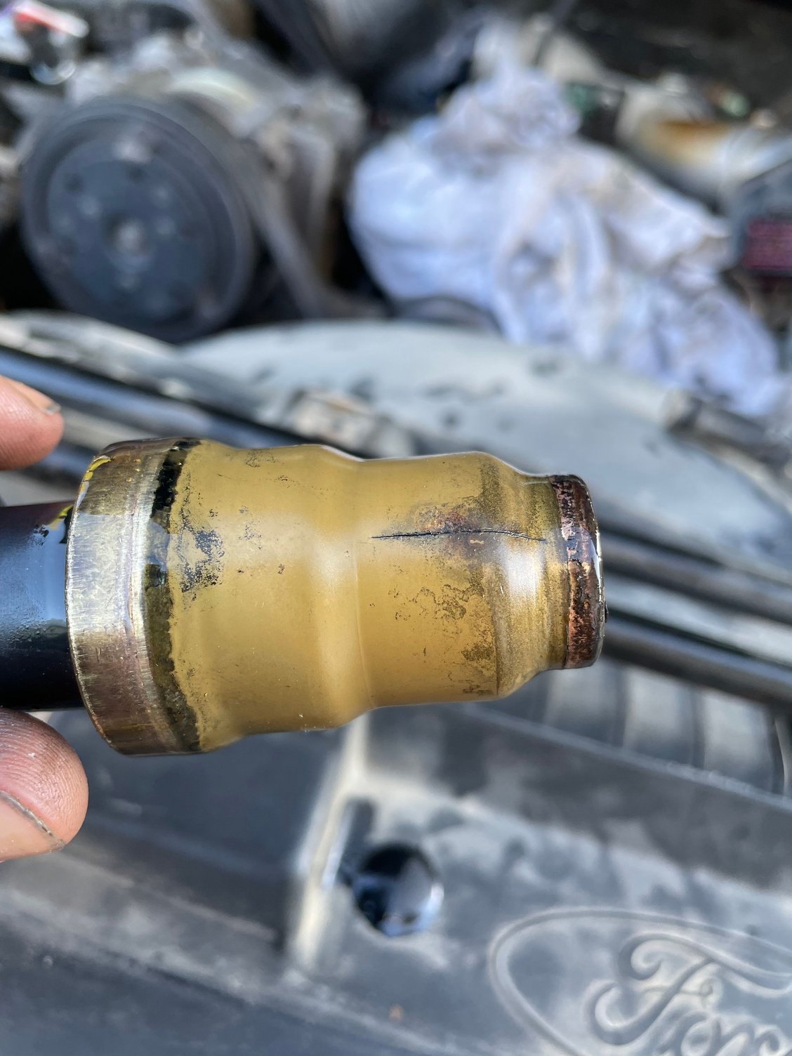

I replaced the uhvc gaskets a year ago to the week. Ford was out of stock so I went with NAPA because I had to get the truck on the road.
Well here’s the verdict…. No bueno!

GPs look authentic with the flat spots just below the top. Do you think NAPA would replace the UVCHs? Not sure I would want them though, maybe a credit towards future purchases. They should last longer than one year. Got your NAPA receipt?

This is what my dormman gaskets looked like after 2 years. Installed by a shop in CO while I was back home in MO. Cracks and splits just waiting to leave me stranded again.

Three were cracked

The thing I don’t understand is how three were cracked but none of them looked like fresh cracks. Also I have a hard time believing all three cracked bad enough to leak all at once. Oh well hopefully the new cups install easily and seal good! Bores look good and I’ll wipe some acetone in the bore to clean them up good before driving in the new cups.
