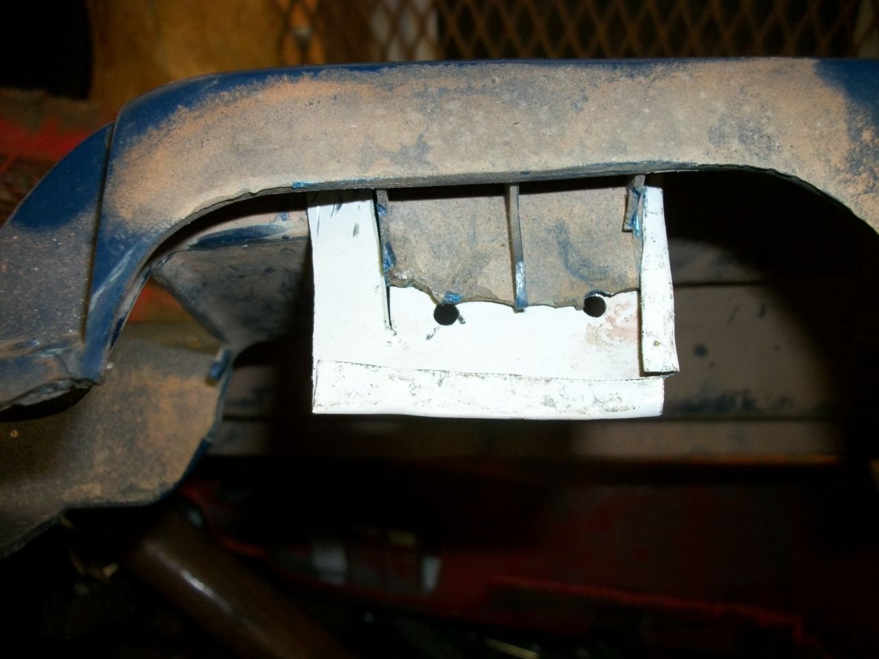

If you have a broken plastic piece under the finger cups, you can make a s/m overlay easy enough. JB weld holds it good.
For those of you that are missing that piece of plastic....improvise, adapt, overcome.
If it has a crack just make the overlay. Even if it is fine, make the overlay to reinforce. This area takes all the door slamming power from your friends. And get some metal finger cups from LMC. https://www.lmctruck.com/1973-79-for...handle-cup-set
