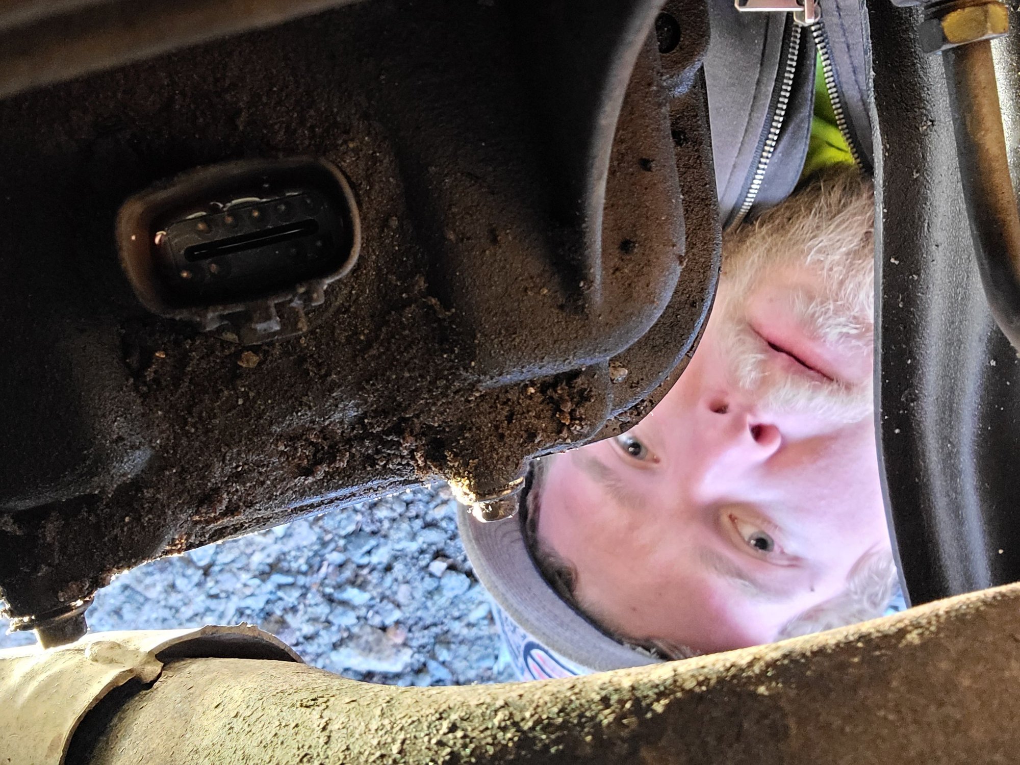

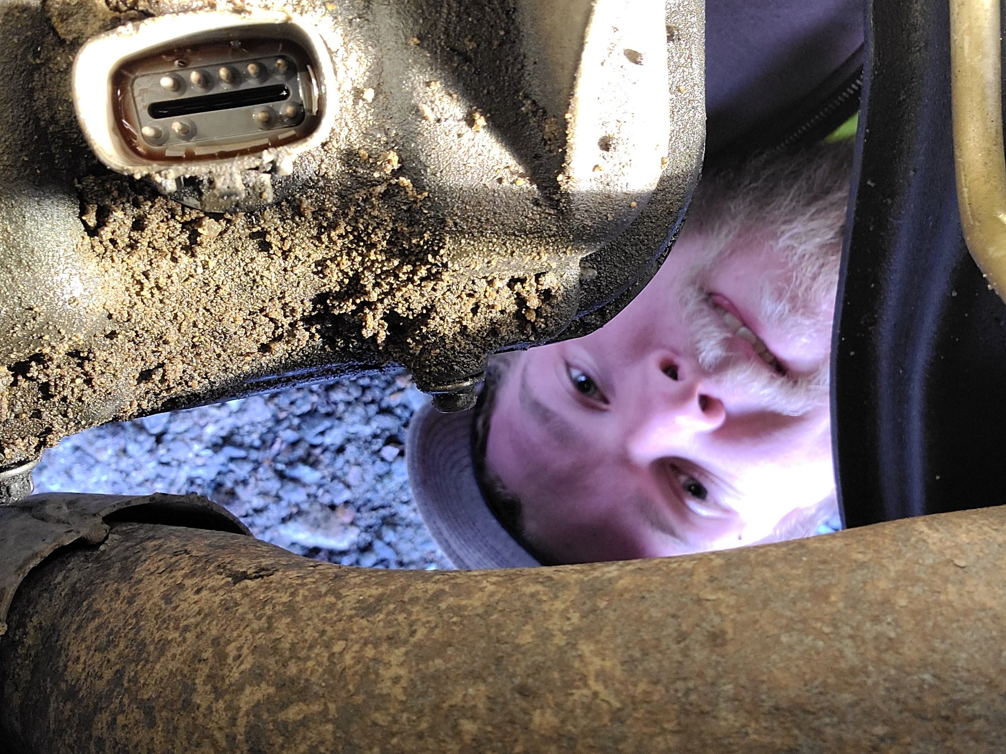

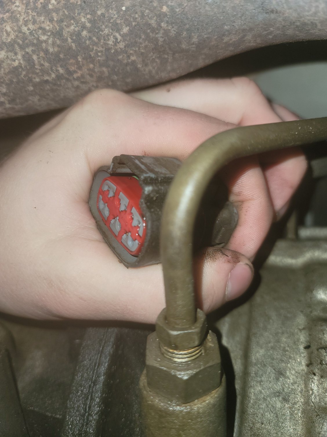

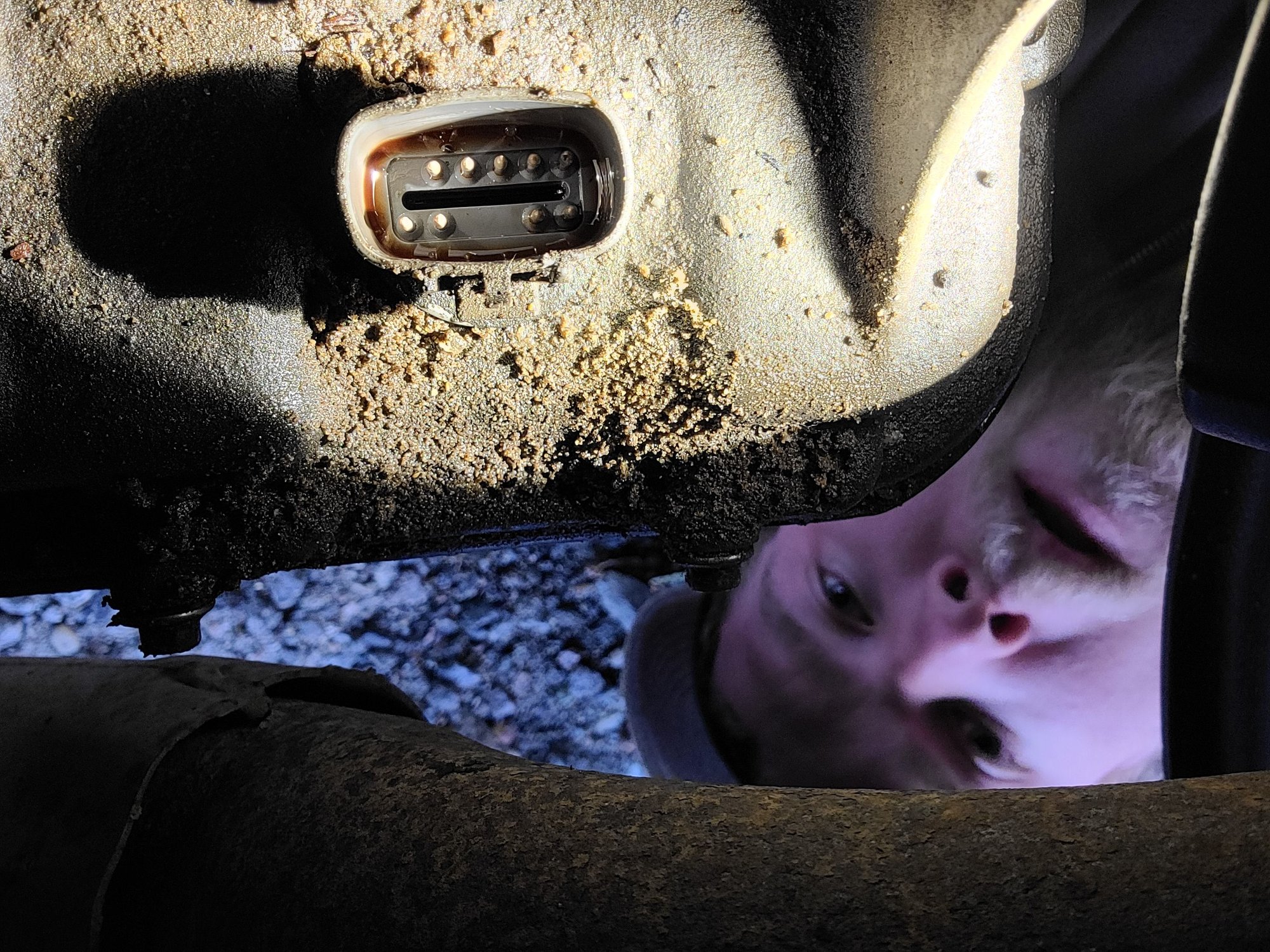

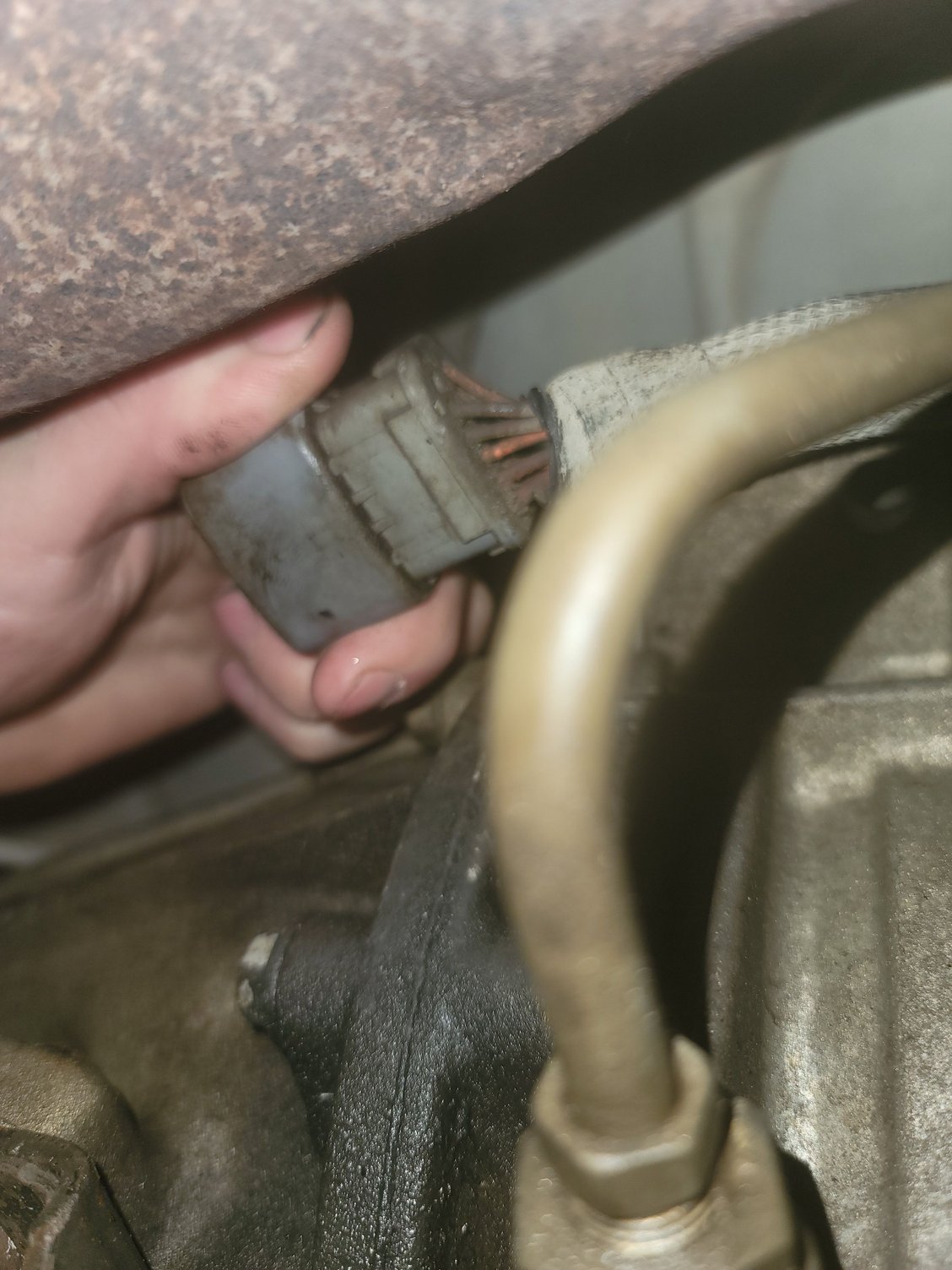

Okay. Pulled the plug. Huge pita, glad y'all didn't tell me that in advance.
The plug itself looks fine, wires aren't cracked at the base like some photos I've seen.
Bad news. It looks like there's ATF in the plug. I've seen this is bad, but what's the fix?
Pardon my ugly mug in the photos, it was hard to get a camera up in there.

Crap! that is bad, not talking about your mug...

Sure looks like the seal in the connector has failed. I think the solenoid will need replacing but I don't want to make that call. We need a transmission expert for advice.
