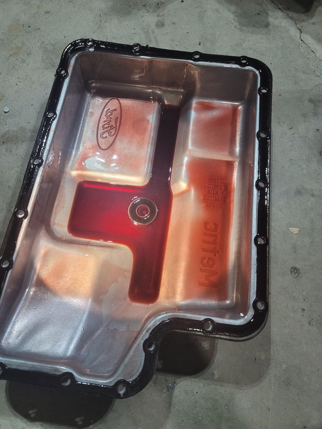

Originally Posted by jerryparks
Removed the pan today. Good news, I think. Fluid looks clean, and nothing crazy in the pan I don't think. Anything look off to you guys?
Pan looks good.
