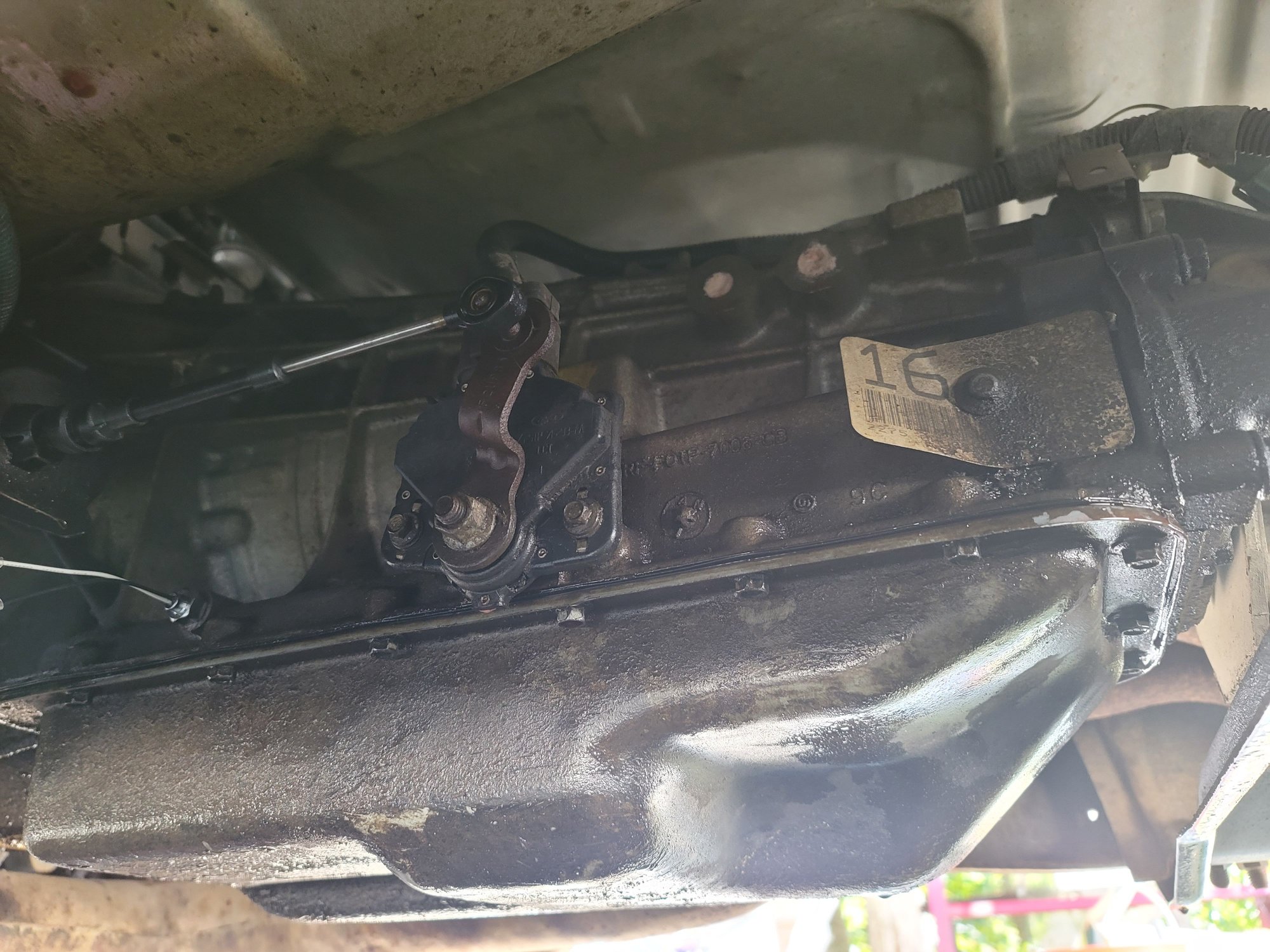

Federal emissions
No OBD-2
MLPS
MLPS, but from a different angle.
