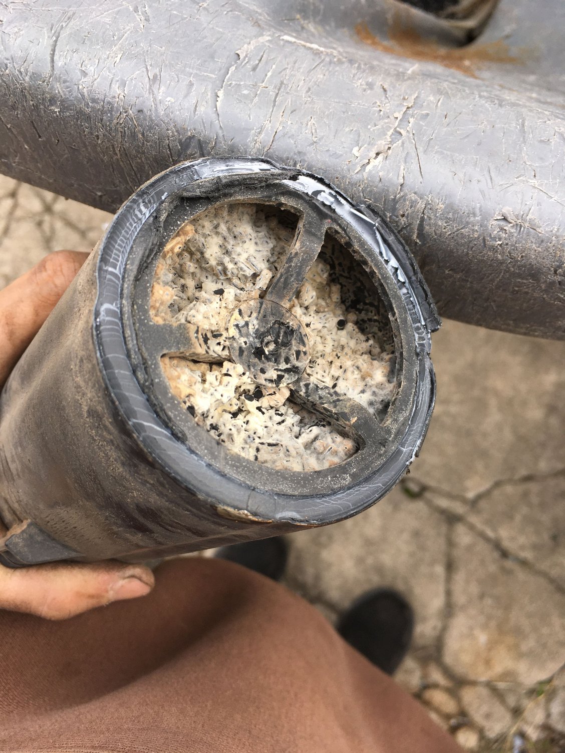

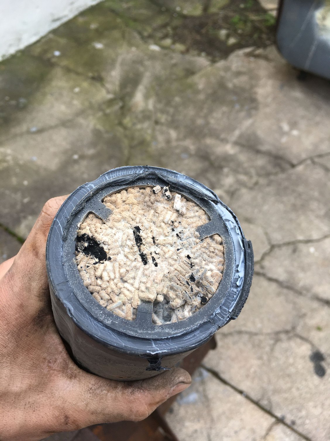

Welp... think I found my evap issue. Curious as to how this happens? Would this of been from water getting in the system or the truck running too rich? Only the one side of the canister was clogged (hose that runs from canister to vent solenoid) the other was perfectly fine.
