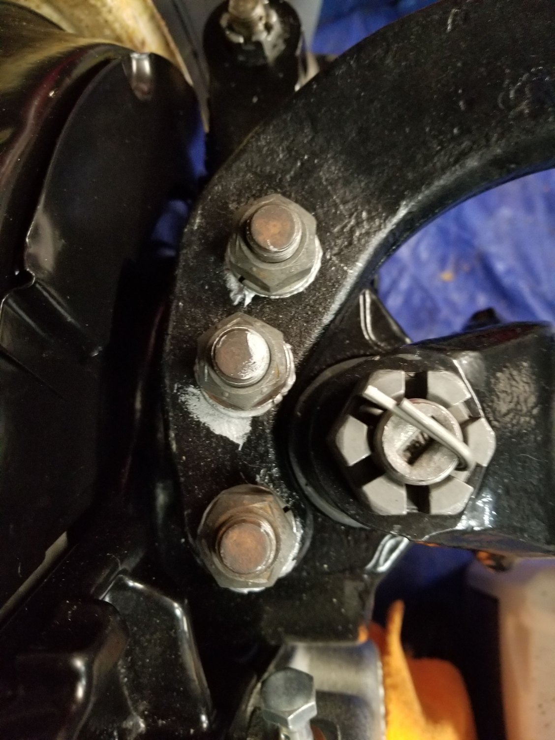

Are they like 1/2" diameter course threaded studs?
Old Sep 21, 2021 | 09:56 PM
thatsrealnice's Avatar
thatsrealnice
Joined: Oct 2009
Posts: 874
Likes: 56
From: Merlin, OR
Nuts
Yeah. All cinched up and axle back under frame.
