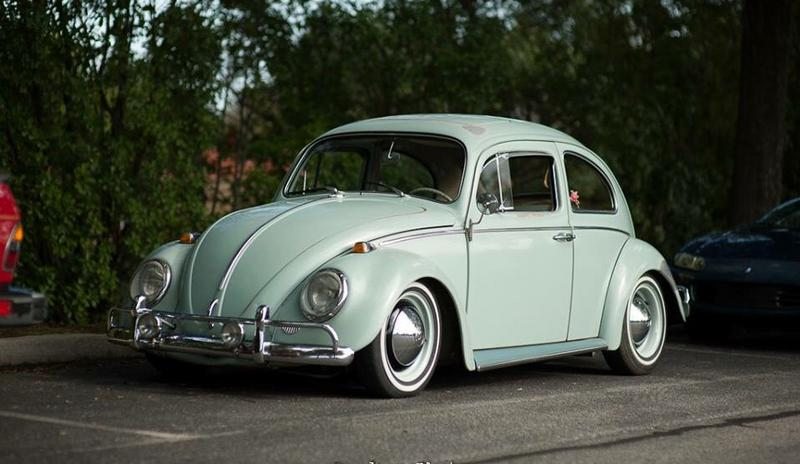

I've used SEM and SM Arnold on personal cars and both have worked well and held up for years of use. The part must be extremely clean, I use a red scuff pad and either blue Dawn detergent or Purple Power and hot water to scrub the part to degrease and prep it for spraying. SEM can be custom mixed if they don't have a can with the color you need. I dyed the running board covers on my '64 VW using custom mixed SEM to match the original color back around 2002 and they've held up very well.
Attachment 279350
Also used it to restore faded and scuffed plastic interior parts.

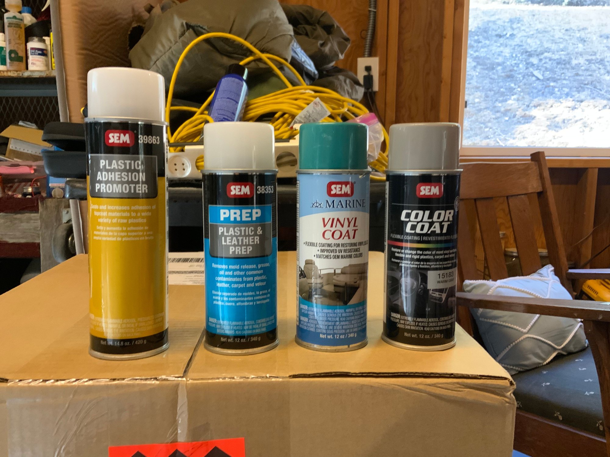

Al, SEM is probably the most widely available of products designed for this use, and probably the best. These are what I have used:

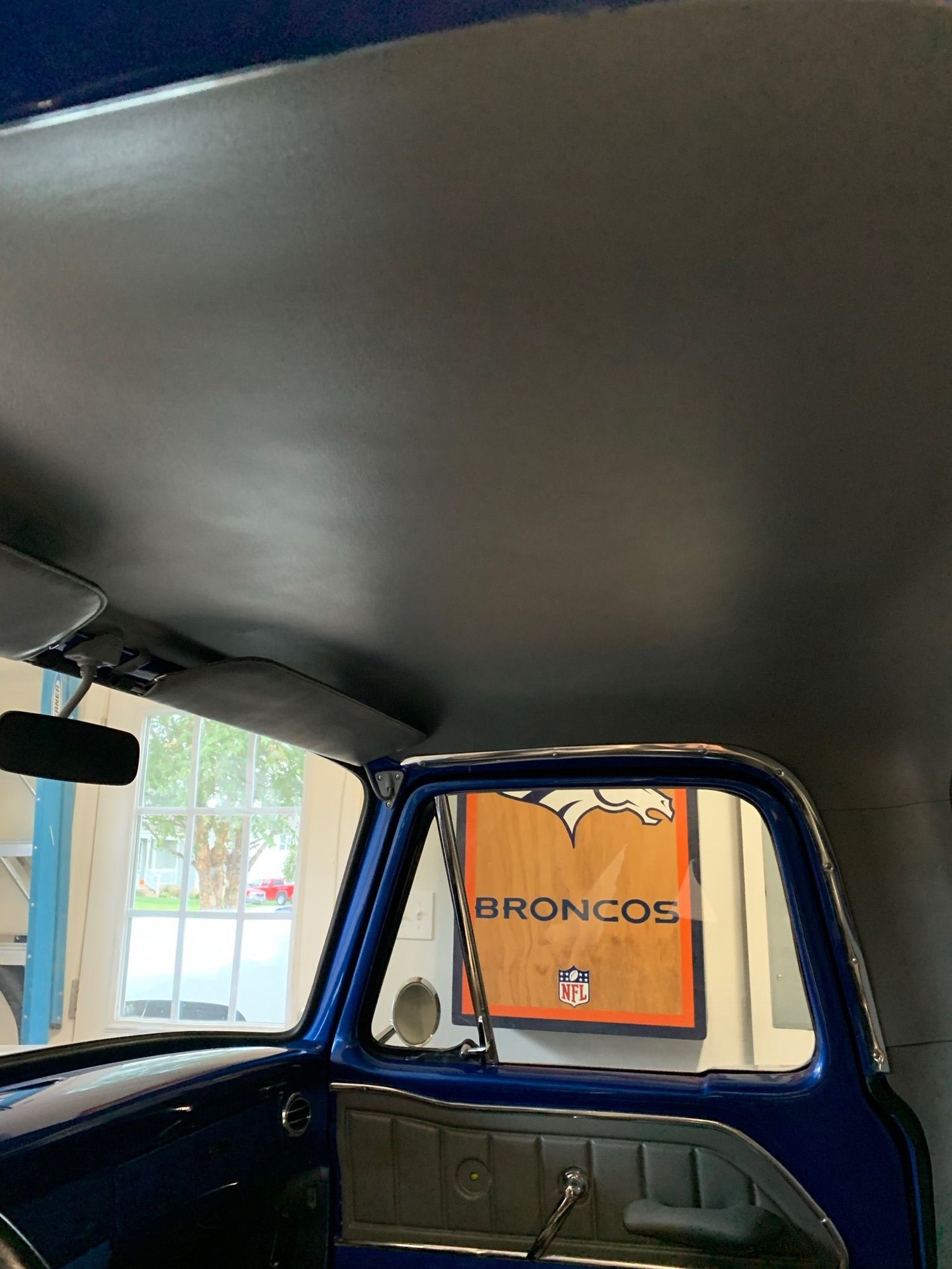

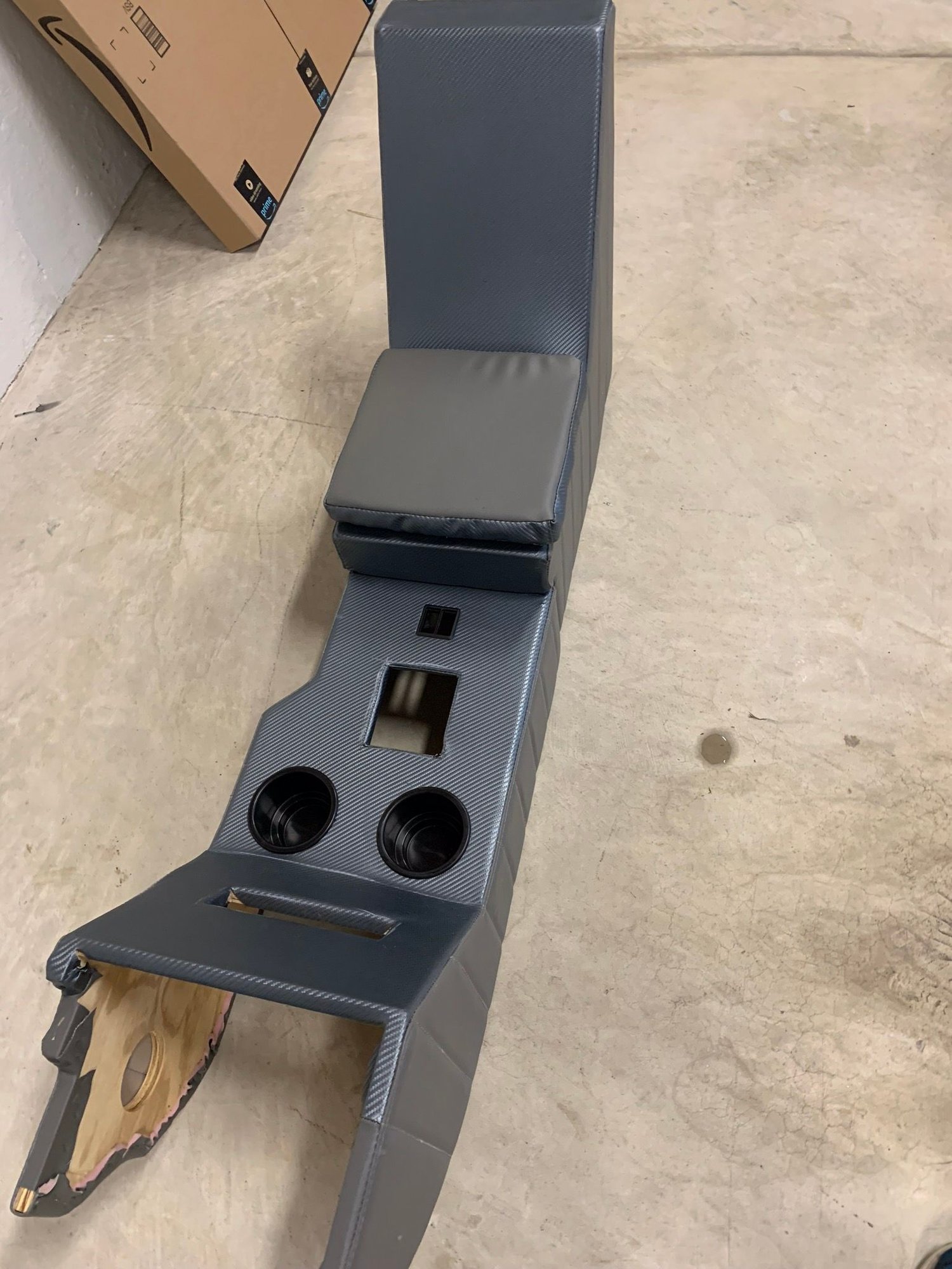

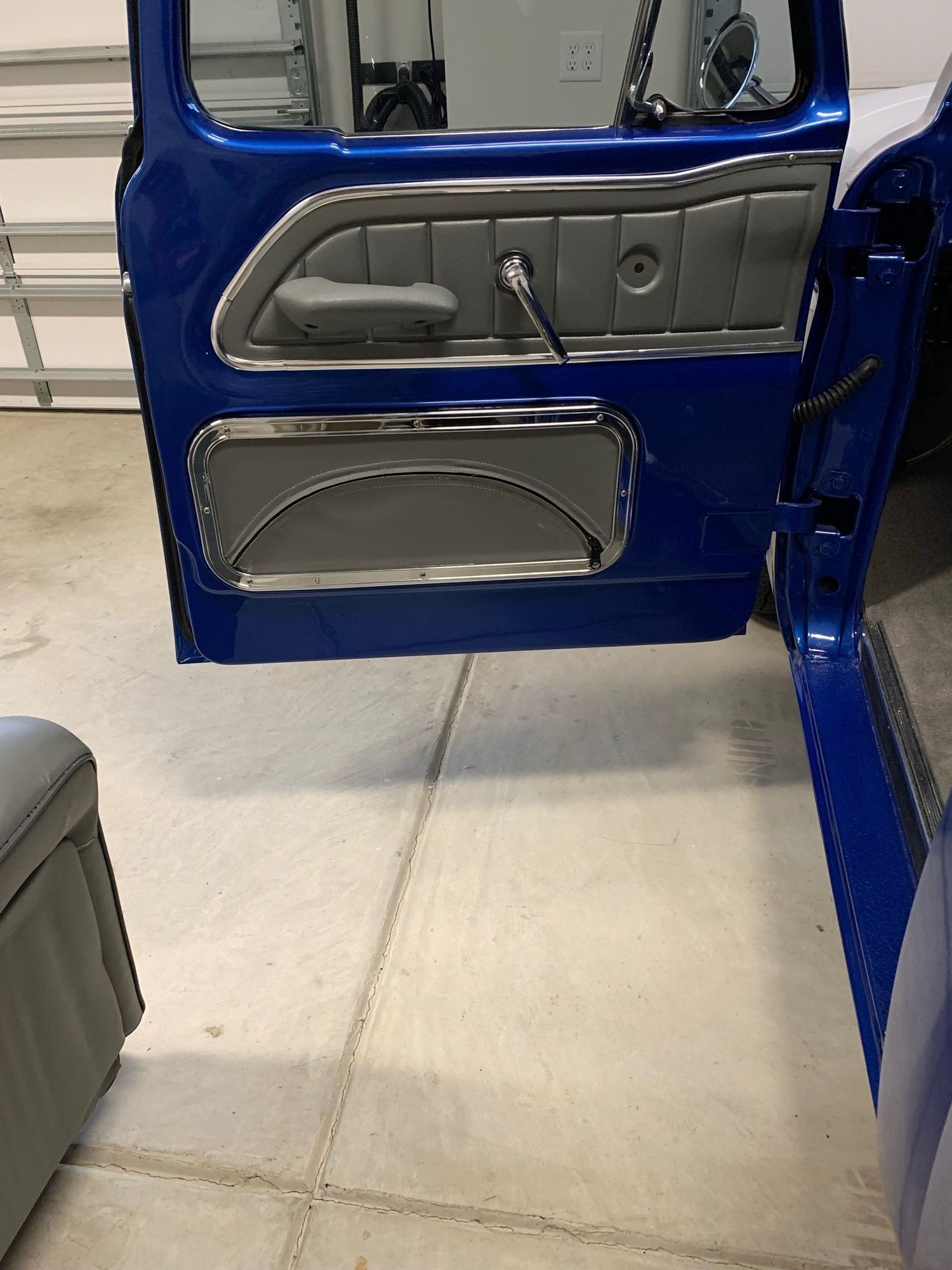

I will add some photos soon, the paint went better than expected. I purchased the headliner and rear cab cover from Rod doors it’s an abs product, door panels and arm rests came from Dennis Carpenter all of which covered very well with the prep work and two light coats followed by a final. It was shocking how simple the process was.

Thought a few pictures may help
