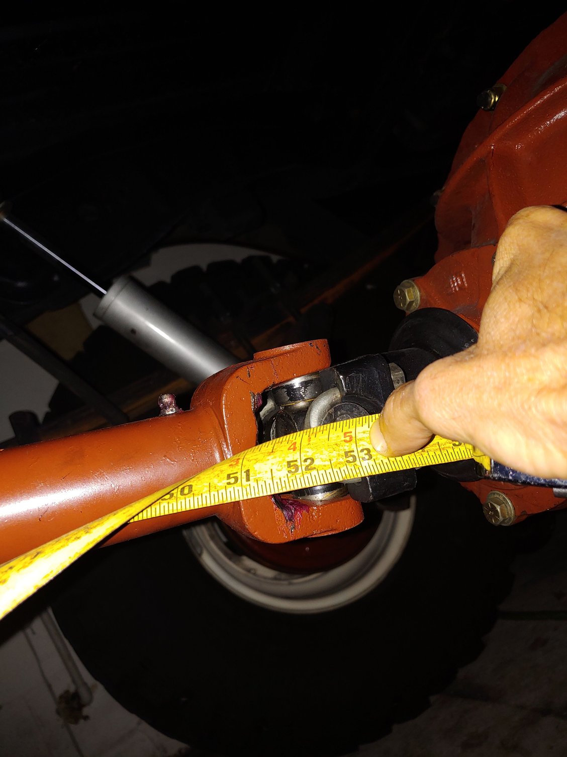

I have a 1979 F150 4x4 short bed with a 460. I swapped it from an automatic to a manual NP435. My driveshaft is too short now. The truck has a 4” suspension lift. Would a stock driveshaft from a 351 or 400 work? I have not been able to find one yet. But I wonder the length so I know if I’m wasting my time even looking for one. I measured from center of ujoint to center of ujoint and it’s 52 1/2 inches.

My shaft was custom made a little longer than stock, but only due to a vibration problem. I ran the stock shaft with lift installed and it made the vibration a little better moving into some less damaged splines in the slip joint. It worked but had a lot of spline showing when installed with my 2 inch blocks. Always showed some but was noticable more. Its been close to 2 years but I want to say less than half the female side had splines into it. It'll work but should be lengthened to function correctly....***edit added***......
measure your blocks if their 4" or spring lift true 4" in rear then it might be a little too short. But based the ruler it looks to be about the same****
I will also add I never unloaded the suspension with the factory shaft and the lift installed. This may have been enough to pull it too far. Never tried.
Wish I could measure the stock one for you but i just cut it up Saturday to make a shaft for the front until I can get down to the shop that makes new ones. Came out pretty good though.
Old rear spline end and female end made into front shaft.
Lift advertised as 3inch rough country. Was close to 4 up front. 2 inch in back.
Measured from ujoint centerline transfer case side of double cardin cv
To centerline of pinion u joint
