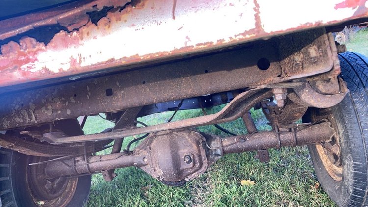

Hi, so I have the rear half remains of two 67-72 f150s
then I have one that is red
I believe the one has a dana 44 rear end and the other has a ford 8(or 9) rear end, both are 5 lug which I believe the pattern is 5x5.5 I think.. anyway.. i could be wrong about those from memory, so I can verify again for sure. I also have at least 2-3 more axles which are ford 9 and ford 8 inch rear ends. I only say or because I noted the special look but didnt realize the 8 and 9 looked the same but the size and placement of bolts, etc, would differentiate.
i believe this looks like an 8 inch
Anyway, I currently drive a 96 f150 with an 8.8 and long story short, it will need a different diff at some point. Since swapping to the 96 appears to be at least involved, I was wondering what the values to the at least 2 original rear ends might be to someone or if they are valuable for trade, generally speaking, and what i should look for as far as tags, stampings, measurements, etc...
I know the two one the trailers have coil springs in addition to the leaf springs, if that makes any difference?

Likes: 607
From: Minnesota
The dana 44 may be worth some money. The other on is a 9" for sure. But there were so many flavors you could have a common one or a rare one. I would look for tags on the rear ends and post the numbers on here. You may have junk or you may have gold.

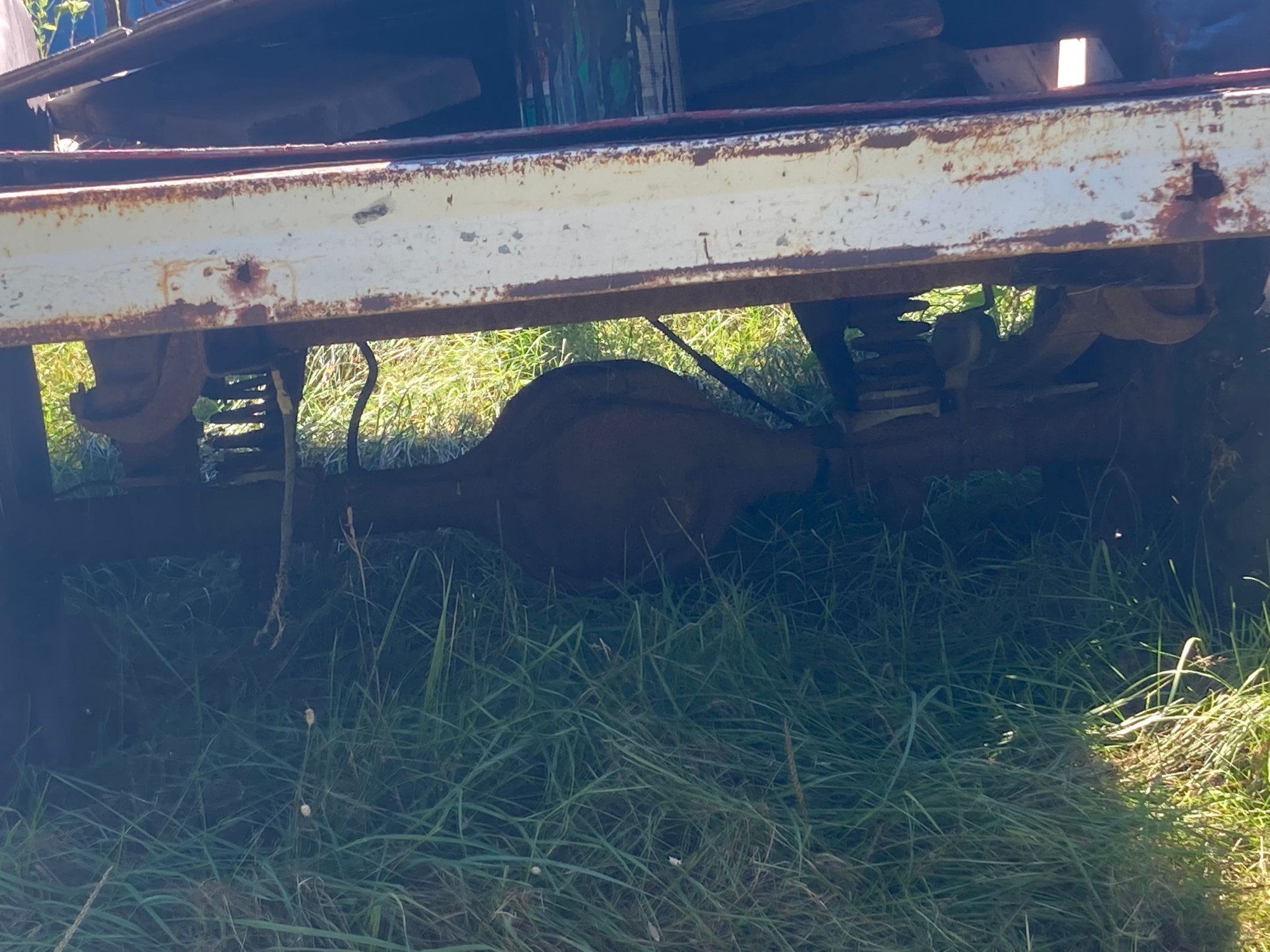

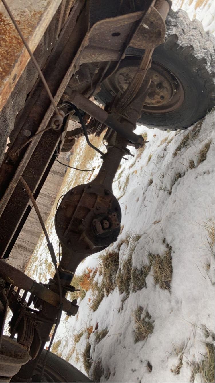

i lied the red one is not with coil springs although the blue one doesn’t really look like it was proper.. anyway, I did a lot of yard work to hack back weeds and grass so I only snapped pics of the rear of both. I don’t know if this is much help

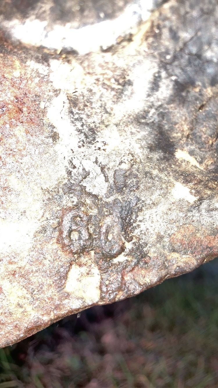

So I believe it to be a Dana 60 based on the cover matching a diagram of numerous covers for ID and also the 60 on the housing where my other Dana axles say 44

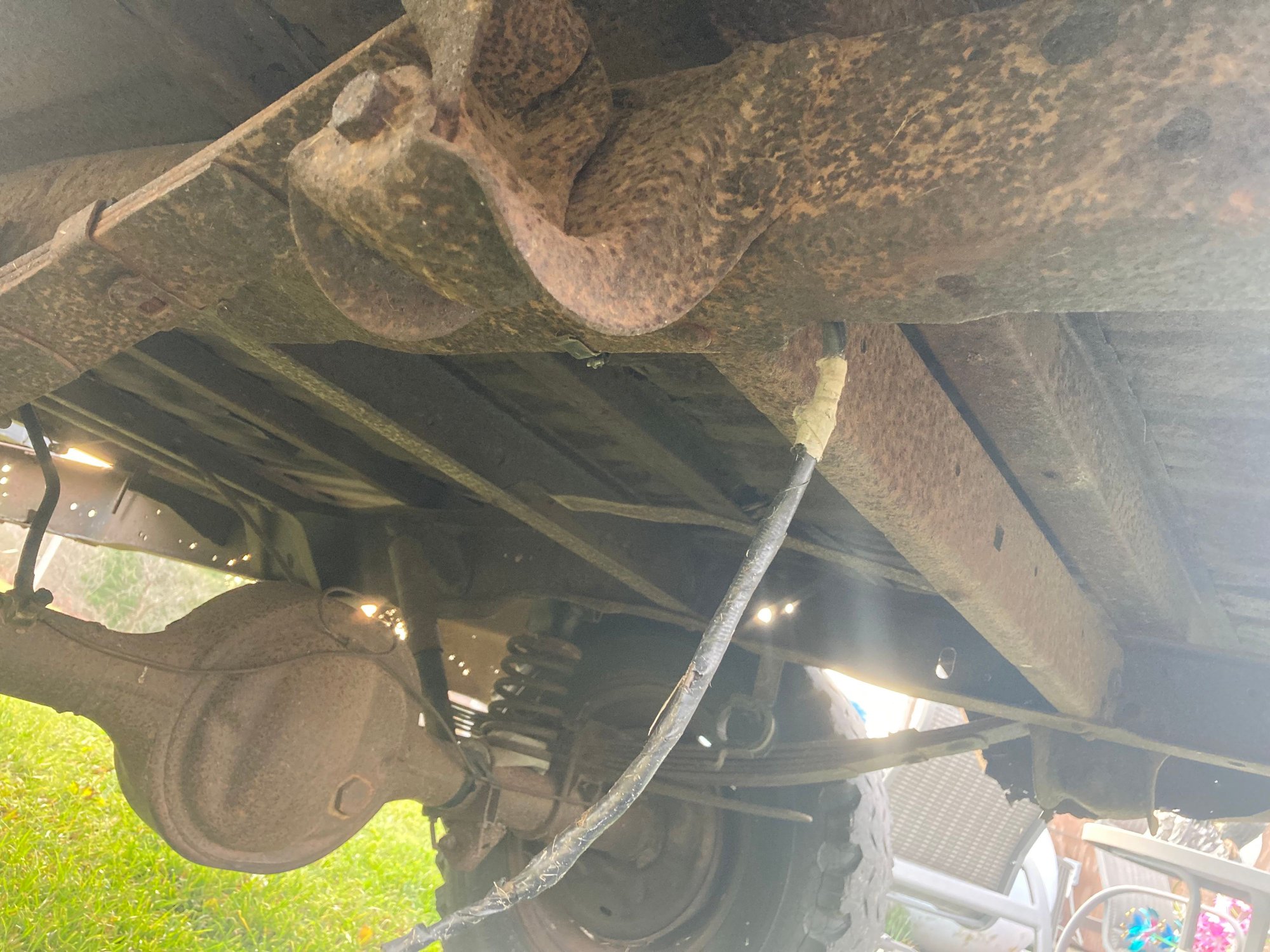

I am referring to this one that I already showed, which is a 67-72 ford F--150? I think with a d60 and a spare tire carrier(this is a trailer that used to be a truck)

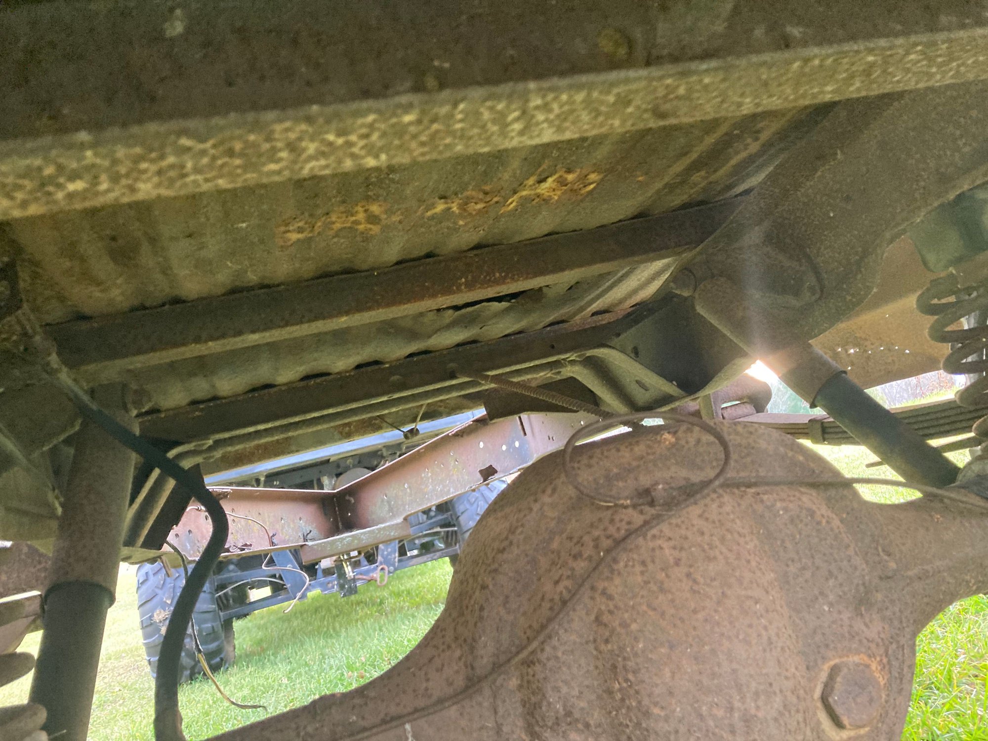

This is the other one which is a 67-70 ish F100 camper special or something, its not visible but it also has a spare tire carrier on the other side of the diff at the back. this one has the aux fuel doghouse. also a trailer.

That is indeed a Dana 60. If it has 8 lug hubs it is off a F250. If it has 5 lug then it's off a H/D F100. To tell what year the bed is you can tell by the rear reflectors.This is 1969.
