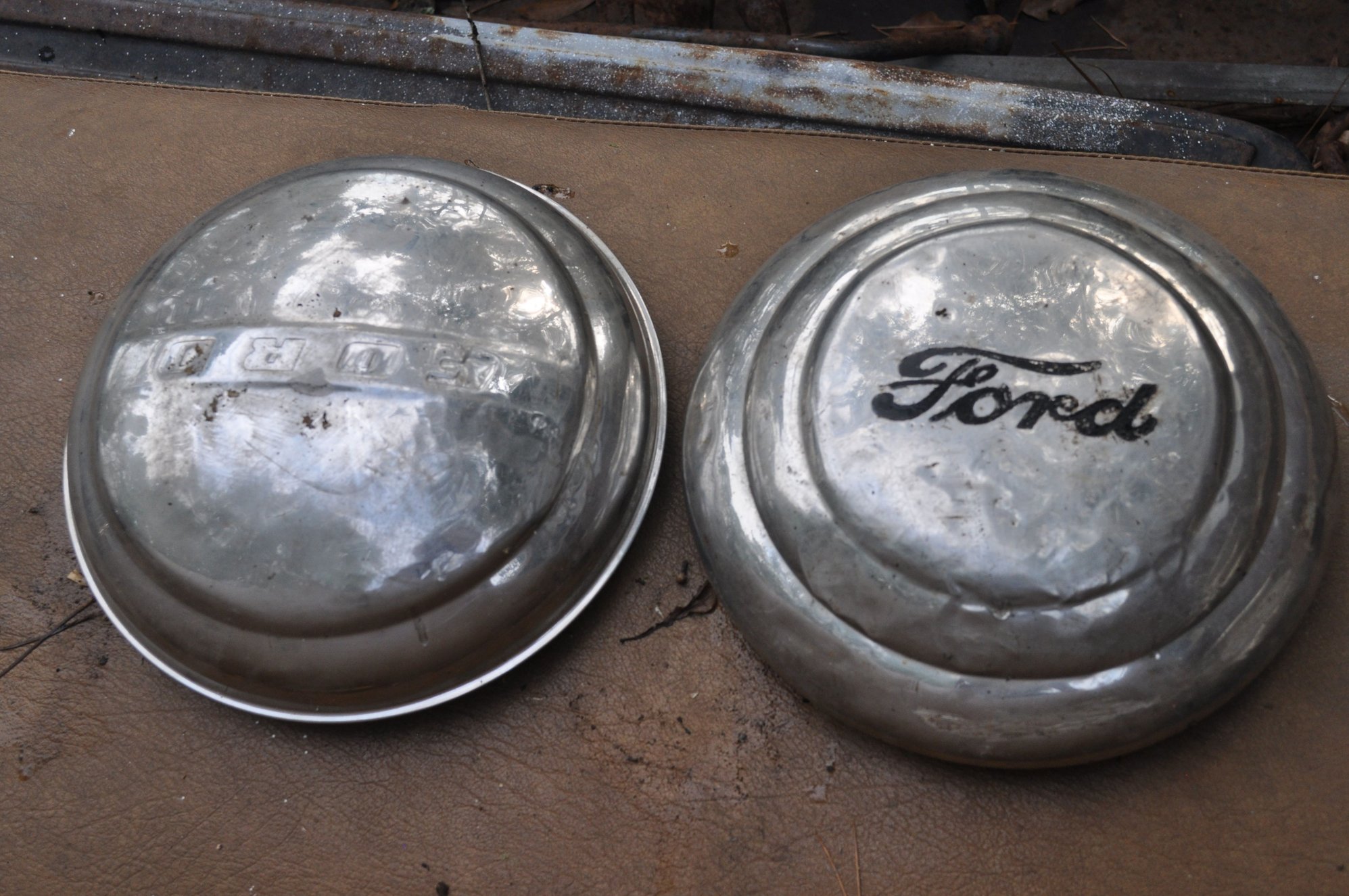

My 55 F100 has 3 of the hub caps on the right and 1 of the other. I'm guessing the one on the right is correct for the truck, but what about the other one?

Believe it or not, neither are correct for a 55. The one on the left is close, however. Hub caps from 52-56 and maybe beyond were not stainless steel. They were steel painted argent silver. From 53-56 they had red FORD letters.

In that condition, wall art is about all they're good for. Those appear to be for a 41 Ford. There's several of them on ebay that no one is biting on. Dennis Carpenter has a good selection of repro caps, most of which are reasonably priced.

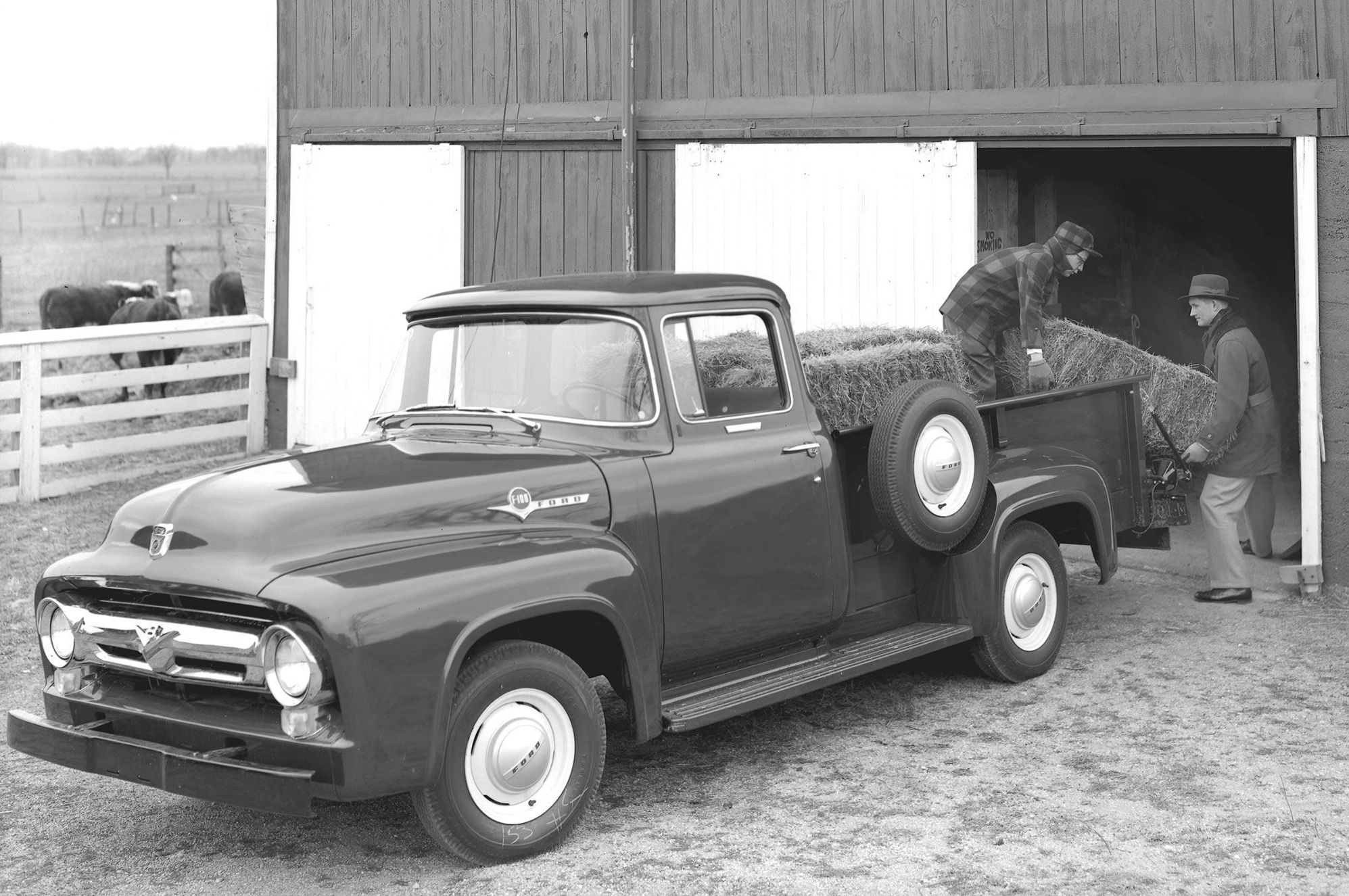

Here is a Ford Factory pic showing the hubcaps on a 56 F100 Longbed.
I like this truck of an early Ford Factory picture... It has stainless hubcaps and a bumper that was not put into production for 53-56.

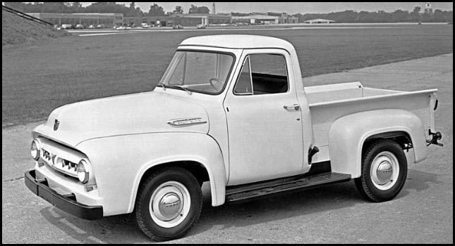

According to some experts I've spoken with 1952 trucks were supposed to have argent painted hubcaps. But every illustration and photo like the ones seen below clearly show a stainless or polished bare metal cap. I think they fit the truck well with all its curves. The painted argent ones somehow look good on the later 52-56 body styles, like more practical looking.
Old Sep 6, 2021 | 07:25 PM
3twinridges's Avatar
3twinridges
Joined: Nov 2014
Posts: 2,442
Likes: 256
Interesting in those pics that the lettering on the caps and trim is body color. I have a set of NOS hubcaps still in the original boxes with black letters. But there is no distinction in part numbers that I can tell for each color. Anyone have any insight into the lettering color?
