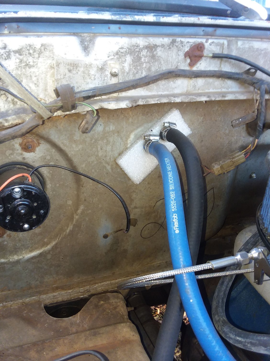

I'm not sure what seals you are asking about, but we used some foam tape either 3/8 or 1/2 wide to seal around the fresh air vent door.
Look just under the blue dash. I think we also put some between the box and the opening in the kick panel where the fresh air comes in.
We also put a new blower motor in while it was out. You should at least look at the thread on here about how to drill a hole and add a couple of drops of oil to the one you have.
Then we used some foam packing from a parts box to seal around the heater core outlet/inlet and hoses.
Also if you haven't pulled the box yet, there is a mounting stud in the center of the firewall that runs into the engine bay that has a nut on it that you almost have to stand on your head to get to. On ours it is right behind the motor.
It is just under the gray wire connector in this picture.
Good luck and post up some pics of your progress.
