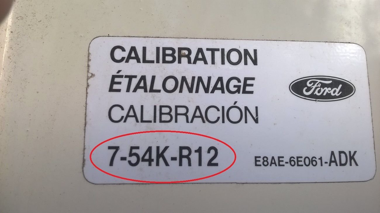

On the drivers door frame you should have a calibration code sticker. What is the number?
Should look something like this

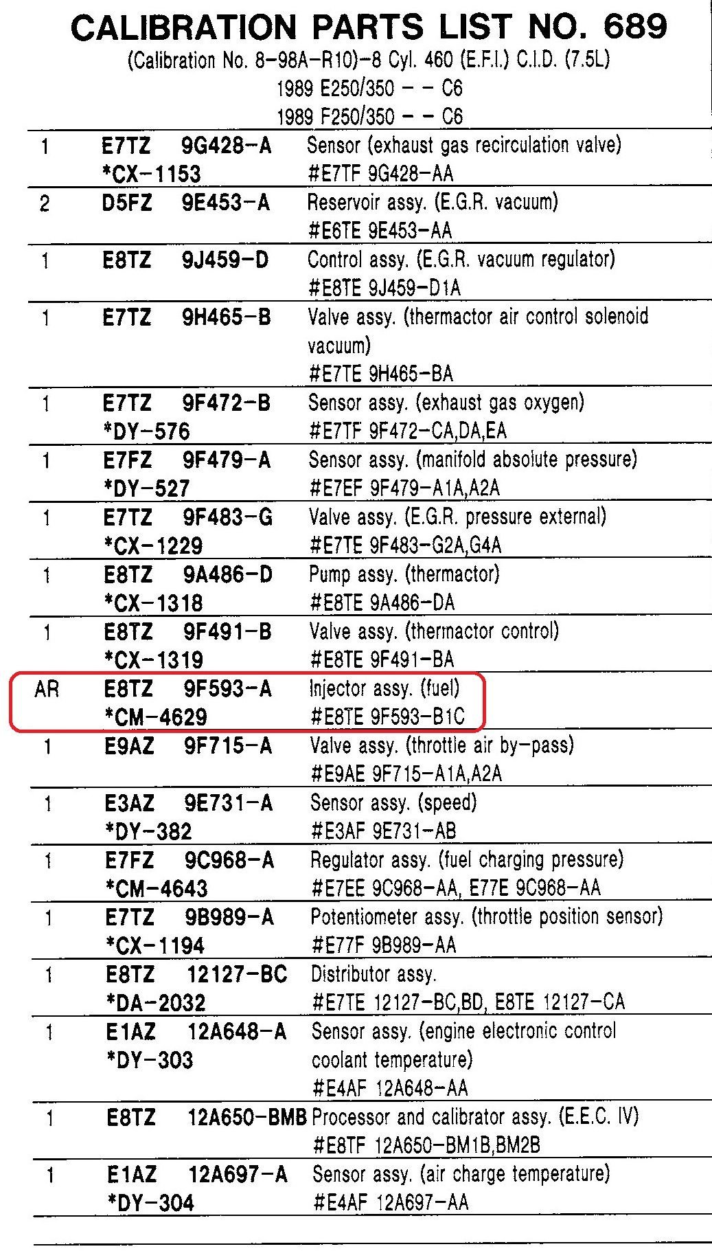

I have owned the RV for about 4 years now. Drove from Florida to Arizona right after I bought it.29000 miles on it now. I have driven it weekly and then the past 6 months I have driven it daily. Never had an issue other than the fuel pump relay going out right after I bought it. At that time I couldn't find the relay locally so I changed it over to a standard relay setup from on electric fan. I did use a 30 amp relay and have not had any issue with it until right before my trip.it went out. Popped in a new one and was good to go. The calibration sticker shows 8-98A-R10. I haven't looked up anything on it so I don't know what it means. I will check the ohm readings on the ones I can reach but I cant reach #5 Cyl. as I would have to tear it all apart to get to it. I would much rather just replace them than rebuild them. Time wise I need it back together as soon as possible.. TY EDIT: It has been hard to start the past 2 months when hot. I have to use the emergency start button to give the starter the extra power to start.

Here is a list of the original ford part numbers used on your van I was able to come up with from your calibration code..
