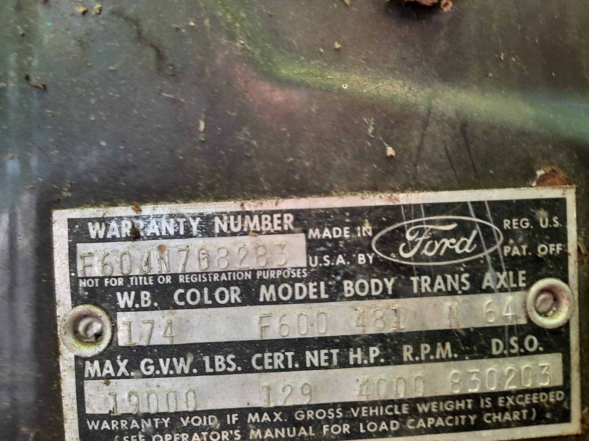

Need another VIN plate decoded please.
So this is a 1965 F600 that I'm picking up next month.

F60 = F600 gas 4x2
J = 240 1V six cylinder gas
N = Norfolk assembly plant
708283 = 1965 series number
174 = 174 inch wheelbase
F600 = F600 17,000lbs GVWR (conflicts with the 19,000 shown on the plate. Note this is a special order truck, that may have something to do with it. No F600 model shows 19,000 even GVWR in the MPC copy I have)
481 = Beige vinyl, conventional cab
N = New Process model 435 four speed transmission. This code is also used for Dana (Spicer) model 5652 five speed direct transmission, and the Truck shop manual copy points to this for code N.
64 = Timken model F-106 single speed rear axle, 15,000lbs capacity, 6.80 ratio
No front axle code--from '64 to '69 only optional axles were listed. The standard axle would probably be a Ford 5,000lb capacity without power steering
19000 = 19,000lbs GVWR
129 4000 = 129 certified HP @ 4000 RPM
830203
83 = Government
0203 = Special Order Number
Government--explains the 240 engine and single speed axle.
