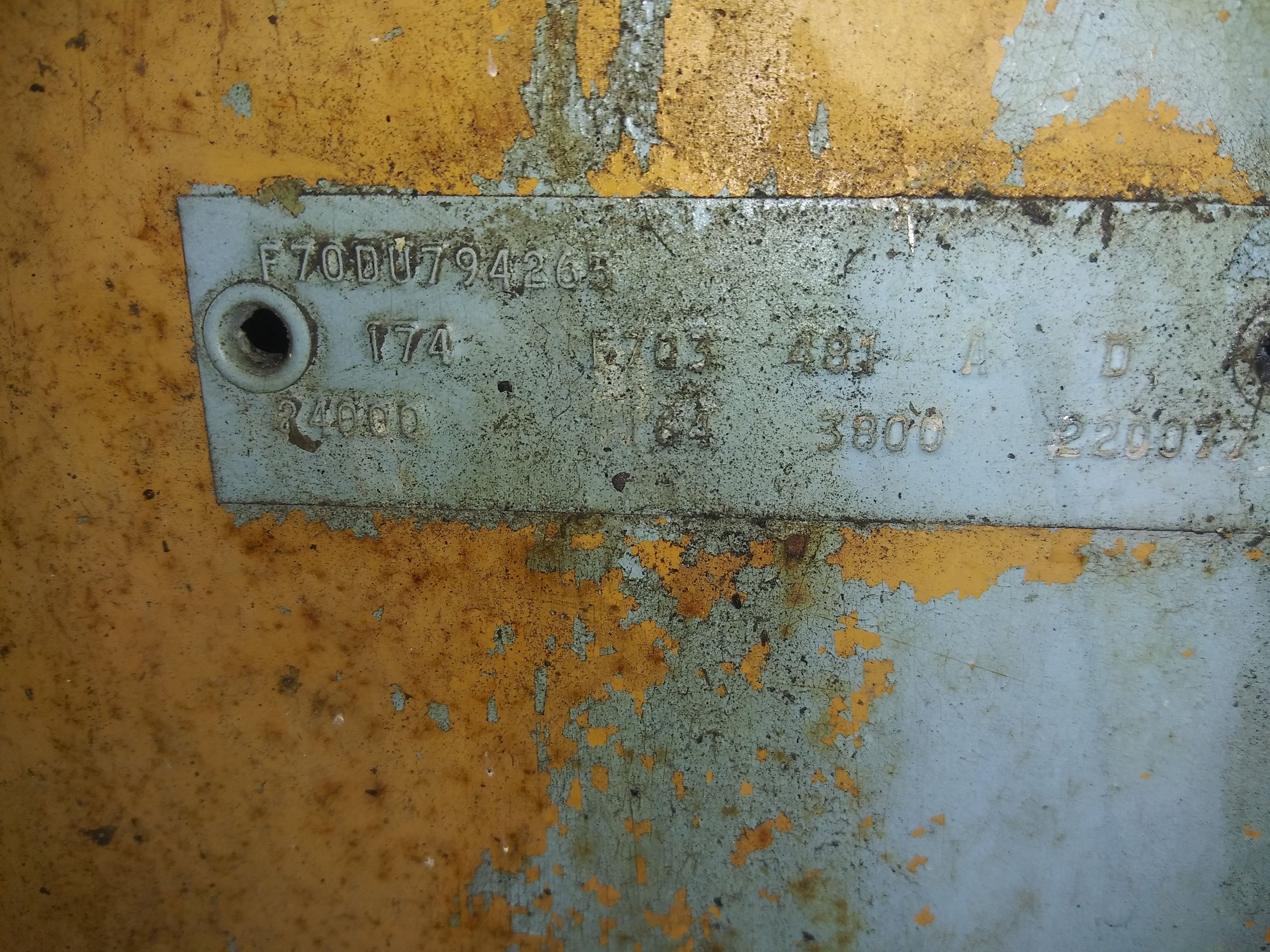

Im buying a old ford and need the vin decoded. Thanks for the help in advance
F70DU794265.
Old Jun 28, 2021 | 12:47 PM
85e150's Avatar
85e150
Joined: Apr 2004
Posts: 34,494
Likes: 2,809
F70 = F700
D = 330 2V HD FT gas V8
U = Louisville Assembly Plant
794265 = 1966 Series Number
174 = 174 inch wheelbase
No color code, note this was a special order
F703 = F700, 24,000lbs GVWR
481 = Upholstery, seat, cab & body type. I do not have this information for this model year. I'm guessing you have a standard cab with a vinyl bench.
A = New Process model 435 four speed transmission
No rear axle code. Again, this was a special order and the axle was probably part of it.
D = Ford-Rockwell (Timken) front axle, 7,000lbs capacity
24000 = 24,000lbs GVWR
164 3800 = 164 Certified Net HP @ 3800 RPM
220077
22 = Charlotte District Code
0077 = Special Order Number
If something doesn't match up, let me know and I will double check.

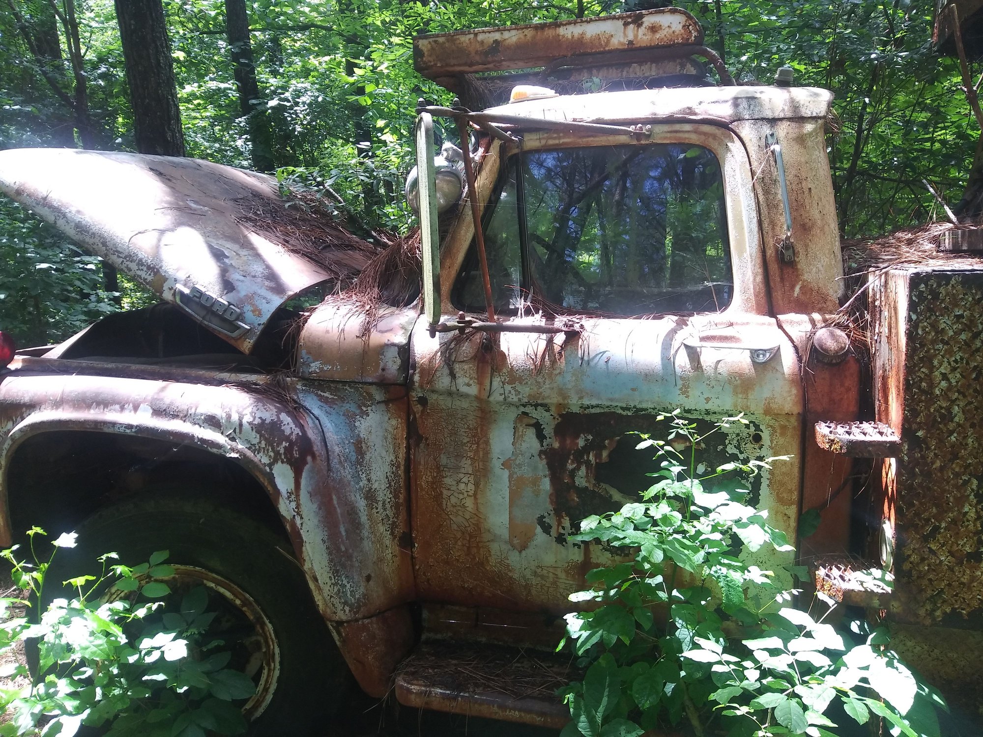

Thanks. Yes its a standard cab on it. Here is a pics of it. Thanks again Tony

I take it it's not a runner.....
Dayton style wheels are good--very little chance of a widowmaker rim.
Quite a post hole digger on it.

As soon as i get it home. The boom is coming off. Going to make it just a service truck in time. Is a 330 a FE base motor?
