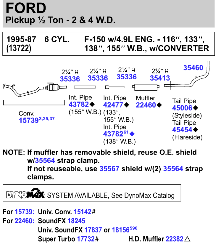

Is 45166 maybe a longer version of 15739 for when you don't have a cat?
I can't configure any years of the EFI exhaust that incorporates this all.
So for my 133", it seems like a 45166, single 42477 extender, 18238 muffler (which I already bought) and a 46326 tail (which I also already bought) might get it out the back. Anyone able to check my calculations or find the application combination for 45166?
https://www.walkerexhaust.com/find-my-part.html

Actually I need to look at the outlets going forward. I have all 2" pipes and it looks like all the EFI are 2.25". Bummer I don't think I can return the ones I have!
