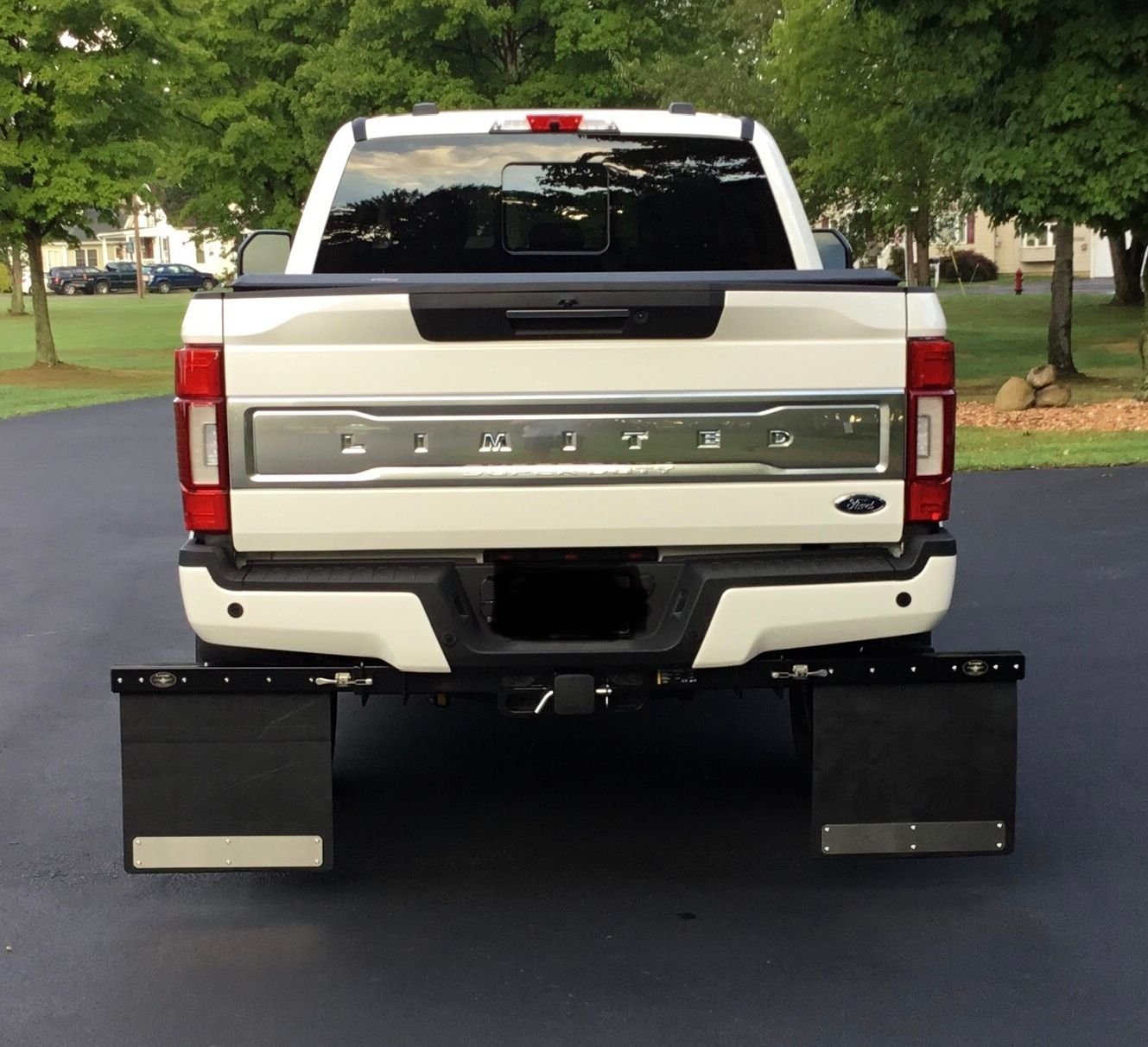

I ordered them from this machine shop.
http://www.livelymachine.com/
If I remember, they make them one off. Not sold through a distributor.

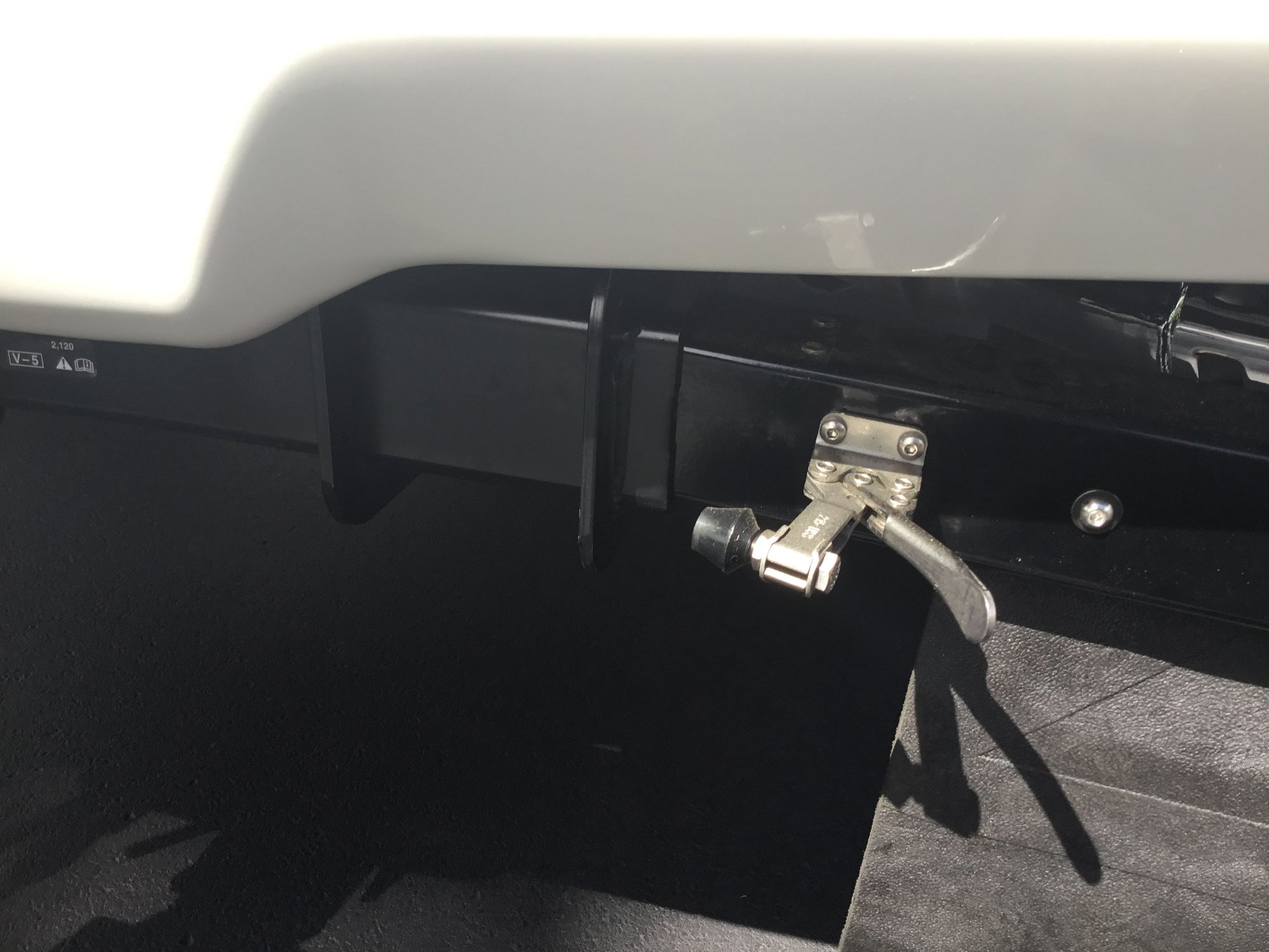

If you notice, there are 8 Allen screws that adjust to the irregularities of each receiver sides. Makes for a perfect level and tube fit.
Engraving was offered in the weight plates for 75 bucks. The weight plates come in polished stainless. I flipped them over to the brushed side to match the trim on my truck.

Thanks for sharing that info. Can you post a close up pic of how they attach to the hitch? Thanks again!

They just slide in from the sides.

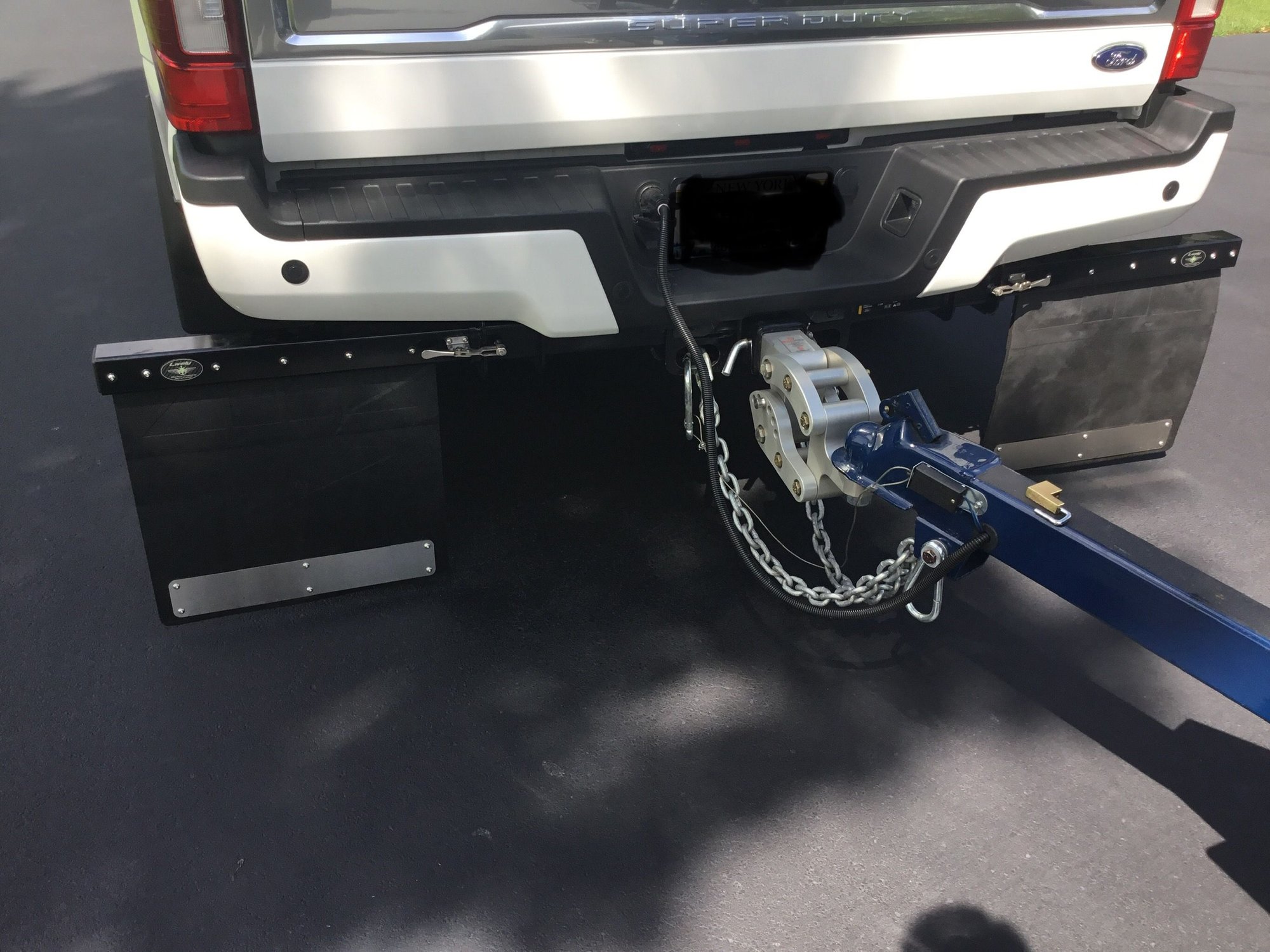

Nice looking setup, and certainly much easier/quicker install than the hitch mounted Rockstar flaps that I use. But with the easy on comes easy off, too. I think that I'd want the ability to lock them in place if the truck was ever going to sit unattended with them installed...as mine does when traveling.

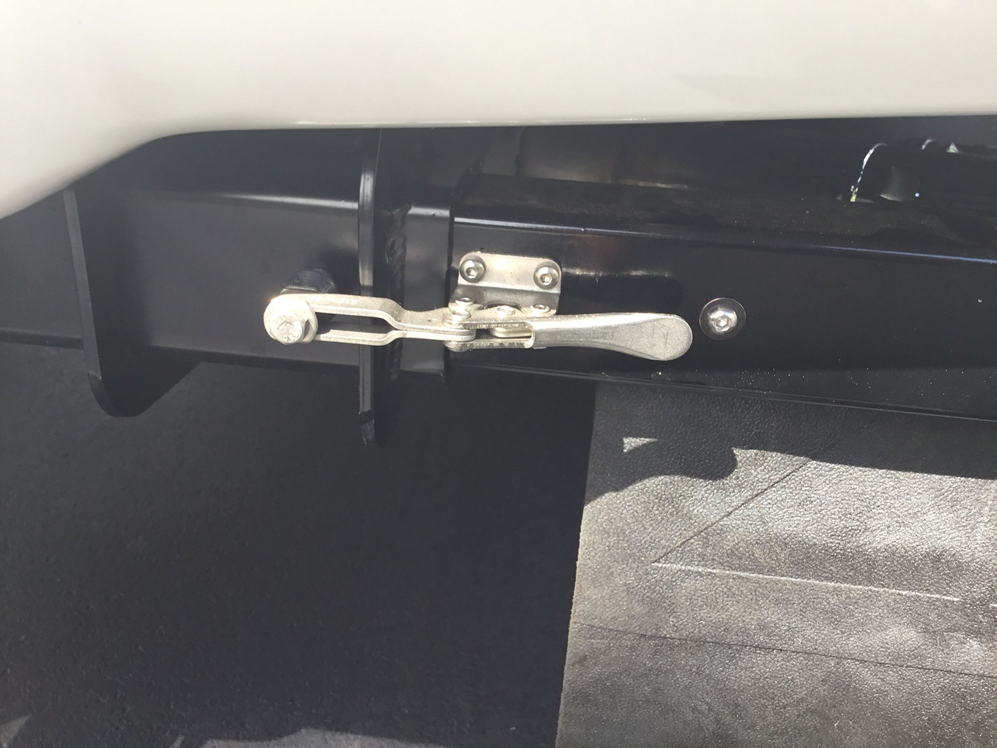

Those flaps are a nice set up! Thanks for the detailed pics, I was a little concerned about the clamp holding them but the fact that it clamps over the flange on the hitch makes them look really secure.

Others, once the clamp is snapped on, it’s not coming off.
If you are worried about theft, a simple hose clamp over the handle would make a thief work for it.

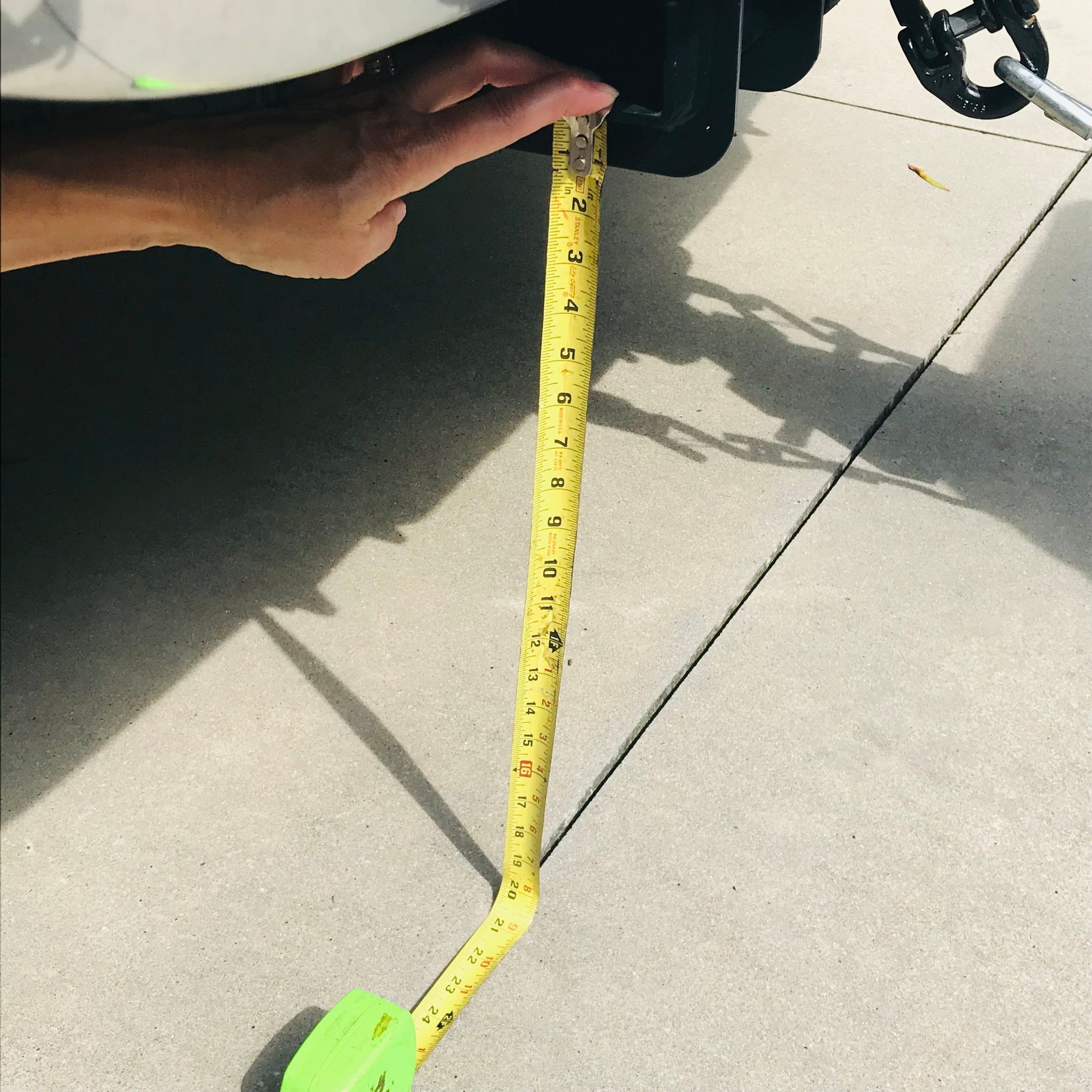

Thanks for the feedback, my Tremor sits just a little higher than the stock F250/350 1-2” higher I believe. So I was thinking it might need a little longer flap. I did talk to the owner and sent him photos with measurements. I am 20 inches from the bottom edge of the receiver tube to the concrete drive. He has done several sets I believe, so I am counting on him to look at the measurements and get me where I need to be in flap length. Thanks again for the help with this upgrade. Great looking Limited by the way!
