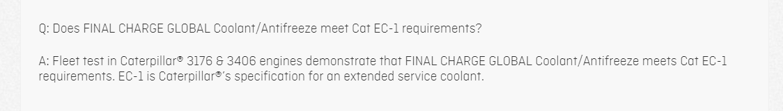

FYI sir...
Image source: https://www.peakhd.com/wp-content/up...itives%20(SCAs).
Image source: https://www.peakhd.com/product_lines/final_charge/faq/

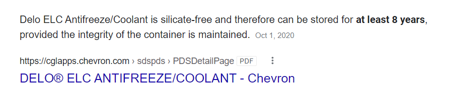

When searching CAT-EC1 shelf life, I came up with this...
Image source: https://cglapps.chevron.com/sdspds/P...s%20maintained.
If it were me, I would run it as long as the foil cover was still intact. Just be sure to use distilled water.
