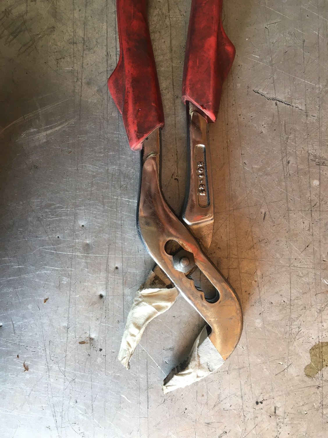

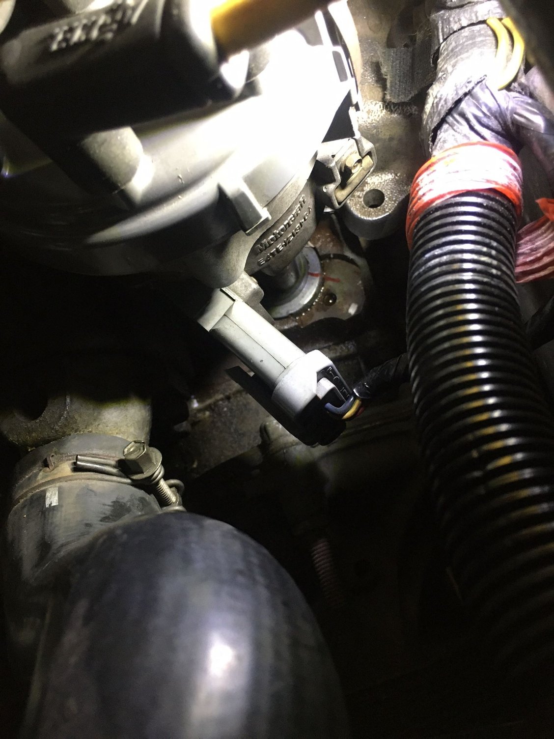

Since Monday, 3 or 4 times by day with WD40. Trying today to turn the distributor with a plier, no way. Need the Van this weekend. I'm giving up for now.

WD40 is a waste of time and frustration. Here is a glimmer of hope for your situation: https://www.ford-trucks.com/forums/1...-solution.html

IMHO WD-40 is not effective as a penetrating oil. PB blaster is a good all around one but for this you need something stronger and it's homemade, 50/50 mix of acetone and atf. Saw on another forum where Hot Rod mag did a test of all the popular brands and acetone and atf worked the best. You also need to tap on something that sticks out to try and get it to turn both ways. A little heat won't hurt and also a strap wrench which won't break anything. Sounds like you can still drive it but this project will take some time and patience. Also google it you will get all kinds of ideas. If you spend the time I think it will come loose. Good Luck.
