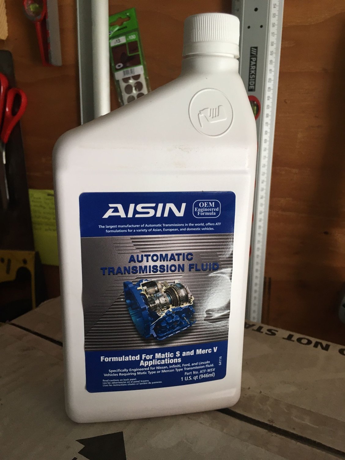

I doing to change the fluid and filter. When i was on the U.S, i've purchasing a box of twelve cans from this fluid :
I know miss again 6 cans for the complete fluid change (18 cans). I can find an ordering on Rockauto. (hope they can send some oil overseas ...)
What do you think about this oil , can be okay ?
Can I still use the Van or do I have to make this change right away ?

It says formulated for Merc V applications. I would feel a lot better about it if it said meets MERCON V specifications. Maybe it's fine, and maybe not. I have no way to determine that.
You can still use the van until you can get the fluid changed.
