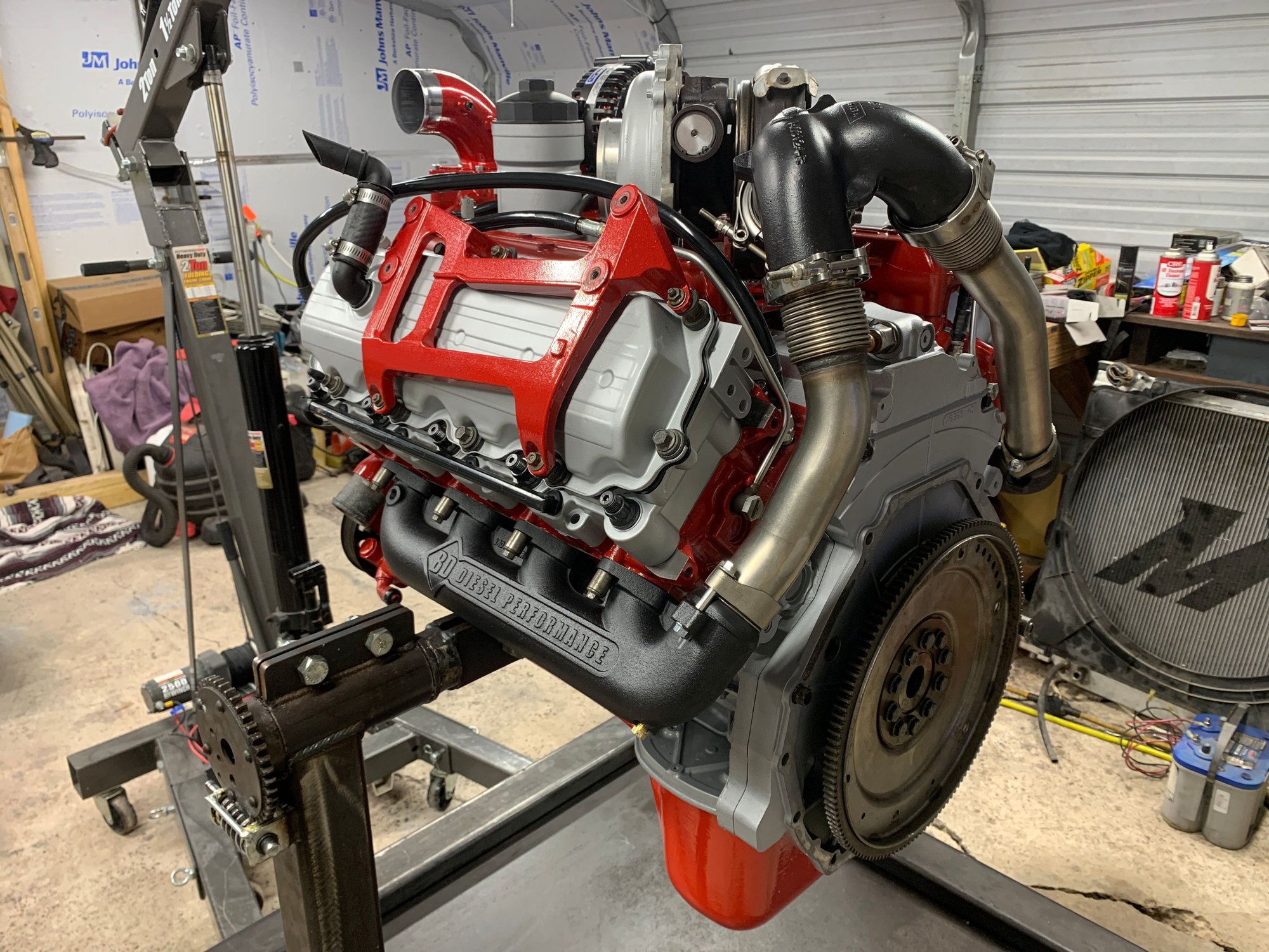

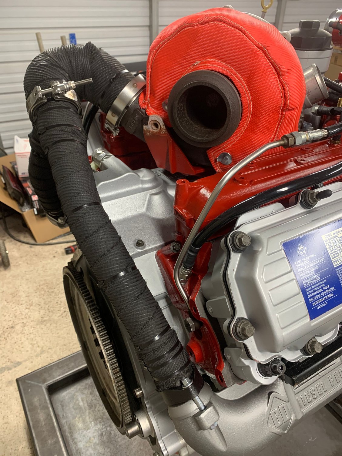

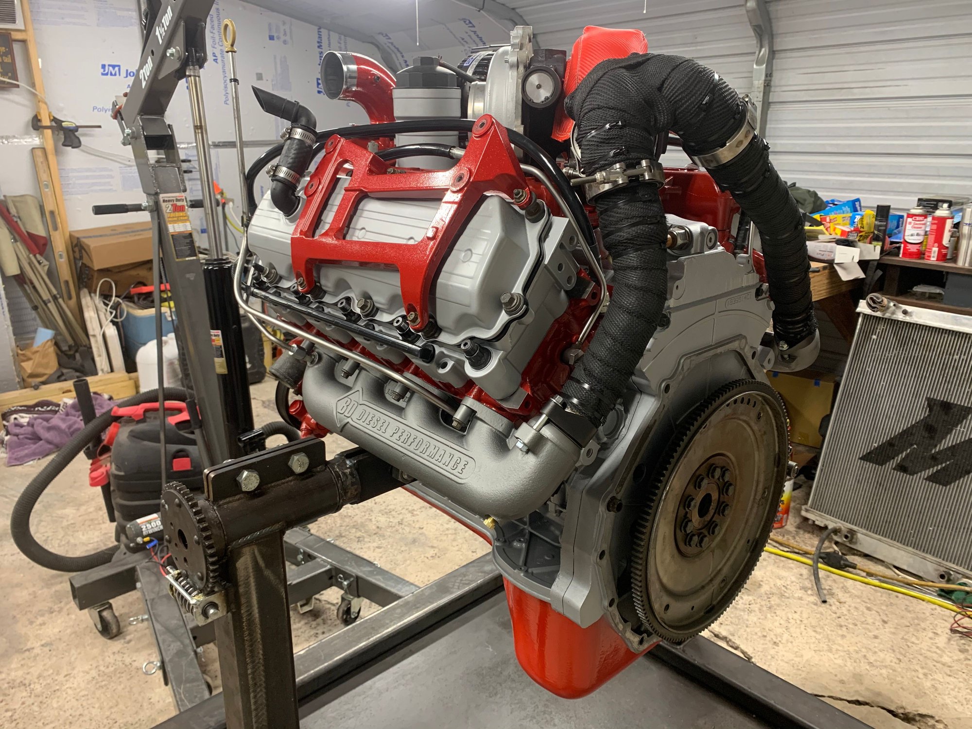

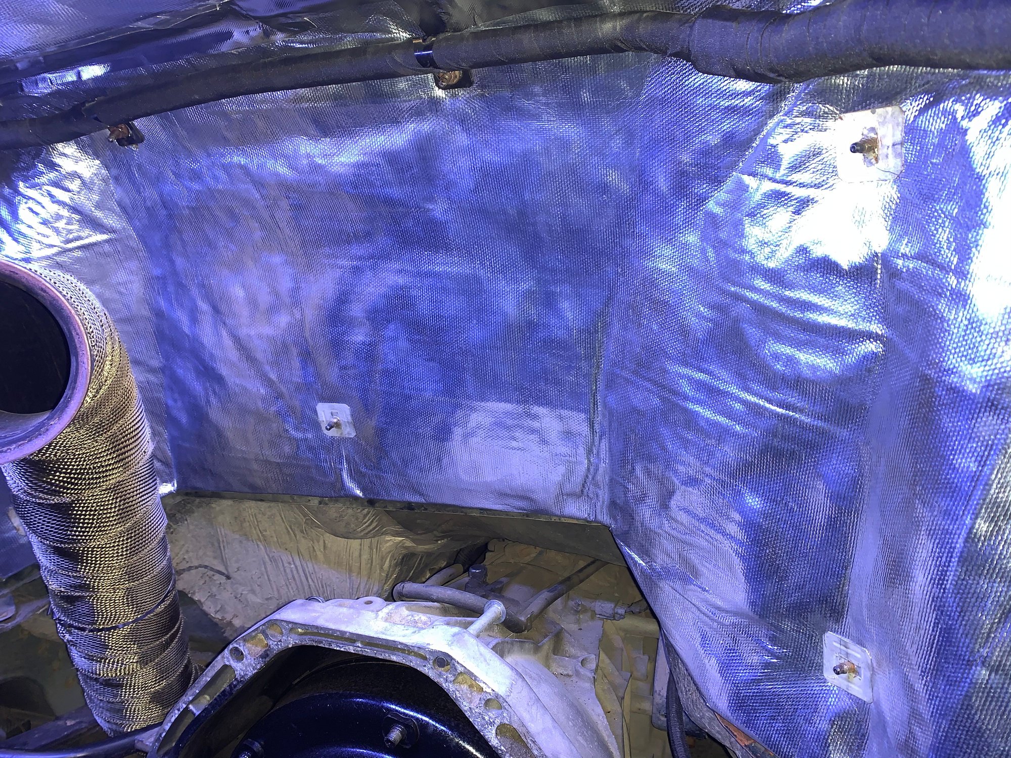

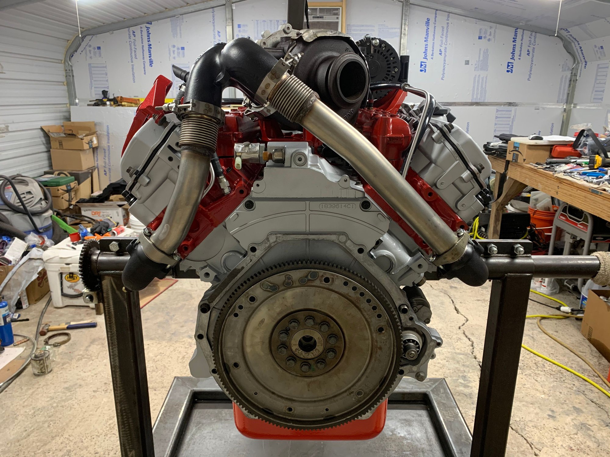

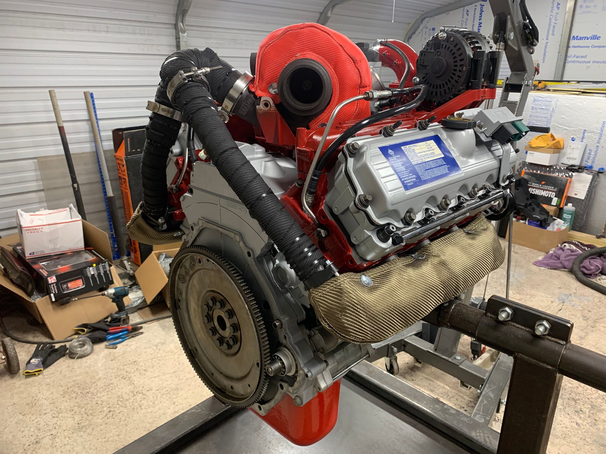

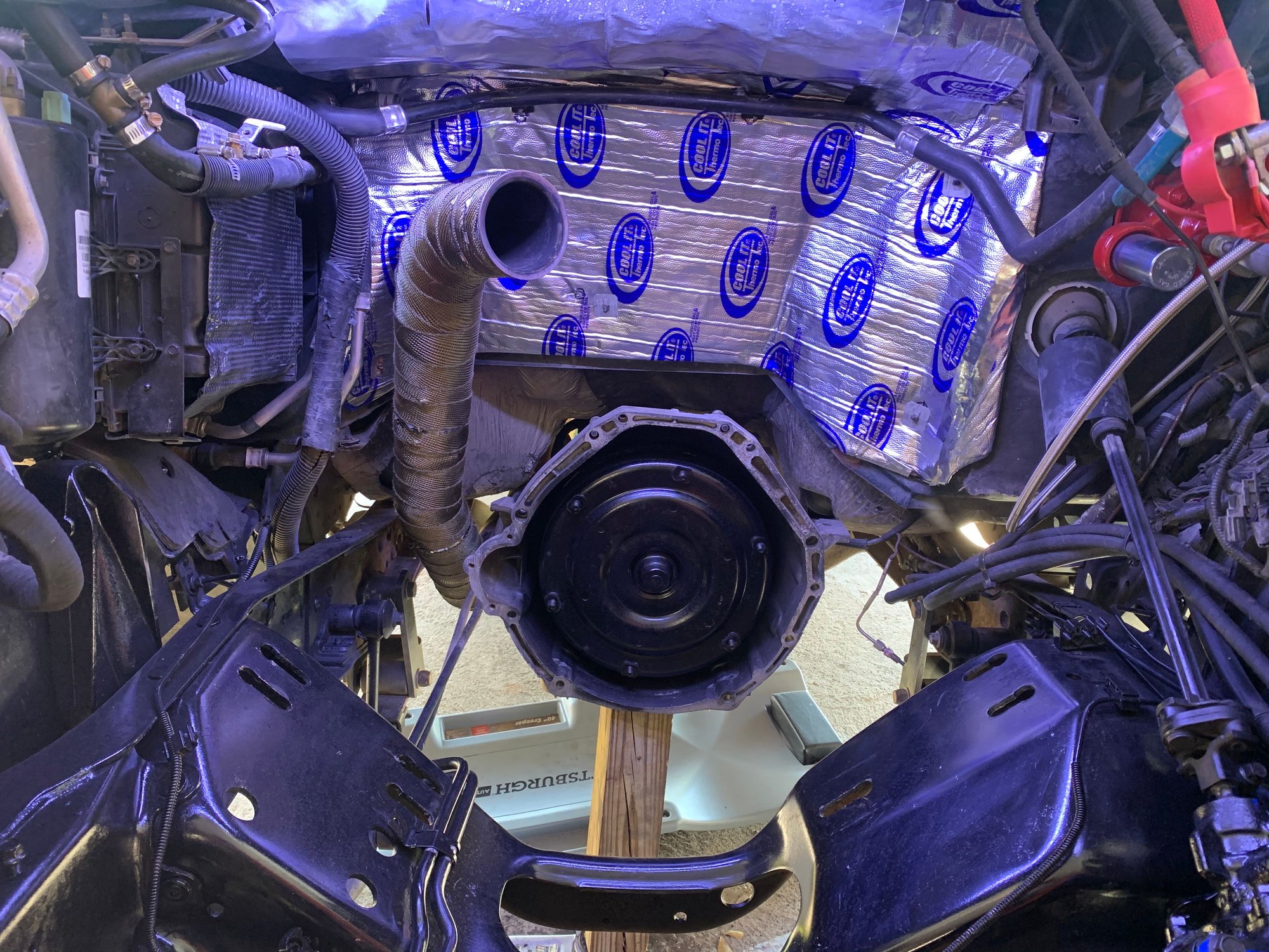

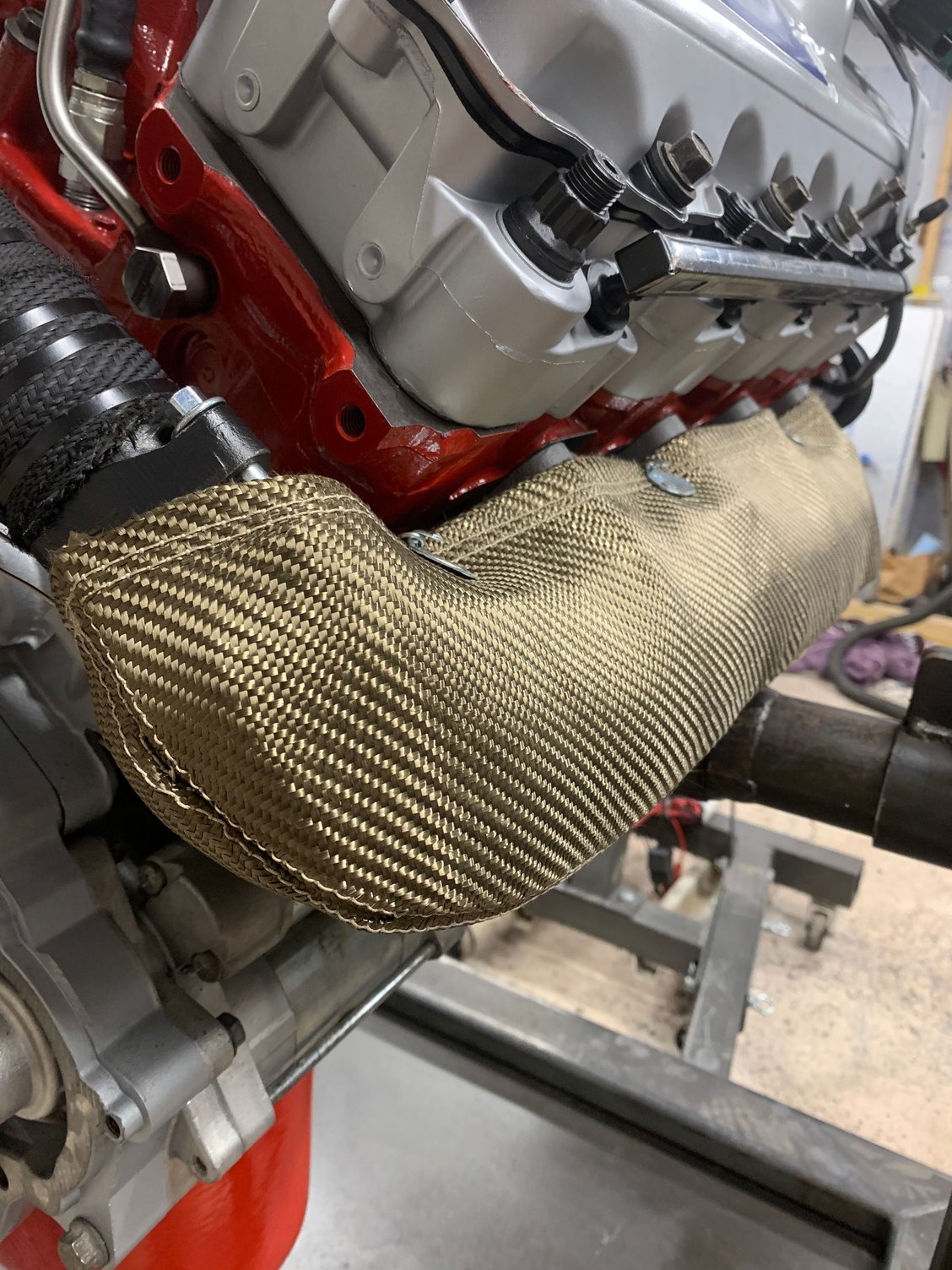

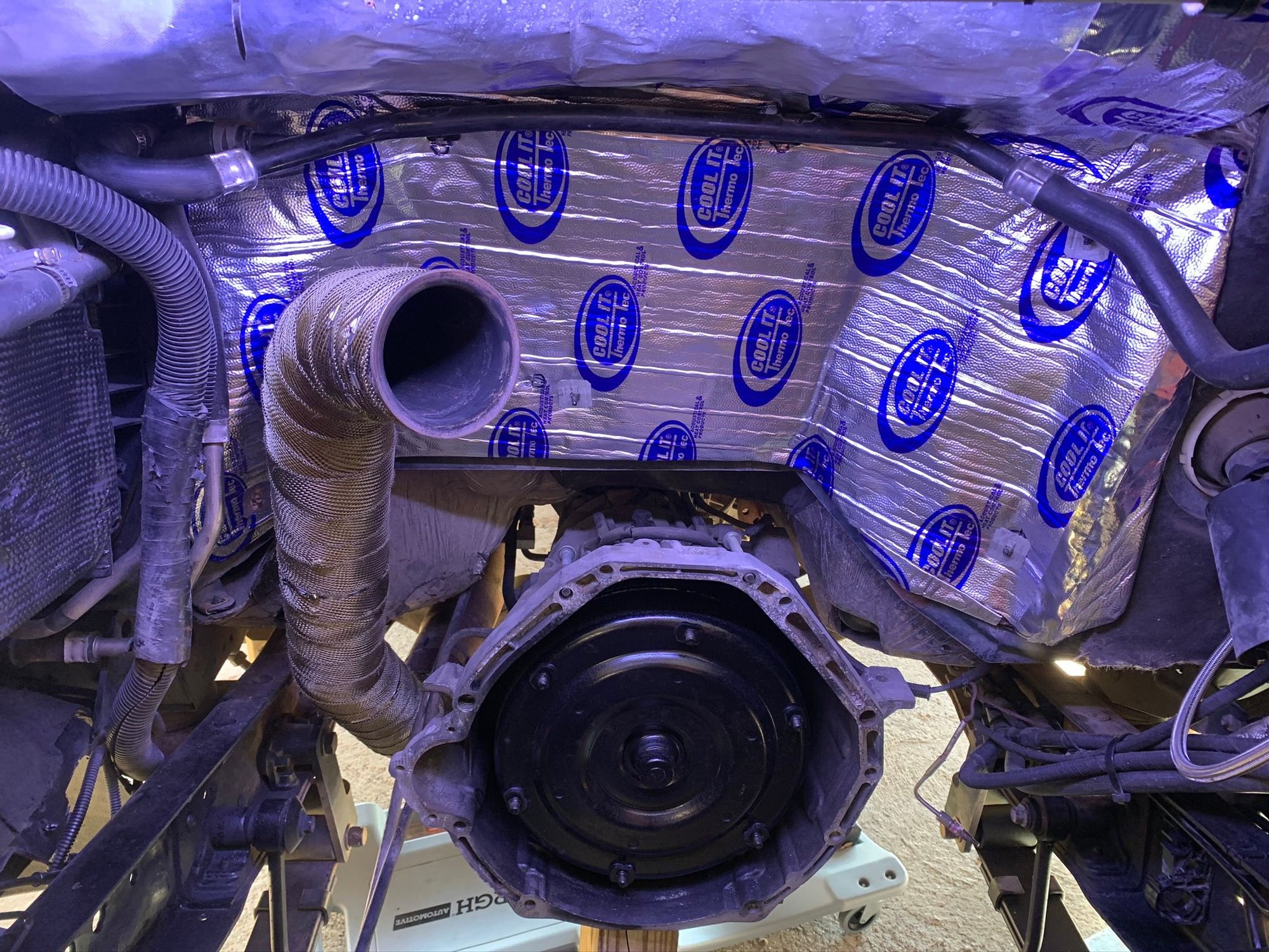

Thanks guys! I’m warning you I’m not cheap, especially if you want the cosmetic paint job and painted bolt heads...🤣
The BD Diesel pipes and Turbo Performance heat blankets really made a difference in spool up and under hood temperature. I also did the full meal deal on the firewall and down pipe.
