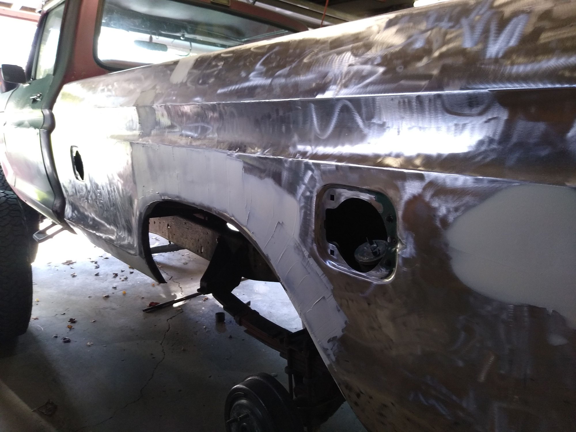

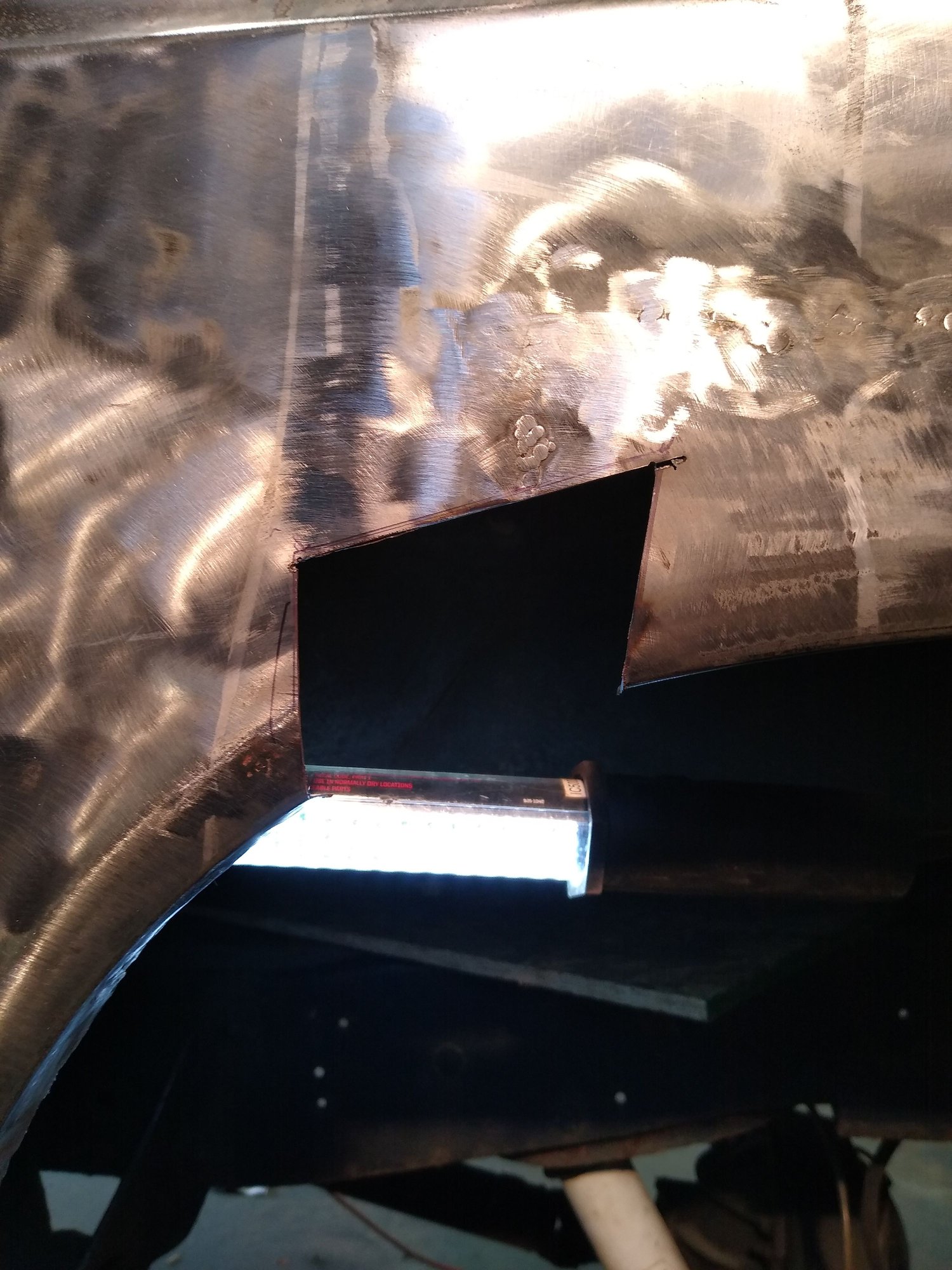

Well I finished up the rust replacement section of my journey....at least as best I could. I did have to redo a couple of spots because I burnt so many holes there was not much metal there anymore. I did go and get a bottle of C25 for the welder........not really sure it helped or not. I think I did better with the Flux-cor .035 than the .023 with gas. The welds did look better with gas but I was burning way more holes. I did look into my welder...I noticed the wire was not feeding consistently. I flipped the wheel over and it did the trick. Just for the info I rented a bottle here in town. It was a 3 year lease....only one they offered. The bottle was $220. plus $50 fill. They would not fill anyone else's bottle, they do an exchange.
I ended up cutting this section out and redoing it. Every time I touched it I burnt a hole through it. I believe it was just worn thin from grinding, trying to weld up all the pinholes.
I just cut out a square and started over.
Had to do the same here.......got tired of welding up hole after hole....getting better at that but tired of doing it...
But I am getting better at cutting the pieces to a closer fit. 1 thing I did learn....at least for me...i had to have a gap. If the panels butted up my welder did not act right. It would just ball up or sputter. If I moved to the side with a gap, nice sizzle sound. No idea why.
Well here is the bondo applied. I did some sanding and I thought the welding sucked........little did I know...LOL!!!!!!! But...its not as frustrating ....yet, just boring.
here is the other side......I have 2 weeks and this has to be out of the garage. After I get the bondo close will I just use some paint to "mark" it so I can see high/low spots? I imagine I can just mist it, just so I can see the areas that need more filler. Will it matter what this paint is? Nothing I have read or watched said it mattered. I will use undercoating on the backs of all the welds.
Try to find your self some guidecoat to use on the filler... it's much easier to sand. Even spreckling a bit of black primer would be better than a rattle can of enamel/ laquer paint.

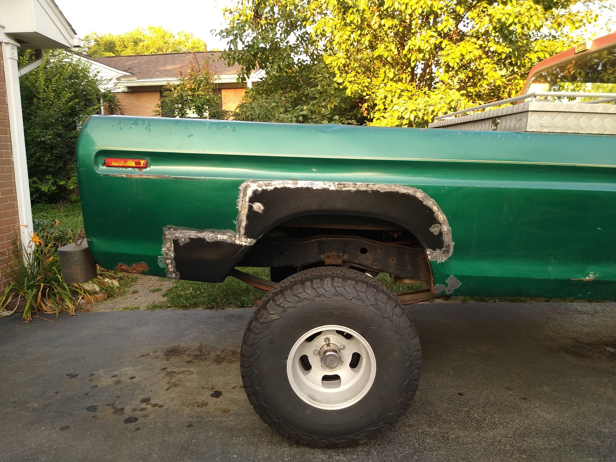

Just a recap.....this is what I started with.
Which became this.....after cutting out the rust...
Repair panels are welded in......
