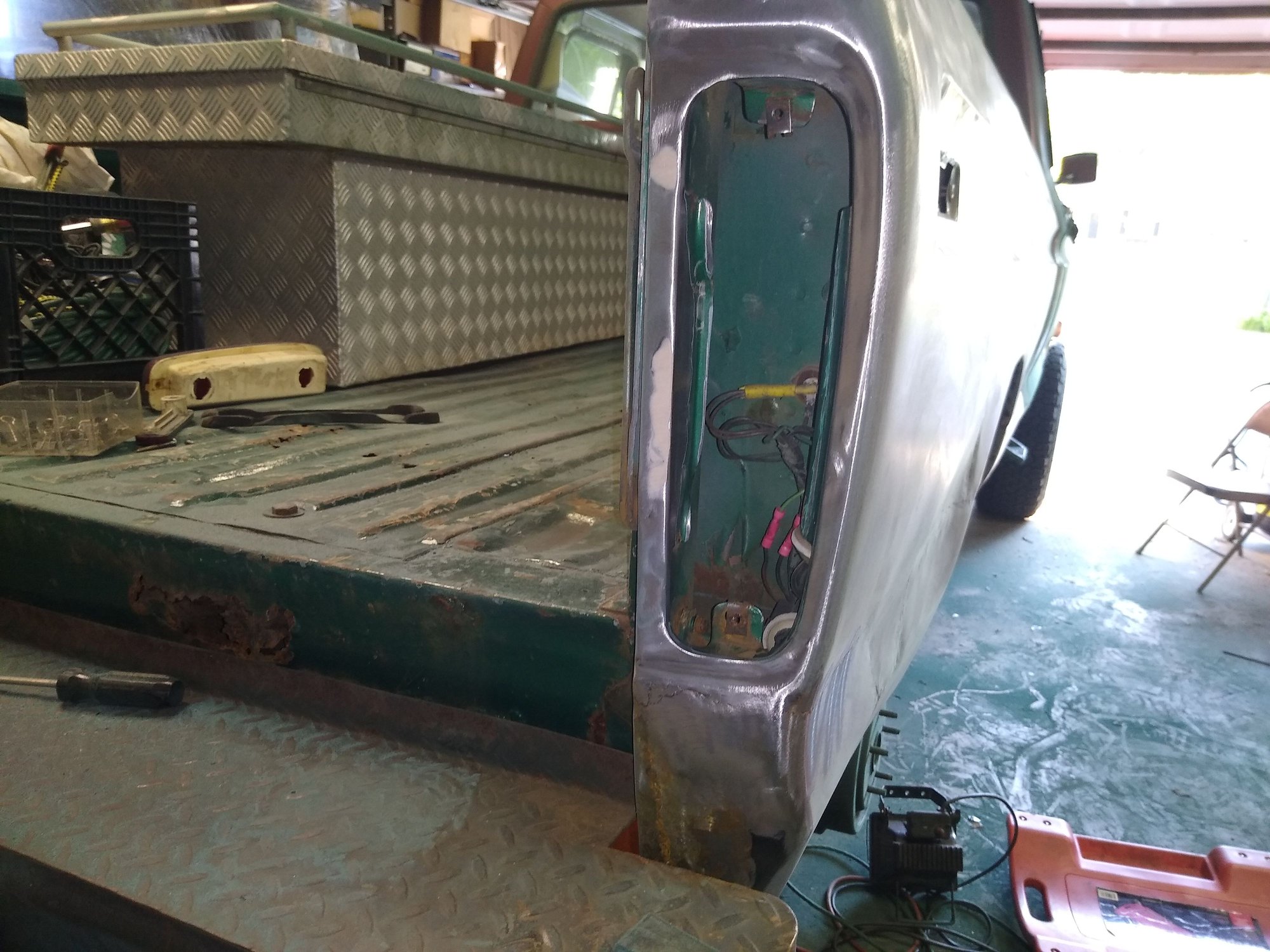

`I found a little gumption today and got started on sanding the bedsides down to bare metal. I ordered and received from Eastwood their epoxy primer, pre paint cleaner and acid etch. I will go back after I am done sanding and recheck for pinholes in my welds
Its coming along. I am using a 4" grinder from Harbor Freight, actually 2. I just switch them out when they get hot. They go about 20 minutes before I feel they need a break.
I am using
Amazon Amazon
to remove the paint. Going back over it with a 80grit disc on an orbital to make the finish more uniform.
This was the only previous body work I found other than filler where the bedsides were tacked on.
2.5 hours later and this is the result. Now I just need to find the gumption to prep and shoot it. Then the real fun begins.
