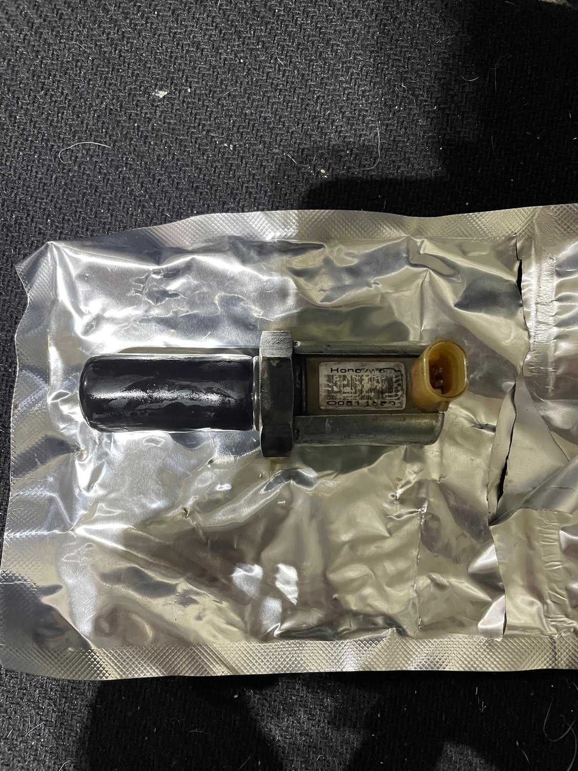

What is the high oil pressure module? Do you have a picture or part number?

I will look into that scanner thanks. It’s what they told me they replaced that cost $900. To be honest I don’t know much about diesels, this is my first one.

I can't imagine what it was unless it was the FICM (which is NOT a high oil pressure module). The FICM is the Fuel Injection Control Module and would cost about $900. It would help us help you to know what it actually was.

I can post a picture of the part they replaced.

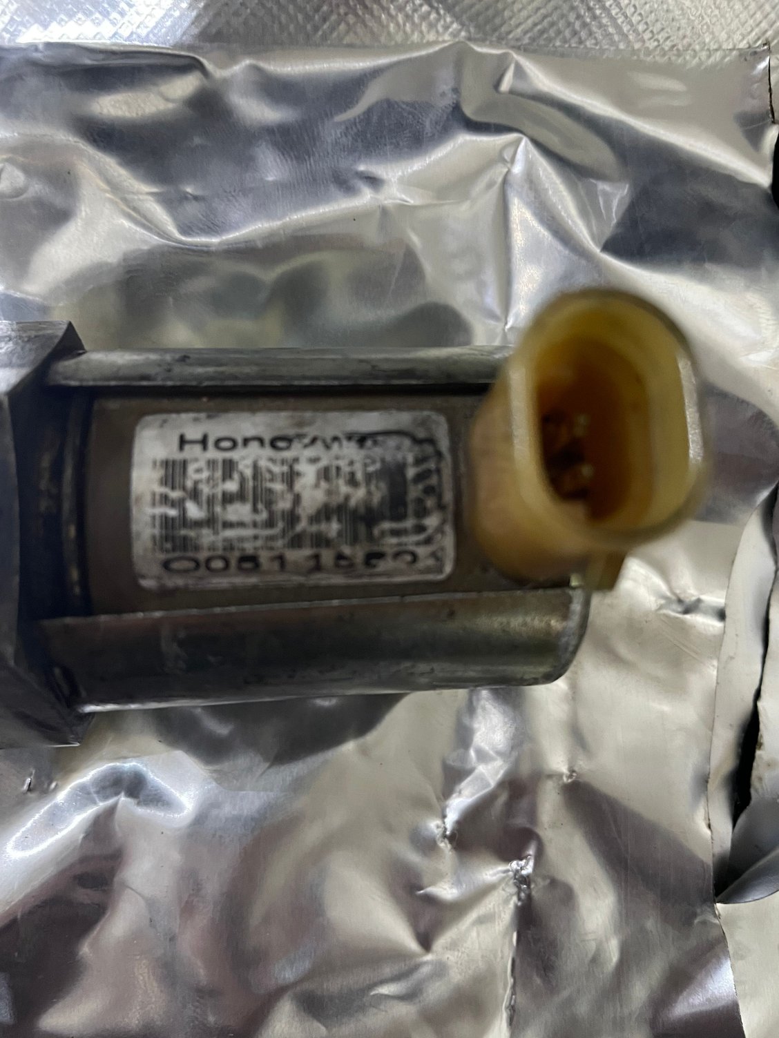

This is what they told me was the high pressure oil module that cost $900 to replace

WTH? That is not the high pressure oil pump. And doesn't look like any IPR I've ever seen. No way that cost $900, even with labor.

They are also telling me the screen is missing somewhere inside my oil system because it can easily fall off and it fell off before they replaced it. And that is why I’m having the stuttering even though it was running great before just the hard start. When I first brought it in I thought it was just the glow plugs. But everything they have done has made it worse. Now I don’t have my daily driver, and no clue what to do or how to fix this.

They said it was the module not the pump.

There's not such part as a high pressure oil module. The part that has a screen is the IPR valve, which kinda looks like that pic you attached. The screen can come off, but it's probably still in the hole - you have to get a pick or similar to get them out when they do that. It would be strange for the screen to get into the oil pan - the high pressure oil is pushing it the opposite direction.
Geezus, you should never go back to that tech again. I think he's messed up your truck. Next, he's going to tell you the fuel pump is overfilling the gas tank.
