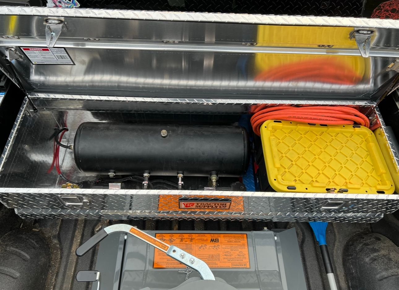

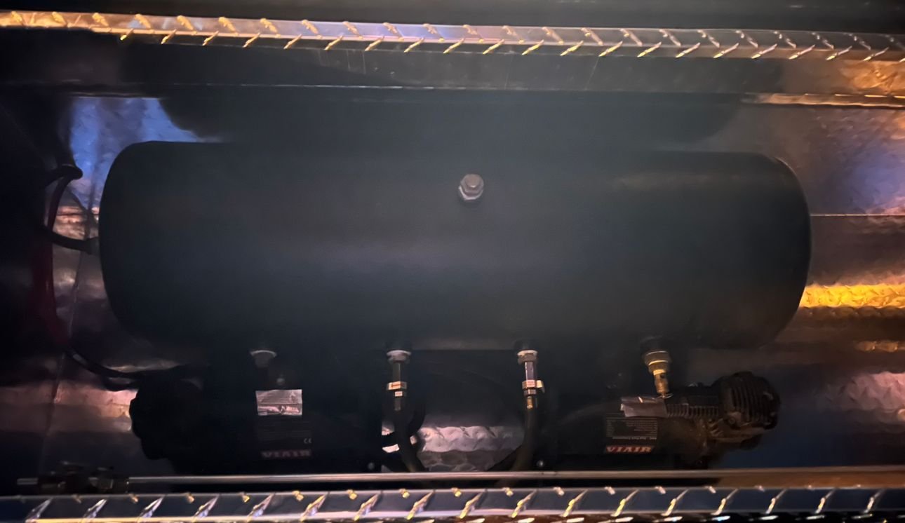

Finally got around to mounting the Viair 2.5g tank and ARB CMKA12 compressor. ]
I plan to install these myself, however, since I have an RDS fuel tank/toolbox on order, I am thinking I would put the compressor in the toolbox so it can be locked up. Then I can run the air hose back to the tank over the spare.
Since I can't bolt the compressor down into the toolbox floor, because that would mean drilling into the tank, I'll make a bracket for it to bolt to which can then be bolted into the toolbox front and rear. This will also provide additional air cooling between the compressor and the fuel tank.
Does this sound like a good or bad idea to anyone?
Since I can't bolt the compressor down into the toolbox floor because that would mean drilling into the tank, I'll make a bracket for it to bolt to which can then be bolted into the toolbox front and rear. This will also provide additional air cooling between the compressor and the fuel tank.
Not a bad idea. Honestly, I'm toyed around with the idea of even mounting the tank inside my toolbox. Since I hava the 7.3 gas it gives me plenty of space in the engine bay I can fit the compressor there, so routing a hose to the toolbox where tank will be easy. This way I can install the quick air disconnect on the toolbox and plug in hoses as needed. I dont plan to use it for air bags.

I had my compressors and tank installed in the tool box. The air connection is located by my hitch. Works great, runs my on board air and my train horns.
I m just worried that since my toolbox sits on top of the fuel tank and the compressor can get warm, there might be issues.
I've had no issues. Mine has been installed for over a year.

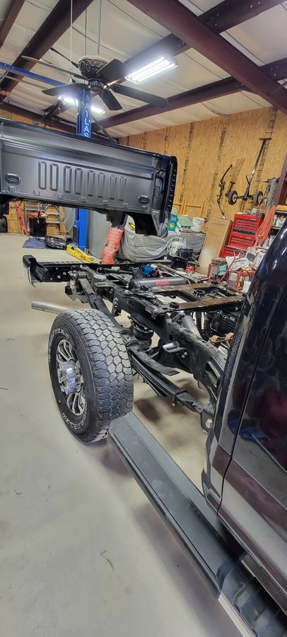

Finally got around to doing mine!!! Works awesome.
. I left a little bit of the 6 gauge wire toward end wrapped around that crossmember because I may route it to a waterproof fuse box and have a blue seas systems 12v USB and Cigarrette plug in bed of truck.

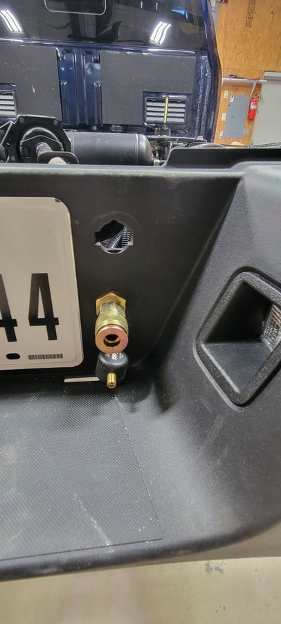

I'm going through this install now. Where did you get the coupler to convert from the 1/4 inch air hose to the quick-connect adapter that you installed on your bumper? It looks like you have some kind of threaded adapter, but I can seem to find anything like that.
Thank you!
Jeff
